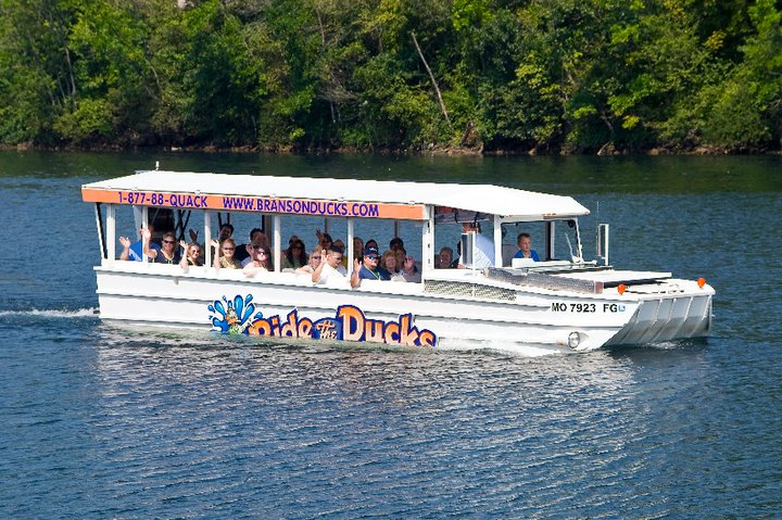

   / Duck boat tragedy "storm came out of nowhere" BS #72
Photo of a Branson duck, from: Quack Your Way Around Branson with Ride the Ducks – Branson Shows Blog

Heard an interview where a survivor said the captain told them to stay seated and not put life jackets on.
Also note that there were side curtains or windows all around so escape was near impossible.
Video also shows that there was a roof overhead.
All in all about same as being trapped under deck.
Canvas proved deadly, and we are so conditioned to not think outside the box, be situationally aware, or prepared to deal with emergencies. If only life jackets and a sharp pocket knife had been employed, there may have been needless deaths, but there likely would have been more survivors.

Think of driving an old, topless school bus down a boat ramp into a lake.... that's exactly what if feels like. Exactly.
Also, most boats have enough foam in their sidewall, under the seats, pretty much in every dead location, so that even if you fill it with water, it'll still float at or above the water surface. The original ones don't have that. Don't know about the modern ones. You fill it with water, and it sinks to the bottom very, very fast. Add a canopy on top of that, and it's a death trap if it gets swamped. As soon as it gets enough water in it that weighs more than it's displacement, down it goes. You'd have about 1 or 2 seconds from the time your body started floating off your seat to the time the canopy pressed down on you and took you to the bottom. Even if you had a life jacket on, the canopy is going to grab you and take you down.
