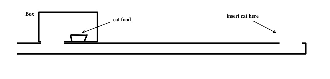

Get a long-hair cat. They work best.
Bruce

You can clean them yourself.
Bruce
dadnabbit, wifes aunt just left with the siamese, that furball would have been perfect. We have the metal ducts, i have an extension hose for the shop vac & have rigged a brush onto a 6" head, clean ours every couple years on account of dogs in the house.
Ronnie
