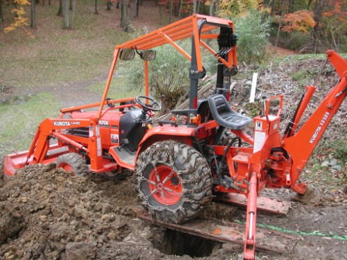

Another option might be to put something across the trench, that your rear wheels could ride on. I doubt this is practical unless you happen to have something like I did, which was a couple pieces of strong steel piling that I got a while ago...
Attached is a picture of what worked for me...the green line is the trench I was digging where a sewer line went in. The cross trench was where I dug down to find the lateral pipe that I had to connect to.
While this picture does not show exactly the same thing, it could be adapted to work on a trench that needed to be connected in the middle... /forums/images/graemlins/smile.gif

Henro makes a good point here--"the green line is the trench I was digging ." Get a few paint cans meant to spray lines on the ground. It helps a bunch to enable digging a straight line. Don't even try to dig a curve without a line on the ground.
Henro's first picture shows quite well how I was trying to describe how to back up to a trench at an angle.

I've used 4x8 sheet stock to cover up one part of the trench to permit digging straight in. That works pretty well except last week when I did this with 12mm aspenite (flakeboard). It was interesting to say the least getting off the trench. Some 3/4 inch plywood works much better.
I line up three or four 4x8s with 8 foot sides across the trench and leap-frog them as I dig and move. That is pretty secure as long as you keep the trench edges free of mounds of dirt that will cause the 4x8 to rest unevenly. The 4x8 will bend a bit but generally won't crack (except for the aspenite :shocked:) as long as your wheels aren't on the board directly over the trench. When you are in digging position the 4x8s and wheels are actually supported by the trench edges and the 4x8's effect is mainly to prevent your wheels from falling into the trench and to keep the trench walls from potentially caving in.
The only risky points to this method is moving on and off the trench and boards - thats when your back wheels and the weight of the backhoe would be supported only by the sheet stock. I generally double-up the 4x8 that will take the weight of the back wheels when moving on or off.
The pivot maneuver would be a whole lot simpler but for now I'm sticking with the boards.
