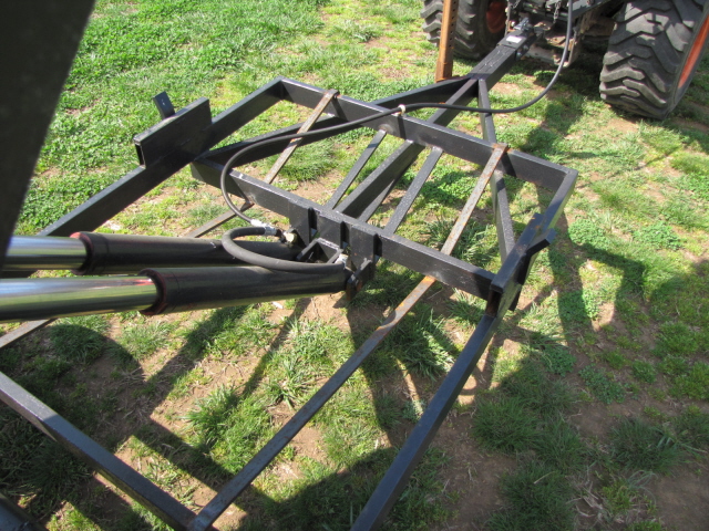

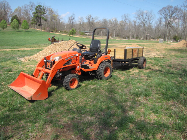

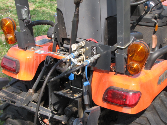

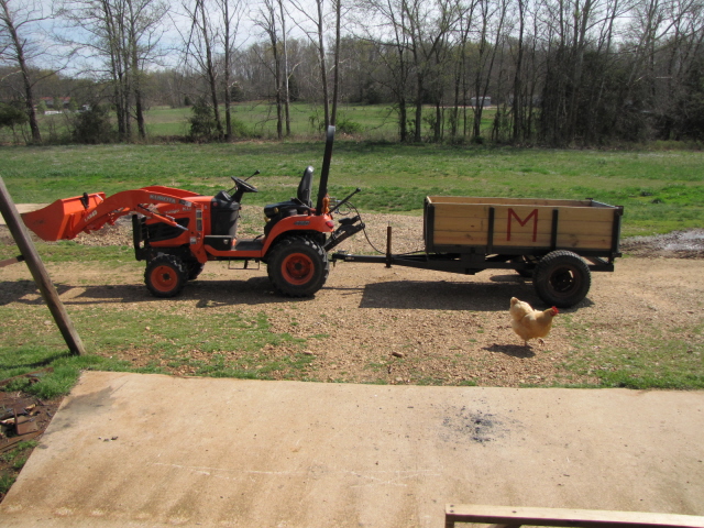

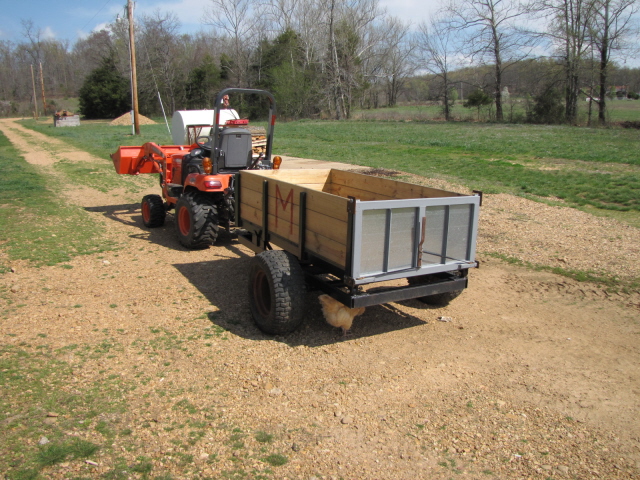

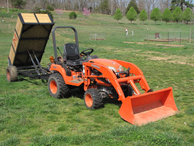

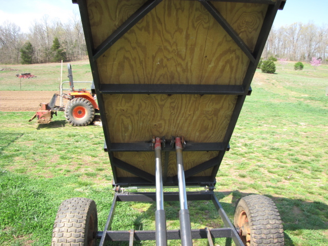

Here is what I made for my BX2660. Its 3'3" X 6'5" with 17" sides. I have had it over filled with gravel and sand, dumps good but it is all the weight I think I would want to pull with the bx. It pulled just fine, but if on hills the stopping might be trouble (haven't tried yet.)
In picyure #6 you can see where I put another draw bar up higher so the trailer would be level. The tires are the ones I'm going to use, but the off set in the wheels are way off, so I have to find different wheels.
The trailers with the wheels under bed is to high for the BX's

Leejohn, That is a great looking trailer and the perfect size for the BX. Do you have to shut the engine down to connect/disconnect the hydraulic lines? I'm asking because I plan on building a 4x8 dump trailer for my B7800. That being my only tractor I plan on diving up to material (manure, rocks, firewood, ect.) disconnect hoses, unhook, load trailer using the tractor, re-hook trailer and drive away to dump site. I hope I would be able to connect/disconnect the lines without having to shut off the engine.
