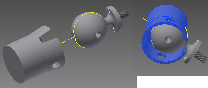

I wounder about the range of motion available in a gooseneck hitch coupler.
What are the Dimensions of the Gooseneck Coupler Head # 291300 | etrailer.com
Bruce
only gives 1 plane of freedom of X,Y,Z planes
look back at the video ya posted in another thread. between 2 to 3 minutes
Leisinger USA - YouTube
there is a physical cut out on one side.
plz ignore my petty attempts, using autodesk...
some place in the video, it is like 1 maybe 2 seconds long, of removing a plastic piece, that fits up inside, that i assume the "ball" itself rests on.
   / Dump trailer angle of the dangle #74
you might try contacting a local CNC / metal fabrication place. they may have a 3way-joint already on file. that they can load up, toss a chunk a metal into there machines, and set back and watch.
a shop / company, geared to customizing vehicles for folks, might be able to give ya a tip of were to hunt down some metal fabrication place.

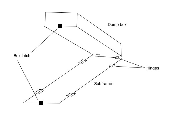

One reason I am following this thread so closely:
In the late 1950's we had on the farm a rolling chassis from a 1936 Plymouth. My plan was to make a light duty 3-way dump trailer on it. I had never seen or heard of a 3-way trailer then, so I couldn't copy a design. Here is the plan.
On top of the chassis was to be a dump-bed-sized rectangular subframe, with 4 hinges, two on each side between the subframe and chassis, pins pointing front to rear. When the two pins on either side were removed, the subframe would be able to tilt to the other side for dumping. The dump box, with tailgates on 3 sides, was mounted to this subframe as described below.
For rear dumping, there were to be 2 rear hinges like a regular dump truck or trailer. But these hinges were on the rear of the dump box and the rear of the subframe, instead of on the chassis. There would be a latch between the front of the dump box and the subframe.
The hydraulic cylinder bottom end was to be on the chassis and the top end attached to the dump box.
1. Start with everything latched and pinned
2. To side dump left, pull right pins and activate cylinder, or
3. To side dump right, pull left pins and activate cylinder, or
4. To rear dump, unlatch dump box from subframe and activate cylinder
I never did get the hydraulic cylinder worked out, and went on to other projects. I need that trailer now. :)
Bruce
