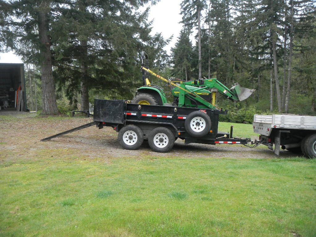

1594 views, I calculate if everyone who viewed this thread would donate $3.13 you could buy a nice dump trailer.:laughing:;)
   / Dump trailer angle of the dangle #64
I'm not that rich but I will do what I can...
Here ya go............:2cents:

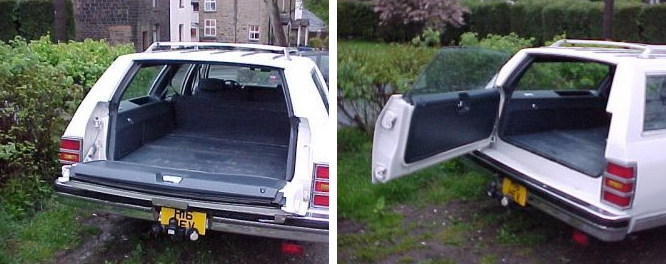

Might find an idea in how the 2-way tailgates were hinged and latched.
Bruce
