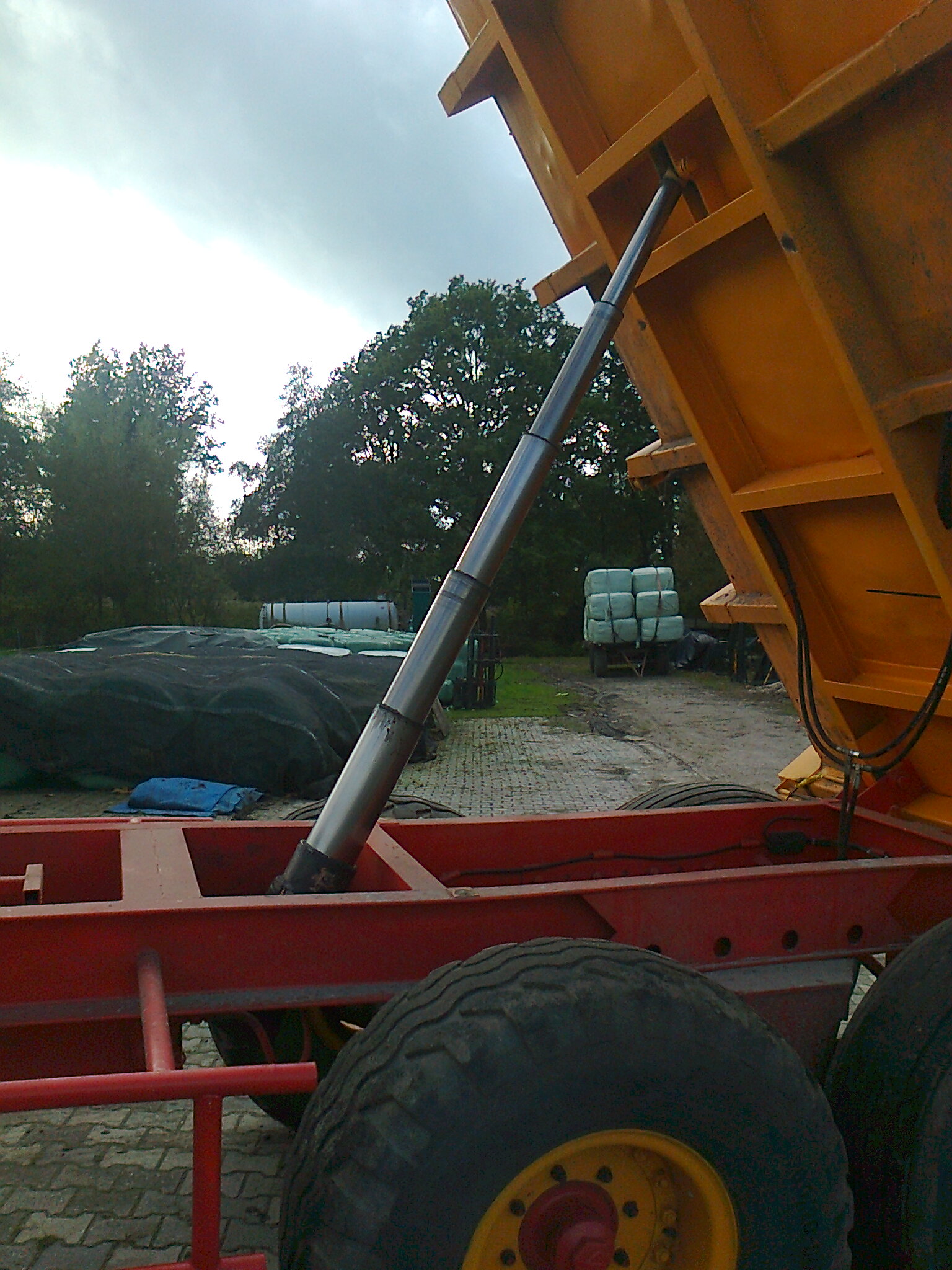

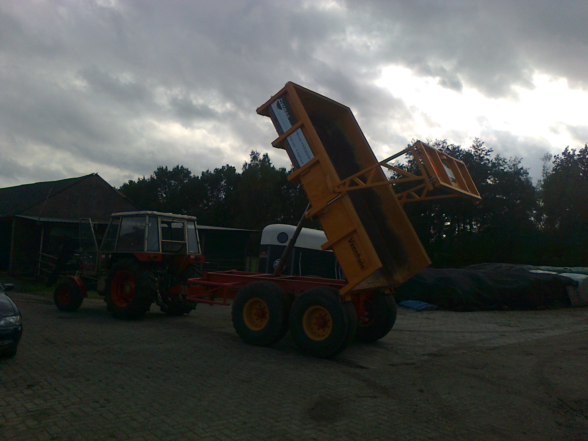

Artisan, i will take a load of sugarbeet pulp for the sheep of my landlord tomorrow with my brothers dumptrailer, and have taken some shots of the 5 stage telescopic cylinder. Its a 10 ton Veenhuis dumper of 1986 which we saved from the scrapyard last winter, realigned it after rollover damage, beefed it up, hammered most dents out of it and had it resprayed. Its on large 20/70-508 tires so my 60hp tractor has no trouble pulling it through terrain. The tailgate is made so that it can also get rid of a load of branches or treestumps without plugging, or be lifted above future silage extensions.
For the 2.5 ton drawbar load, we have a special drawbar that keeps the load closer to the rear axle, its a welded pin or knob, with a lock latch above it. the French call it a pitonfix.
Last summer we had 13 ton of topsoil on it, topping the scales with a 20t combined weight :)

Wow, I have massive trailer envy! That's a beauty! And your barnyard is paved with bricks?
Wow again.
Jim
   / Dump trailer angle of the dangle #89
Yes, 10x20x 7 or 8cm thick concrete bricks is the most common method of paving here. You dont find a lot of rocks to crush here, just river gravel (round pebbles that dont compact well) and sand, but together they make concrete instead. Since 10 or 15 years there are also H bricks that interlock, for even greater stability when you manoever on them with rigid tandems.
