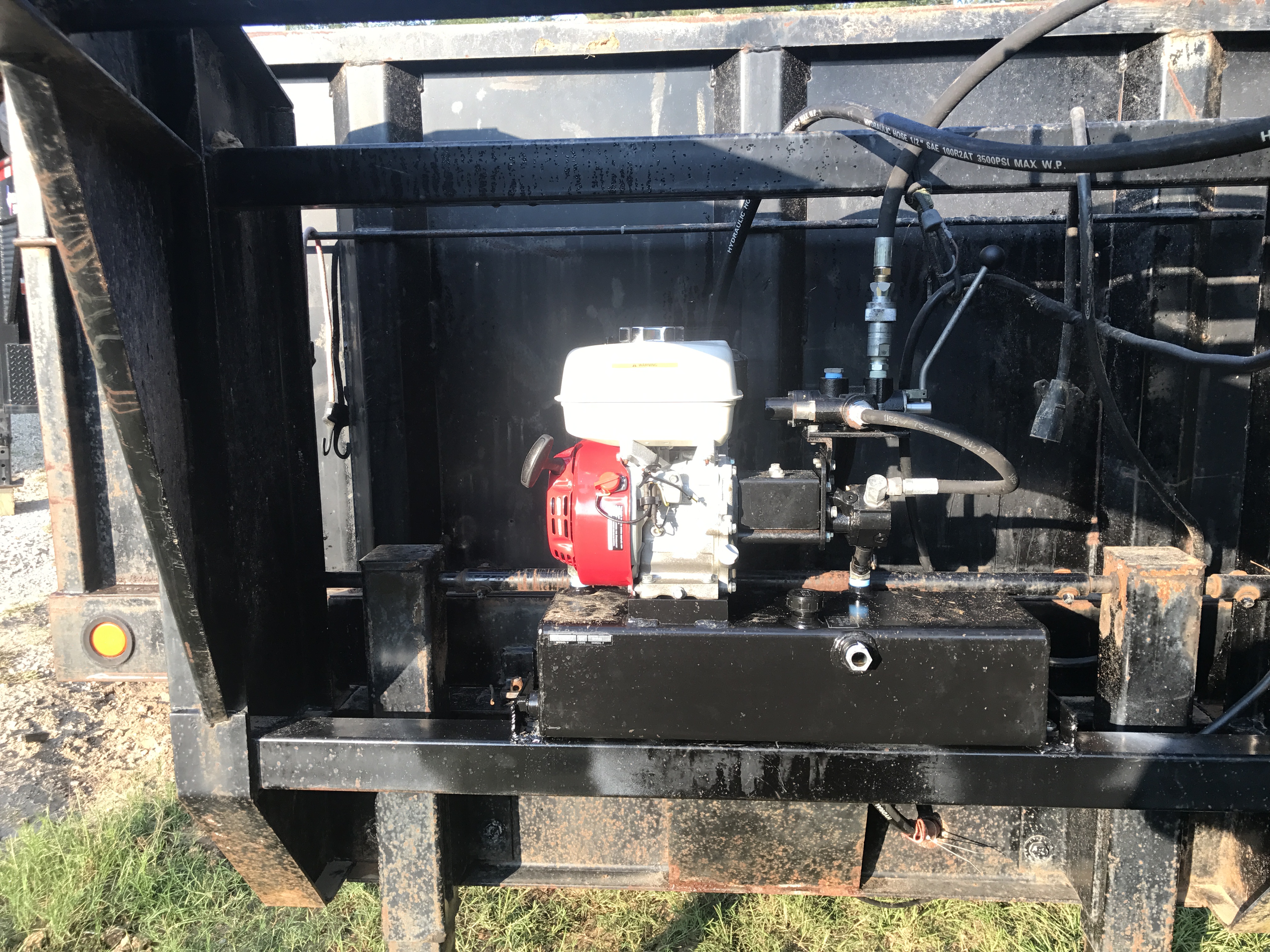

I can't keep a battery good for longer than 9 months. I've tried keeping them on trickle, leave them alone and even pulled it. I'm picking up a Honda powered pump with reservoir on Tuesday that's made for trailers. Yes it's one more motor to maintain and more gas but I'm done with the elec pump and motors. Just use the battery for the break away and I'm good. Another reason is I think my pumps going bad. Would work last time I tried it so I plumbed it to the tractor. Once I got a taste of the good life of not worrying about batteries I was sold

I usually buy blems from the corporate interstate dealer. They come out to $75 or so. This takes the really big batteries. I don't know what's killing them but I'm sick of it. I can trade them out but it's just something else to mess with. I'm hoping the gas powered pump will make life much easier and will make the pump easy to remove. Looking into adding hyd jacks on my 30k gooseneck.
Brett
The best dump trailer I've ever used had a gas motor and a 2 stage log splitter type pump. You'll be very happy. Battery powered dumps on trailers and now very common on light dump trucks for their simple installation (vs. a pto & pump) just plain suck.

Got the pump mounted and plumbing ran yesterday. Real happy with it so far. Will run all day and no batteries to worry about!
