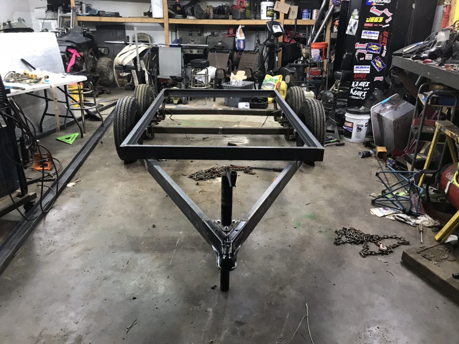

Hey everyone. I’ve followed this site for years. I have got good ideas and information from people. Figure I would post one of my projects. If anyone has any insight or sees something I could improve on please let me know.

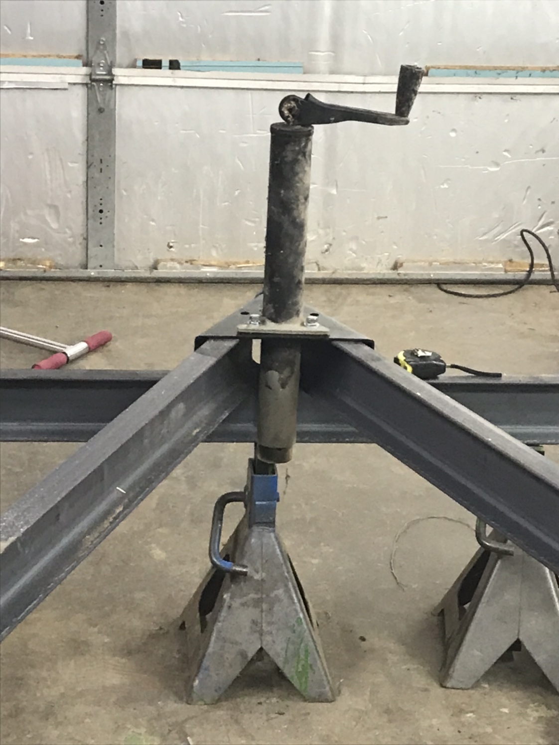

Welding a Side-mount jack onto dump trailer: https://www.tractorbynet.com/forums/welding/393120-welding-side-mount-jack-onto.html
Save your tailgate!
And it's easier to hop over the tongue.
I really LIKE this mod!

Is your c channel up to the task?
I see what you're saying.
Certainly for an empty trailer it is.
But for the case where the trailer was full - and had to be disconnected from the truck,,,, then maybe not.:shocked:
:thumbsup: Thanks for making me re-think that. :thumbsup:
I will add a 2" square tube from the jack, across to the other side C-channel.

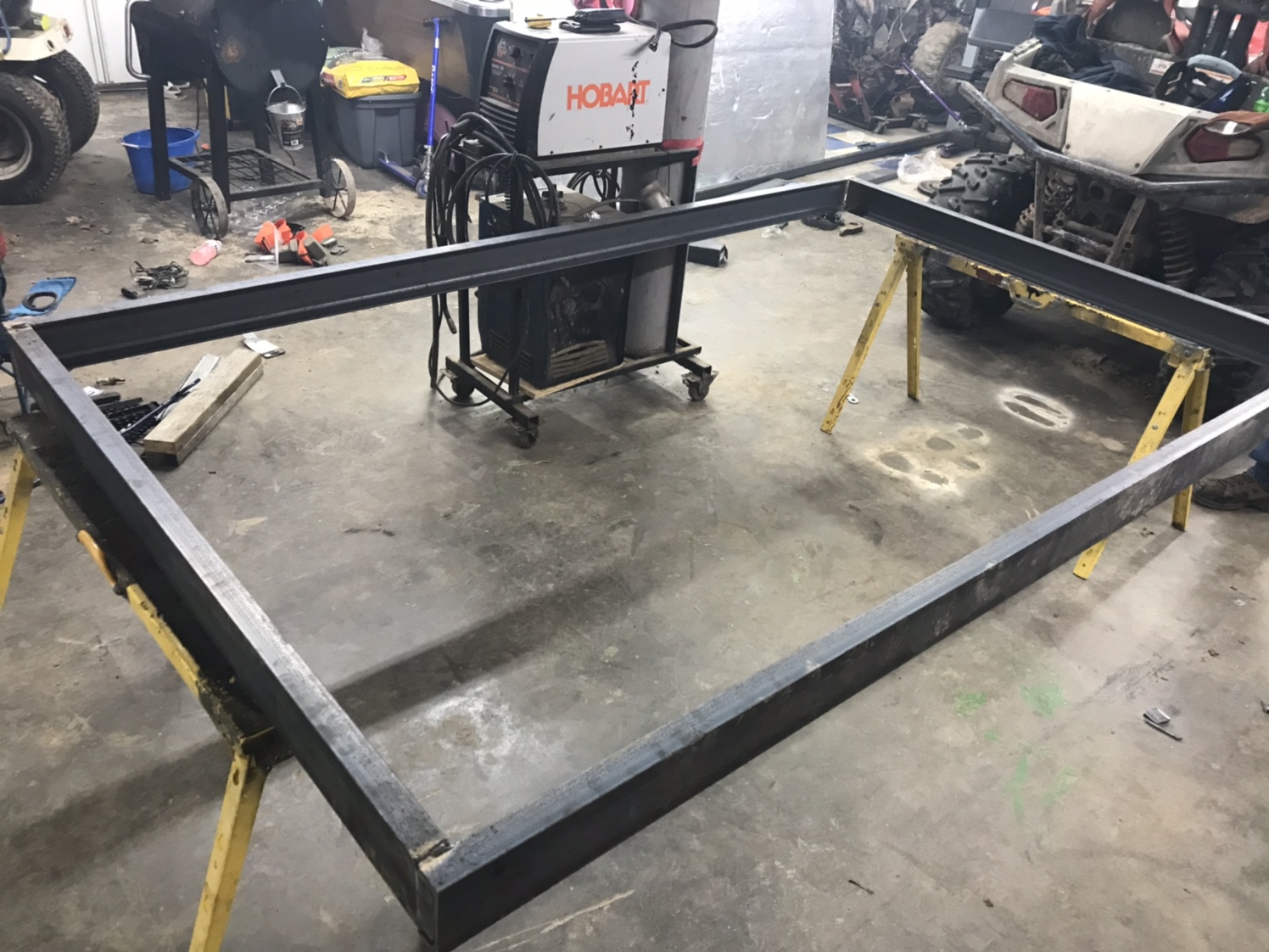

I was thinking the whole frame in general. The dump box on top will pivot at the rear of the existing frame. The forces induced will be sustantial.
/ Dump Trailer build #11
Hmmm. The main frame is a rectangular-section (2x6?) Only the tongue is C-section.

The ENTIRE frame under my 10K capacity, 6.5X10 dump trailer is 3X6 rectangular tube,,
The Rectangular tube is either 3/16 or 1/4 inch thick,,,
You know the manufacturer would not pay for tube steel,, if channel were good enough,,,

Some use tube, some C channel, and the Moritz I have is built with 8" cold formed I-beam. I think tube is very common but many complain about it rusting from the inside out especially up north. I don't know if one is better than the other if the appropriate size is used.
/ Dump Trailer build #17
Tube would offer more safety lifting the bed for the case when the wheels aren't on level ground.
Which they should be.
Often when you lift the bed off the frame, the dumpbox re-squares as it lifts off the frame and the amount of frame twist makes itself known as different left/right corner heights.
For the same trailer weight, the torsional rigidity of Rect tube is several times higher than C-section.

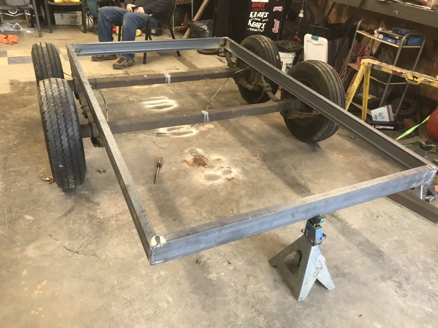

All we've seen is the rim joists though, there's certainly a lot more structure to be added.
Most efficient design is to study a commercially mfd dump trailer and copy the structure.
It would likely be an engineered unit, or at least time-tested & lawyered.

Trust me when I tell you if you want a quality trailer do not copy any manufacturers design! I have looked, measured and scrutinized about every brand dump trailer I can find and they are all made as cheap as possible. Yes, I'm sure they are "engineered" but the the very lowest possible level. For instance just look at the picture where the piston is hooked to the body, not bracing or anything.
This is why I am building my own.
For those of you who say it's not worth the time to build when you can buy that's not an entirely true statement. If you have to buy all your parts at retail you are most likely correct though. If any of you have looked at my thread and want a breakdown of costs of material I will be glad to divulge that information but I am getting my parts and steel at wholesale prices.
To the OP, the only thing I will add to your build is to build it heavier than you think it should be. Are you planning any overhang at the back of the bed or is that the pivot point? Overhang will help with tipping. It's not to late to shorten your main frame and allow for overhang on the dump bed.
