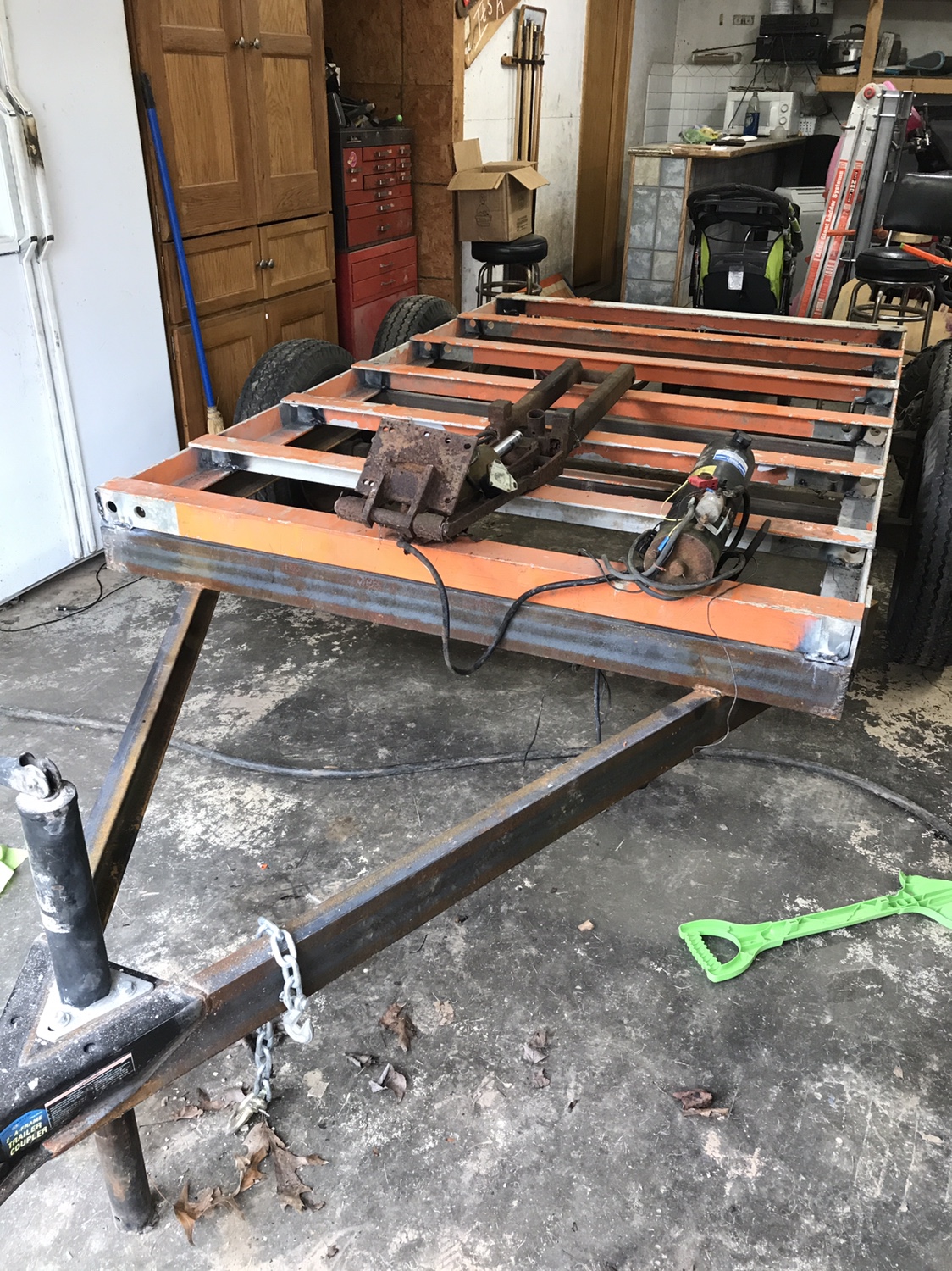

Hey everyone. Just to give a Little back story on my idea. I’m basing my idea off of a pickup I had. For awhile I had an F250 that had a under bed dump hoist from northern hydraulics. The guy I bought it from said he used to haul 2.5 to 3 ton of sand in the bed for putting in swimming pools. The hinge was at the tip of the frame on the truck. The scissor was mounted 60 in from the tip of the frame. The truck was worn out so I saved the hoist and the hydraulic unit. My plan is to build a stout little trailer that is capable of dumping 2-3 ton max. I want the trailer capable of hauling more. Knowing it will not dump it. I came across a pile of 3in angle 1/4” wall at a salvage yard. I ended up getting 14 pieces 10 ft long. I plan on cross members every 12 in for the “box”. The box will be 8x12 with 2 ft high sides. The axles and springs came from an old mobile home and cut down. The main c-channel frame will eventually get more cross members added to hopefully line up and help support the box cross members.

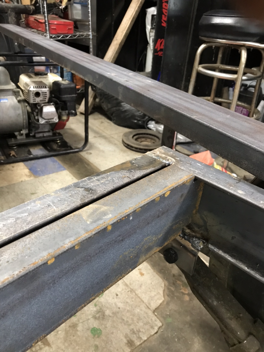

On thinking about the forces with the tip I’m doubling the channel across the back. The rear spring shackle mount is under the back corners to help support the vertical weight from the load and the added channel will hopefully add a bunch of strength to help prevent rotating and twisting when the box is dumping.

Looks like a great place to trap moisture and debris and rot from the inside there.

Finally had some time in the garage to get back on it. Cross members are cut and root welded.
