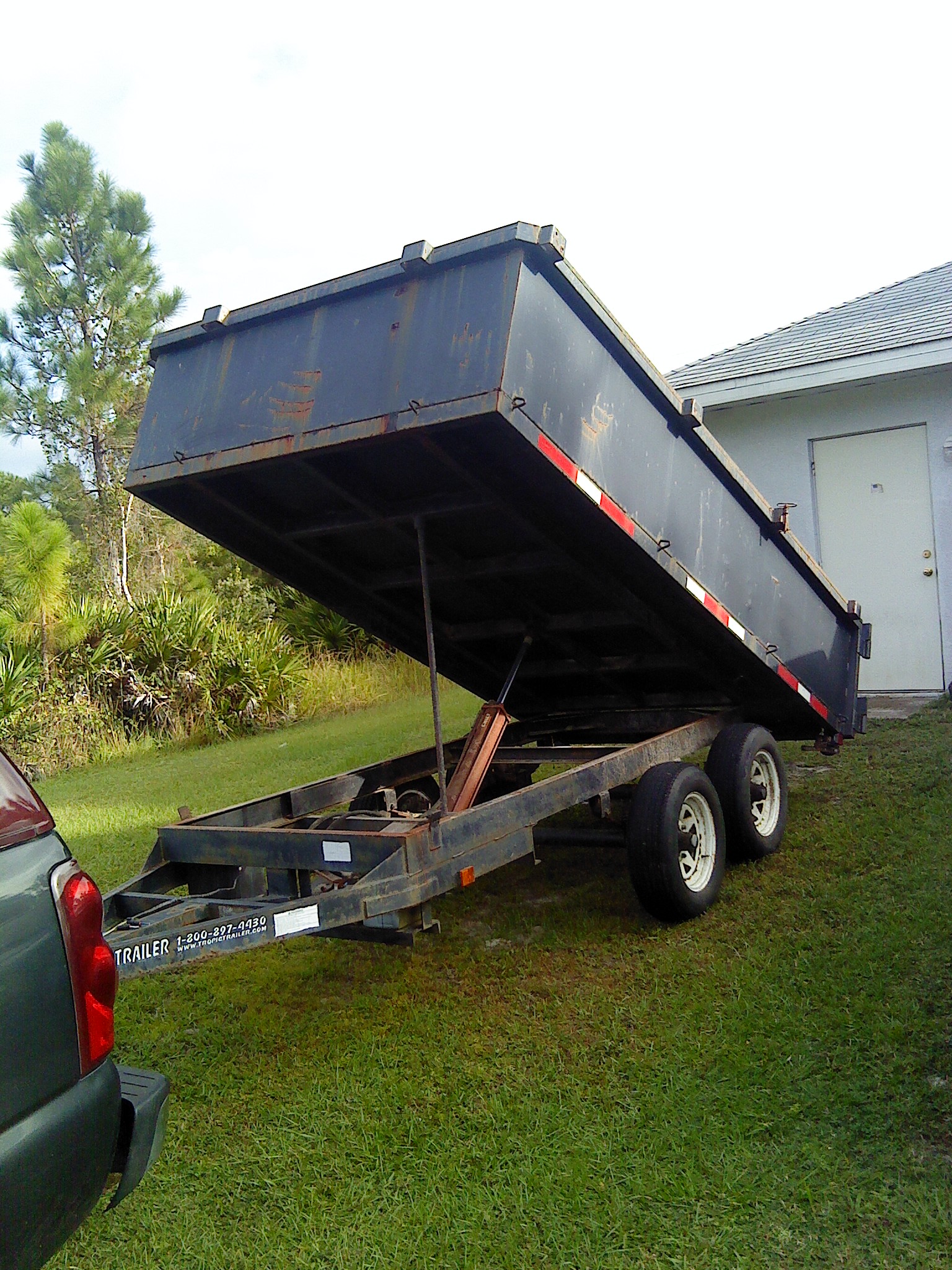

It is built light. But it has 5.2 ton axles.
That really looks like alot more than 1800# of trailer.
Curious where you came up with the number? Have you weighed it? MFG spec? or trusting what was on the title for tagging it?
Dont know of other states, but my state.....tags are based on empty weight....so lighter = cheaper. And I have seen many times people "weigh" their trailers simply by pulling the axles on the scales but never unhook from truck. This gives a lower number as it doesnt include tongue weight. But gives them a weight slip to take to BMV and get tags (falsely cheaper tags)

Wat. Thats crazy light. My neighbors 6x10 10k dual axles dump trailer weighs 2900 lbs. Only accepts 7k of payload. Color me skeptical that a 6x12, dual axle dump trailer with brakes could come in that light.
I was off slightly, 2540# by the website. (Bri-Mar)

I don't have the document with me to prove it to you. I am vacationing in my Georgia property. Paperwork is in Florida. The trailer is built light. No side wall stiffeners or fenders. Single swing rear door.
