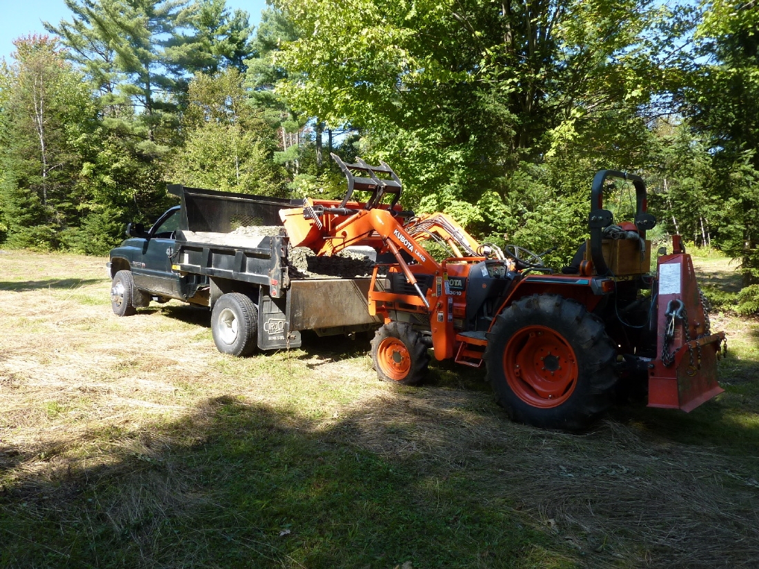

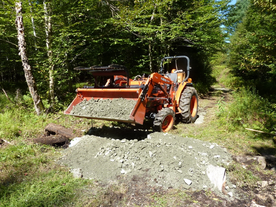

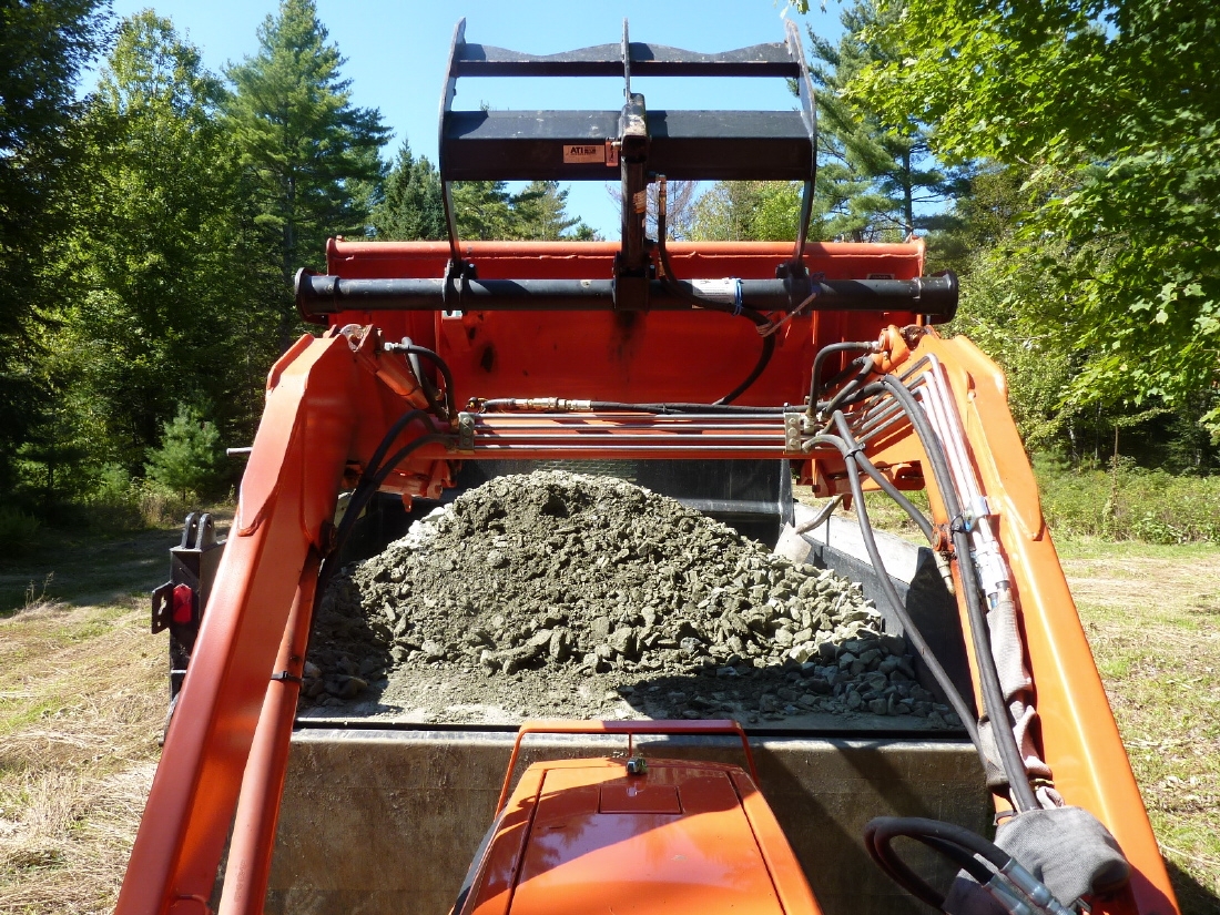

How wide is your trailer. My one-ton is 7' wide and my buckets 5' and 6' wide. I load the buck in the truck. When the pile gets to far forward to reach I close the tailgate and raise the bed go get the material back to the rear then go at it with the bucket some more. This is my 5'er on the L3010.
gg
