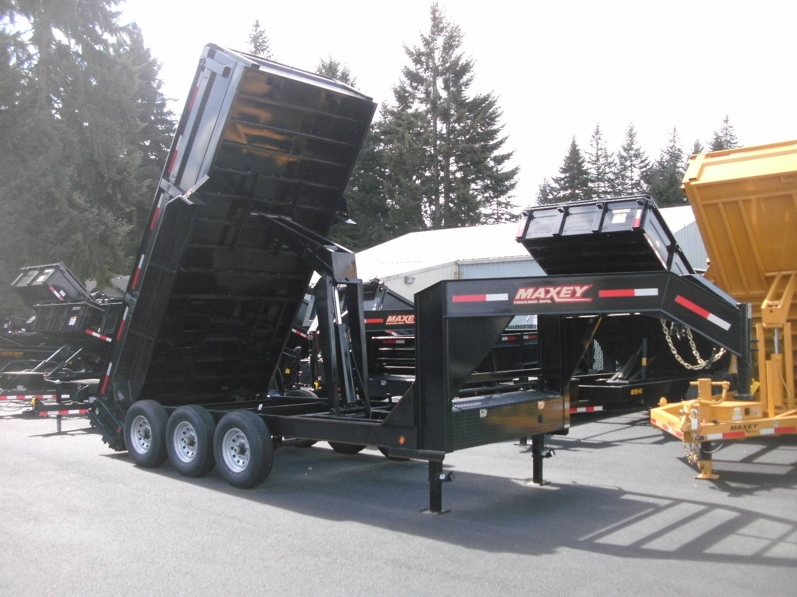

got some more info on the trailer that is being looked at to replace the dump truck-here's a pic of the model they are interested in
I was mistaken on it being a 2 axle- and will also be a gooseneck, anybody have any experience with Maxey brand?
Would have to get some kind of adapter to switch from my 5 th wheel set up, trailer has a 20,000 lb lift -thinking this is overkill and Don't want to have to get a class A license and My truck is licensed for 26000 but only rated for about a 16000lb trailer.
The rock crushing plant is only about 4 miles from our house... Once again This looks like overkill to me but I wouldn't have to outlay any of the purchase price and it does seem heavy duty.

Gees with no outlay of the purchase price and the offer to have a heavier duty than needed trailor to use sounds like a win win win deal. You only need to load it to the weight you want to haul. No need to fill the trailor with excess weight. I like the scissor style and one hydraulic cylinder style lifts a lot.
One down side is that you need to keep in mind with 3 axles and lots of weight on the trailor you need to back up in gentle arcs. That goose neck will allow you to turn way sharper than is good with lots of weight and 3 axles. Lots of stress from the tires grabbing to the bearings and lug bolts. Pavement grabs the tires as expected but tires sinking into the soil a bit and turning out of the rut your making has a lot of stress also. Just keep the turns gentle. No backing up with the gooseneck turned and hanging over the rear tires of the pickup.....

If you have the puck system installed in the bed of your truck for the fifth wheel hitch you may already have a centre hole that you can just drop a ball into for the goose neck trailer.

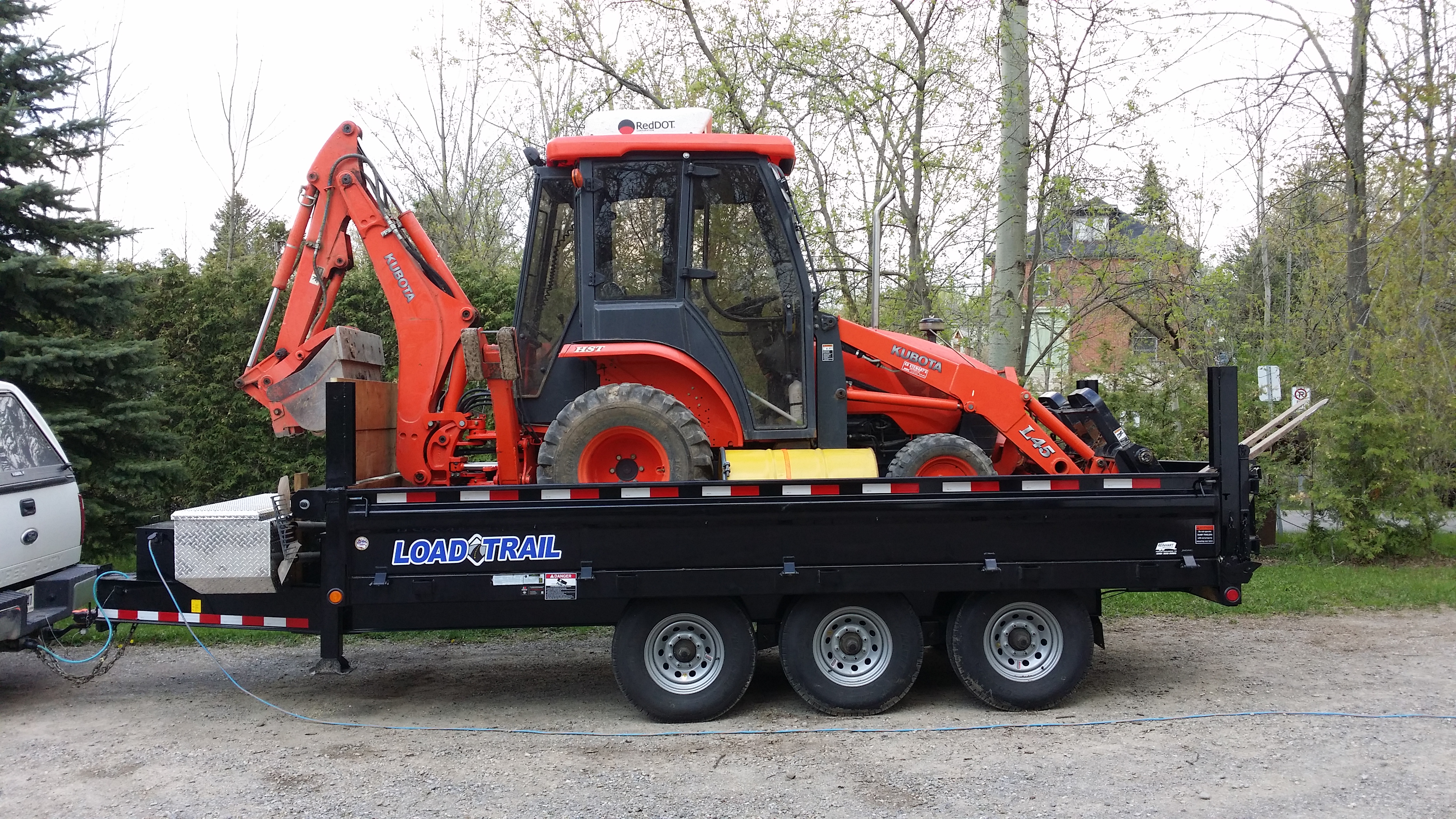

Redlands Okie has given you some great advice regarding turning. I ordered my third dump trailer as a tri-axle bumper pull because I usually have a cap on my truck and didn't want a gooseneck. I couldn't get a dual axle trailer that couldn't handle the trailer's weight and my latest Kubota tractor with accessories so I had to go to the tri-axle. You definitely want to minimize tight turns - especially on asphalt and loaded. I always do any tight maneuvering with the trailer empty and ready to pull straight out once loaded if possible.
My 2015 F350 dually with the max tow option is rated for 19,000 on the bumper hitch so that is adequate capacity for me. I have had some heavy loads of stones in this trailer and she pulls real nice so I think you will like the new trailer.
I don't know why but I couldn't attach this photo to my previous message.

Thanks for the compliments. This is my third dump trailer so I knew pretty well what I wanted. In addition to being a deckover, the sides drop down too which is really nice for securing the tractor. No more having to squeeze into a tight corner to chain her down. I don't remember what was going on when I took this picture because normally the 4in1 is at the front of the trailer with the ripper, 12" and 24" buckets in it which pushes the trailer a little further back but for some reason I just have the tractor and forks in this photo.
Having towed this load several times with my 2012 SRW F250 it towed okay but I noticed a big difference in stability when I upgraded my current 2015 F350 dually. I hesitated to get a dually for a long time because they can be a challenge to drive in snow country where I live but I find it is not too bad with good tires and 4x4 and it is just an amazing difference towing heavy compared to SRW.
