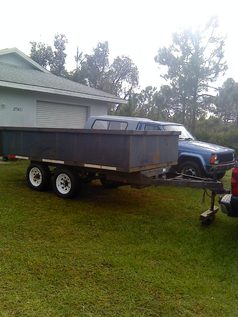

I found a used 6x12 10k. The box is above the wheels. I like it for most things I have done so far. Lawn and tree trimmings, gravel, scrap,etc..

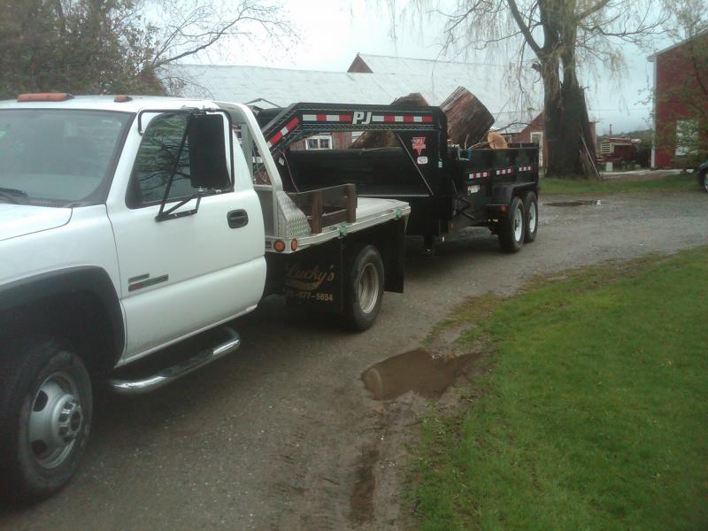

I like the larger solution because I haul manure, wood, gravel, dirt, etc...:)
