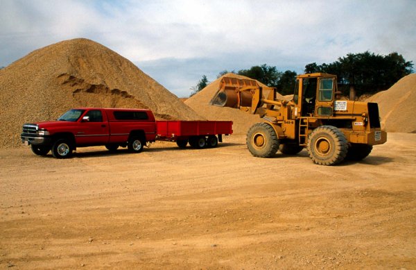

I have a Dandy dump 6x12. It was made in Tennesee.
I haul 3 yards of gravel at a time. It spreads it really nice. I originally got it to put in a gravel road to my cabin. It was too wooded to get a big truck in there. Since then I have found many uses for it. I pull it with my tractor when I am cleaning up trees. One of the best toys, uh tools, I own. You'll never regret buying one.
