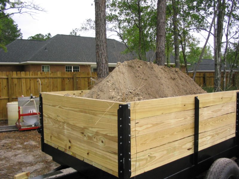

Finally my 5x10x2' dump trailer it is almost finished. I still need to make tailgate for it. The dump is acomplished by two 24" stroke 2.5 dia cylinders, powered by 2015 machindra hyd. In many ways the trailer the same as Nat's. Thanks NAT for sharing.
Test drove it yesterday, here some pictures.
