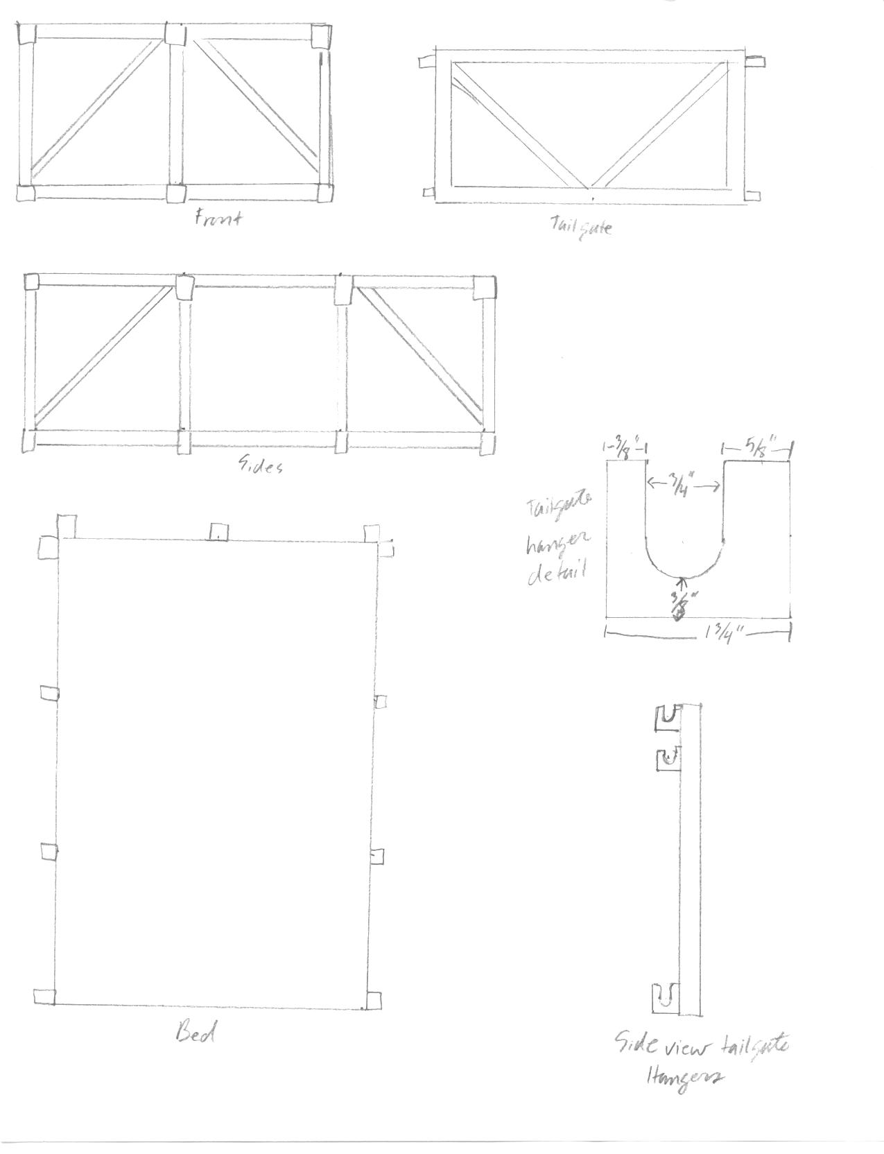

I made some more progress today. I've attached a few pictures of the decking I did today.
Pic 1 shows that the wood all started as a crate. (I'd posted this pic before, but it's relevant here again.)
Pics 2 through 4 show some different shots of the decking and the front.
I've got some more wood prepared to plane down and cut out for the sides and the back, but that will have to wait until next time.
I'm having a hard time deciding whether to paint the wood black to match the rest of the trailer or to leave it natural with some kind of varnish on it. Any input here would be welcome.
