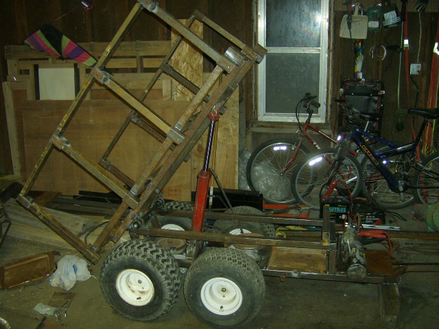

I was looking around the net to compare pictures of dump trailers to decide if I want to paint the wood or stain it.
I found this...
Now I have to go back to square one and re-design and re-build the whole thing. ;)
