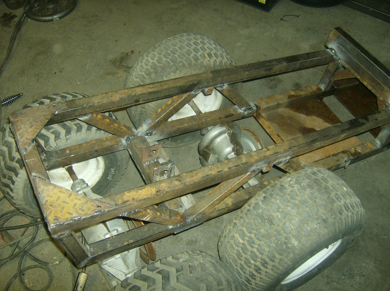

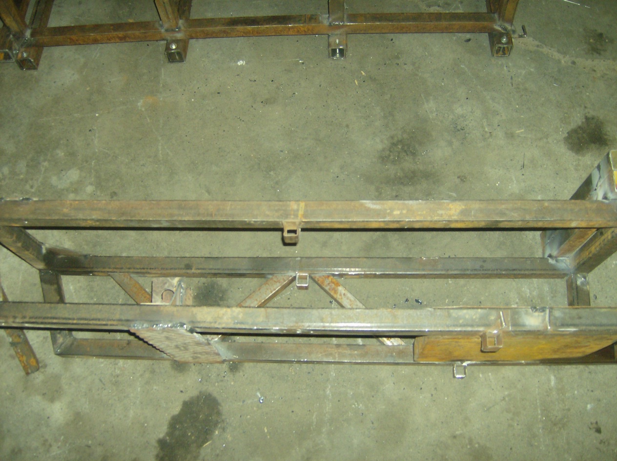

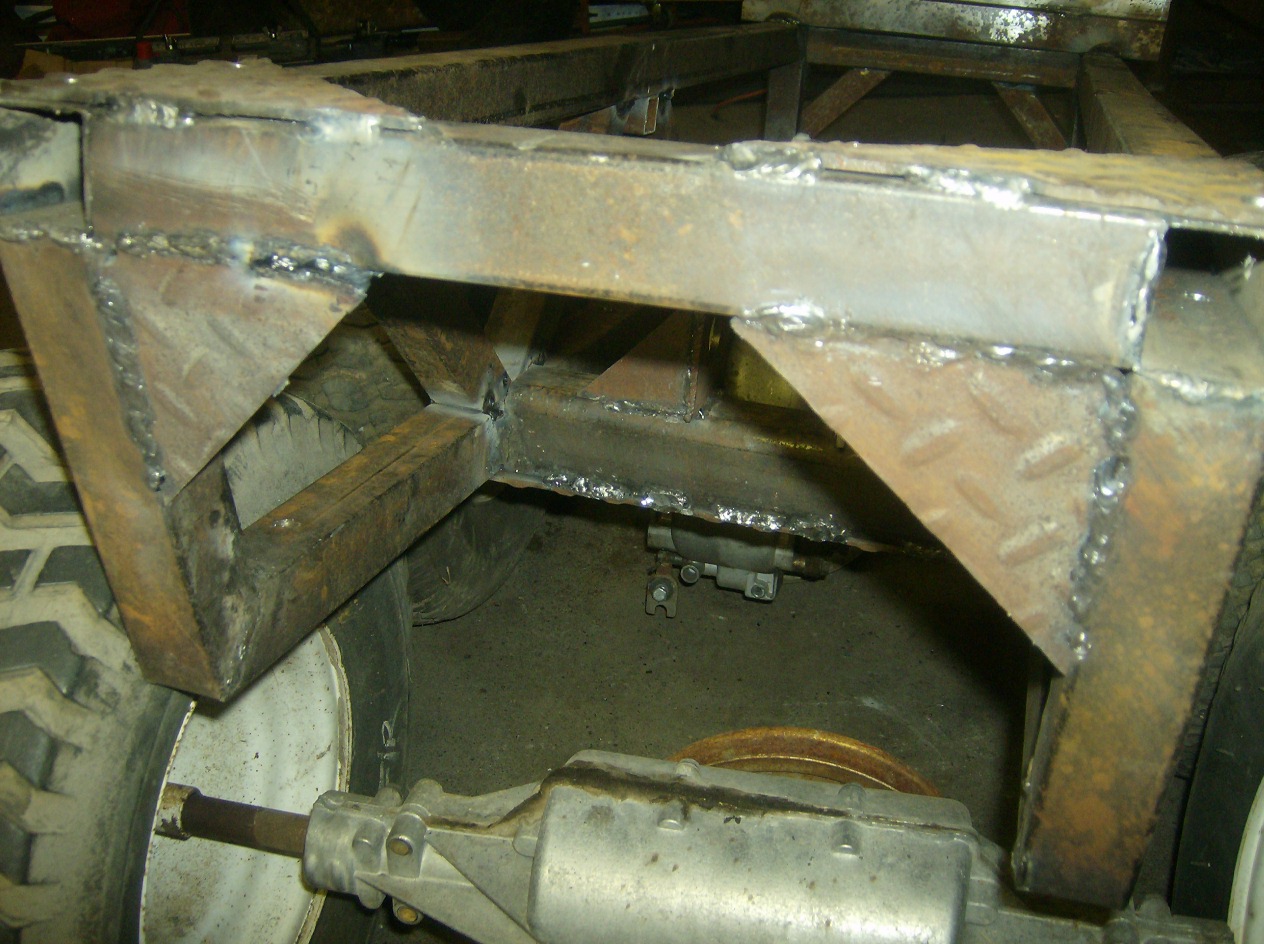

I'm posting some pics of progress I made last night.
I put some angle braces into the subframe.
I had some braces all cut out to weld accross the subframe from side to side, but as I was getting ready to put them in place I realized that there was no place to put them that wouldn't interfere with the axles or the ram. So, I cut some triangles out of diamond plate and put them on the back to stiffen it up a bit.
The last picture is just one of the whole thing done for the night.

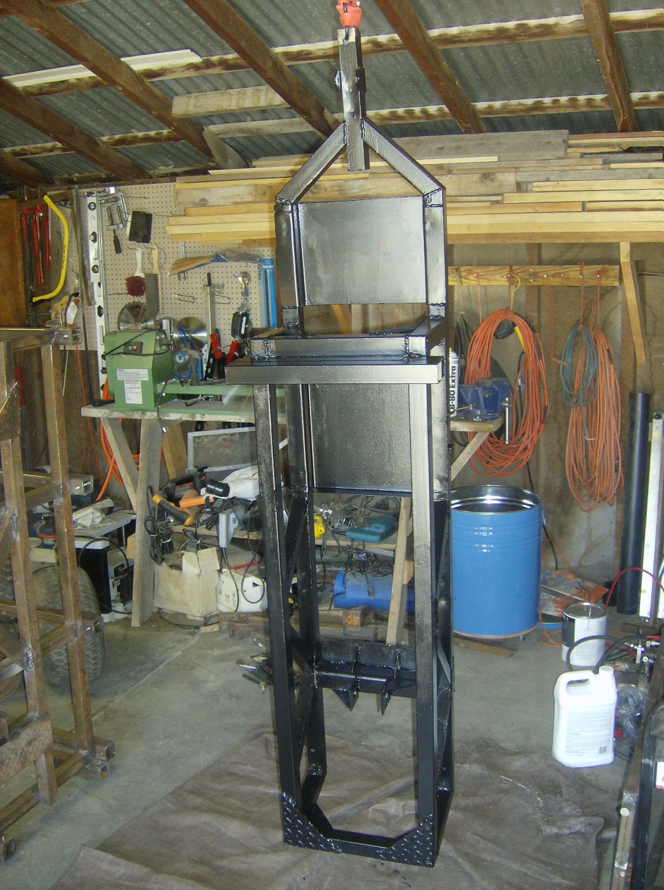

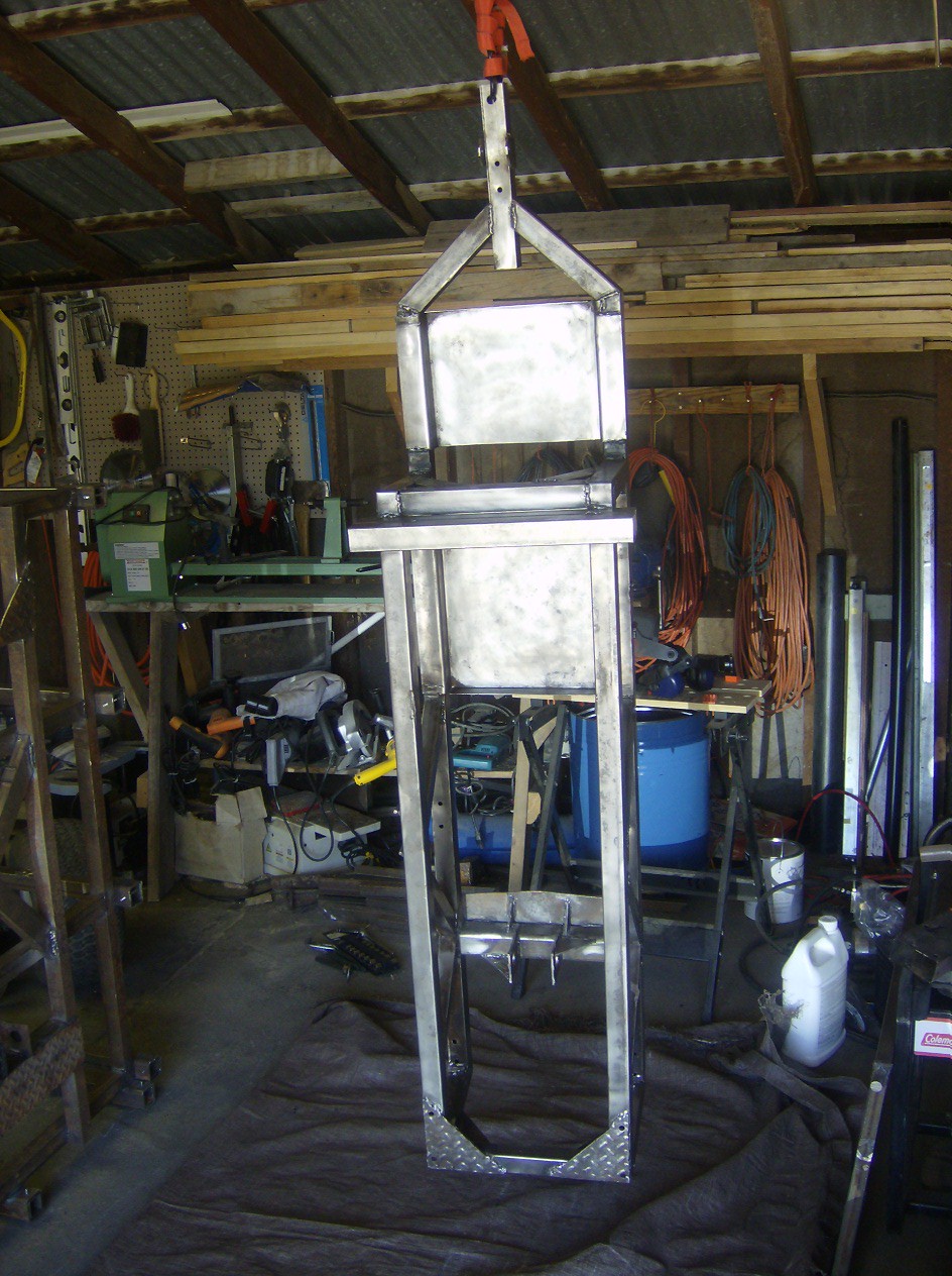

I spent quite a bit of time prepping this morning. I wire brushed the whole subframe, then I went over it with a rag wetted with paint thinner. We let the paint thinner all dry while we ate lunch and then painted.
I hung the subframe to paint it. It was nice because I could get to everything at once, but it tended to swing and spin. It made for some fun painting at times.
The paint is a Columbia product. It's called "Industrial Coatings, Acrylic DTM Polyurethane". I chose a semi gloss black premix, once again on the advice of the lady at the store. She said that a pre-mix would go on smoother.
The paint went on pretty smooth. It went on a lot easier with the roller than with the brush. I found that I had to keep the roller pretty wet too. It seems like it will be a pretty good finish though. It went on pretty thick, and the can pitches that it's a "Plastic-like Coating". I guess the real proof comes in ten years when the paint is still holding.
With it being water based, I invited my six-year-old to come help me. She took the brush to do the niches where the roller wouldn't fit. You can tell where she could reach and where she couldn't. There are quite a few drips on the bottom half of the subframe.
The nice thing about having her help was that at the end she had paint all over her fingers and decided to "paint" inside all of the bolt holes for mounting the bearings. I wouldn't have had a way to paint these holes without her little fingers.

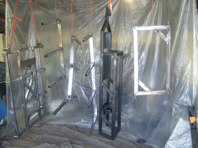

I hung the rest of the peices and sprayed them.
Spraying is way better!
I think I did use more paint, but it was a lot easier, and a lot faster.
Pic 1 below is of the pieces prepped and ready to paint. I used a flap wheel on most of the metal this morning. I used a wire brush to get into some of the corners and hard to reach areas.
Pic 2 is of the pieces after the first go round of painting. I painted them as shown, and waited the requisite 4 hours for a recoat. Then I flipped the pieces all over to get at the surfaces that were on the undersides.
The can says to to wait 7 days before washing, so I'm going to leave the pieces hanging as long as I can.
