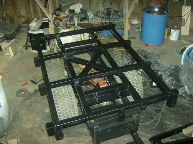

Just a quick update...
I went to put the axles back on the subframe and found that by adding the angle pieces and by straightening the rear hydraulic ram bracket, neither axle fits as is. I took the pulley off the front axle, and it fits now. The rear axle had a bigger gear box, and the gear box now bumps against the ram bracket such that the holes don't line up.
I decided to take the axle out of my old MTD mower that matches the front axle of the dump trailer. Not only will the matching axle fit better now and keep the trailer more level, but the trailer will look better too now that the tire tread patterns will be the same.
The other effect of this operation is that by putting the axle with the gear box back into the MTD mower that already has a variable drive pulley in it, I'll really have some options for speed on that mower. I figure I should be able to do about 25 mph in it if I set both the pulley and the axle in high gear.
   / Dump Trailer
#185
Another Update. No pictures, sorry. I can't find the camera after our camping trip this past weekend. It will turn up somewhere.
I've got some momentum going on this now. I went to attach the axles and realized that in the process of adding all of the angle supports and cleaning up the welds on the lower ram bracket, I had distorted the subframe by about 1/2". I had to re-drill two holes for the back axle.
I now have the two axles attached (hopefully permanently). I've bolted the bearings in place both on the subframe and on the dump bed for the dump hinge. I also installed the ram and put the dump bed on. When I put the dump bed on I left the bolts for the bearings a little loose. I wriggled the dump bed until it was straight with the subframe and then tightened up all the bearing bolts.
I'm moving the pump back under the bed. This will move the center of gravity of the empty trailer closer to the axles and it will get the pump under cover to protect it a little from the weather. Once I get the pump all installed, I'm going to measure and order some shorter hoses. The ones I have right now are about ten feet long. The new hoses will probably only be about 3 feet long.
Next step: Wood! I'm to the point that I'm going to start cutting wood for the deck and sides.
   / Dump Trailer
#186
I told you the camera would turn up somewhere. It was in the bottom cubby pocket of the passenger's side door on the truck. "Oh yeah!" says my wife when she hears that's where it is. "I took it out of the backpack baby carrier and put it there after we got back from the hike."
I snapped a picture of the current status of the cart. I'm leaving the sides off for now until I get the deck put on. Then I'll put the sides on and put wood on the sides and tailgate.
Notice the new matching tires all the way around. You can compare with some pictures from early on in the project and compliment me on how much better it looks now ;).
I was really wishing I had the cart finished this evening as I was picking pumpkins and squash. I missed the first frost and didn't cover the garden. Now we have to let everything ripen indoors. 13 large pumpkins and 4 or five dozen squash make a few trips with a wheelbarrow.

   / Dump Trailer #187
Great picture! Nice stout little trailer! What did your dump angle end up being? You had frost already? Signs of fall.... Being from New England, we are spoiled in Virginia with the longer growing season.
