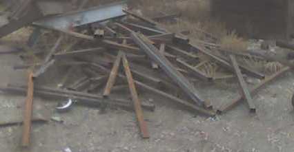

So, I just got back from the scrap yard. I won't say I found the mother load, but I was pretty pleased with the selection. There was a bunch of 2" square tubing in 4 ft. lengths (pictured) and most of a sheet of diamond plate.
Back to design, though...
I looked up some garden carts that pull behind these lawn tractors, and the biggest one I found is about 20 cu. ft. I'll probably stick to that size. In addition to that I realized that my four foot width has to include the wheels. I'll probably go with something close to 3 feet by 4 feet by 18 inches.
As for wheels, I saw this design for a four wheeled cart.
http://www.towattachments.com/71-29747.wmv
This design would still put a load on the little garden tractor, but I wouldn't have to come up with a steering mechanism.
