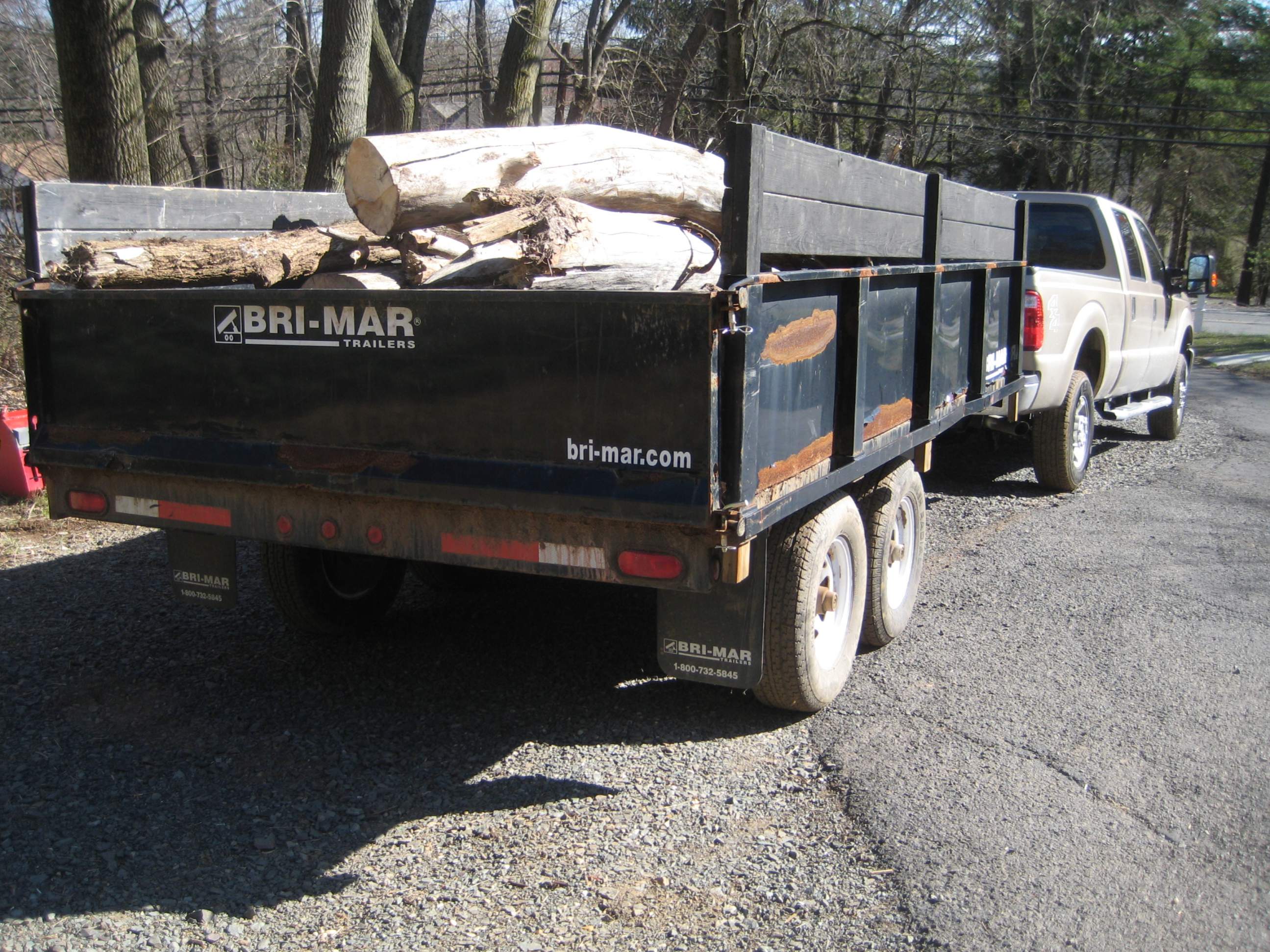

My dump trailer is a 2003 Bri-mar 7 x 12 10k that I bought brand new( ordered from dealer). It is a deck over model which allows you to remove the sides and tailgate to use as a flatbed as well. This trailer is very versatile and probably one of the best things I have ever purchased, cost me $3900. I bought this trailer cause when my wife and i bought our house (a fixerupper) on 2 overgrown acres in 2001, I knew i had many a project ahead. After 9 years the trailer is in need of a good sandblasting, new primer and paint and new tires( still running the originals) but it doesn't owe me a dime. I can't tell you how many loads of branches, trees, stumps, crushed stone, firewood, road millings, top soil, trash and construction debris, retaining wall block, lumber and furniture this thing has moved. Buy one you wont regret it.
