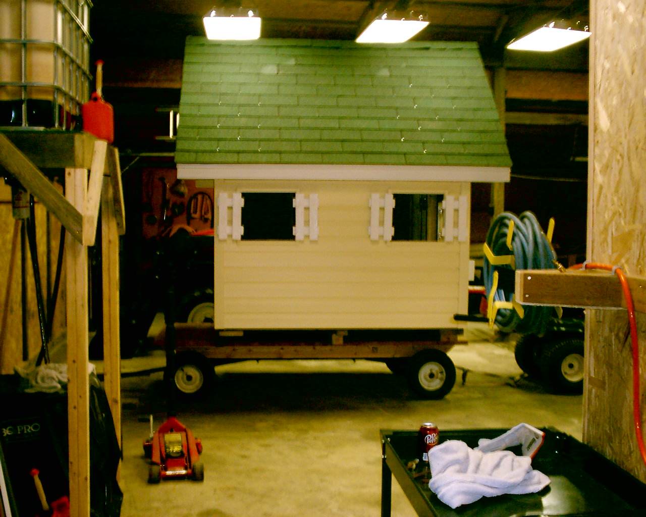

I have the 8' Hay Wagon style Model 7300. I did not put the sides on it. I got it from Harbor Freight. Its good for 2,000# but I have had much more than that on it. I once had 40 60# bags of sac-crete on it and it did fine with the tires at 35psi. I also can stack and pull a full cord of fire wood on it.
Here is one of the jobs it did a few years ago.
Chris

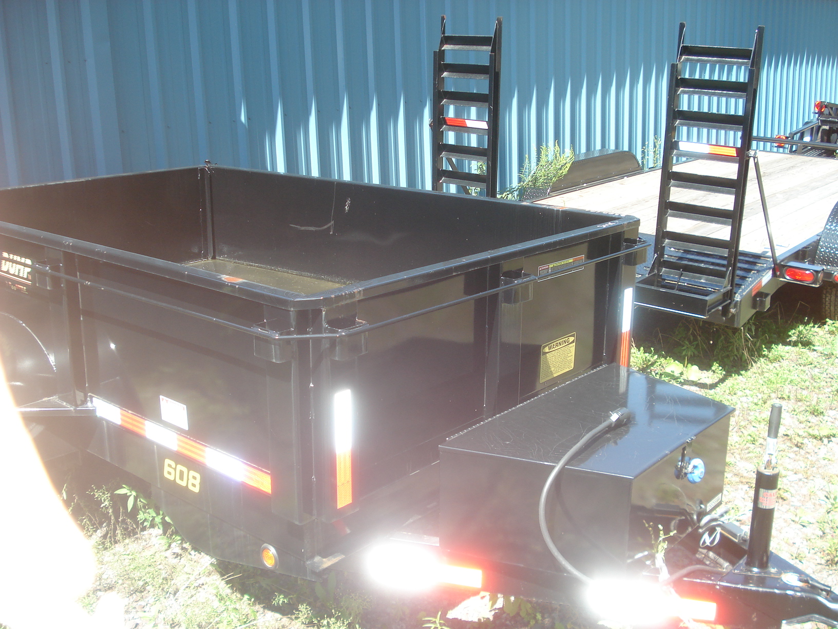

I have 2 of these 2008 DooLittle dump trailers left and I will be selling them for $2,999
You will get benifits of being able to run them on the road and yet they are small enought to get around your yard behind a tractor.
They have their own hydraulics.
They are 6x8 3,500 lbs with brakes
