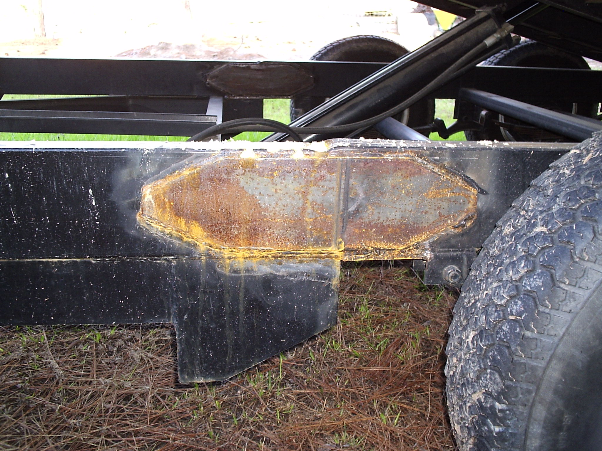

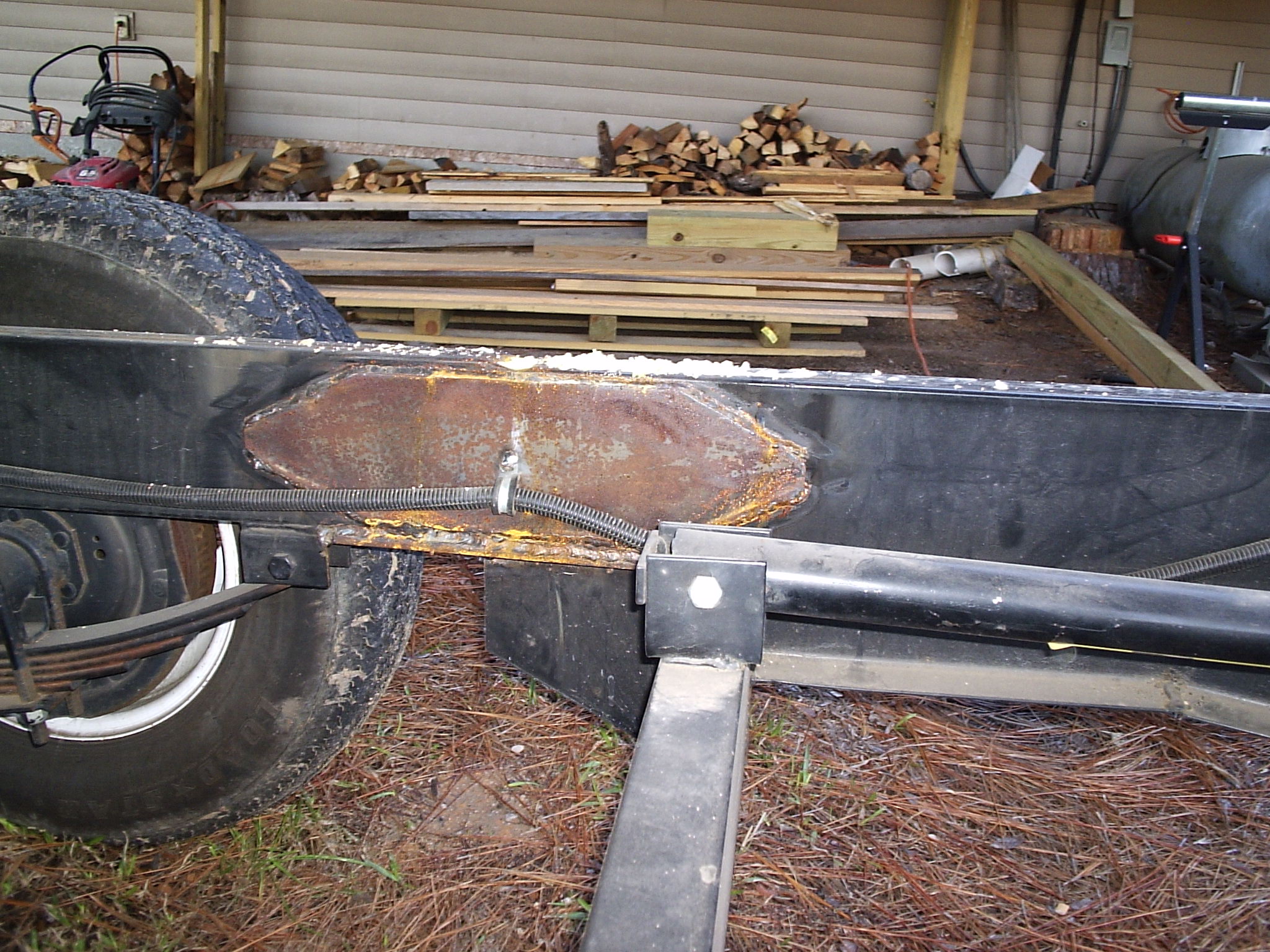

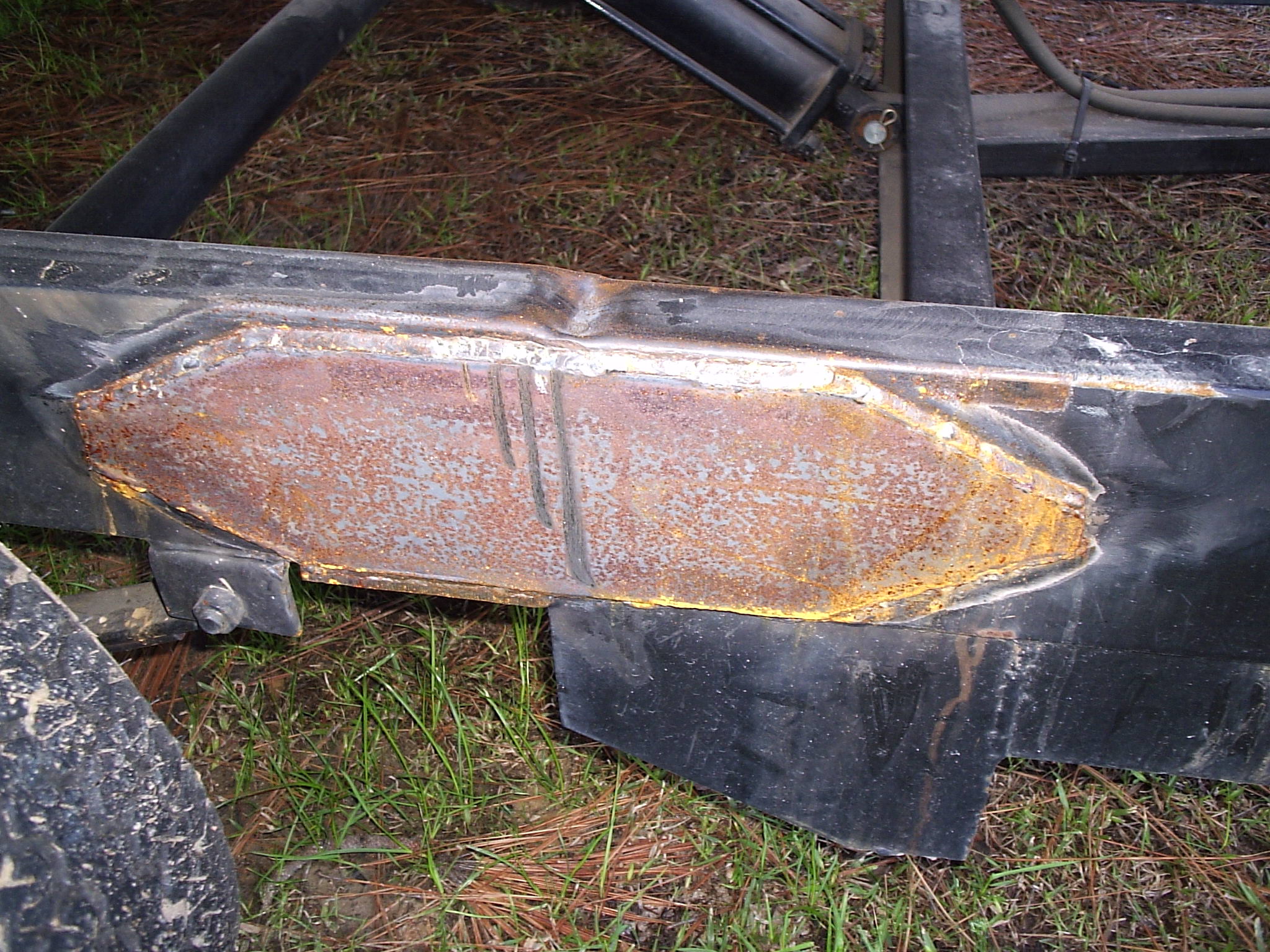

Wish I had taken pics of the broken frame but heres after the repairs. I dont think I have really overloaded it or abused it enough to have caused this but...:confused3:
When the fame cracked, was it cracked on the bottom, causing the top to buckle inward? Also, from the pictures, it appears that the frame is constructed from box tubing, correct?

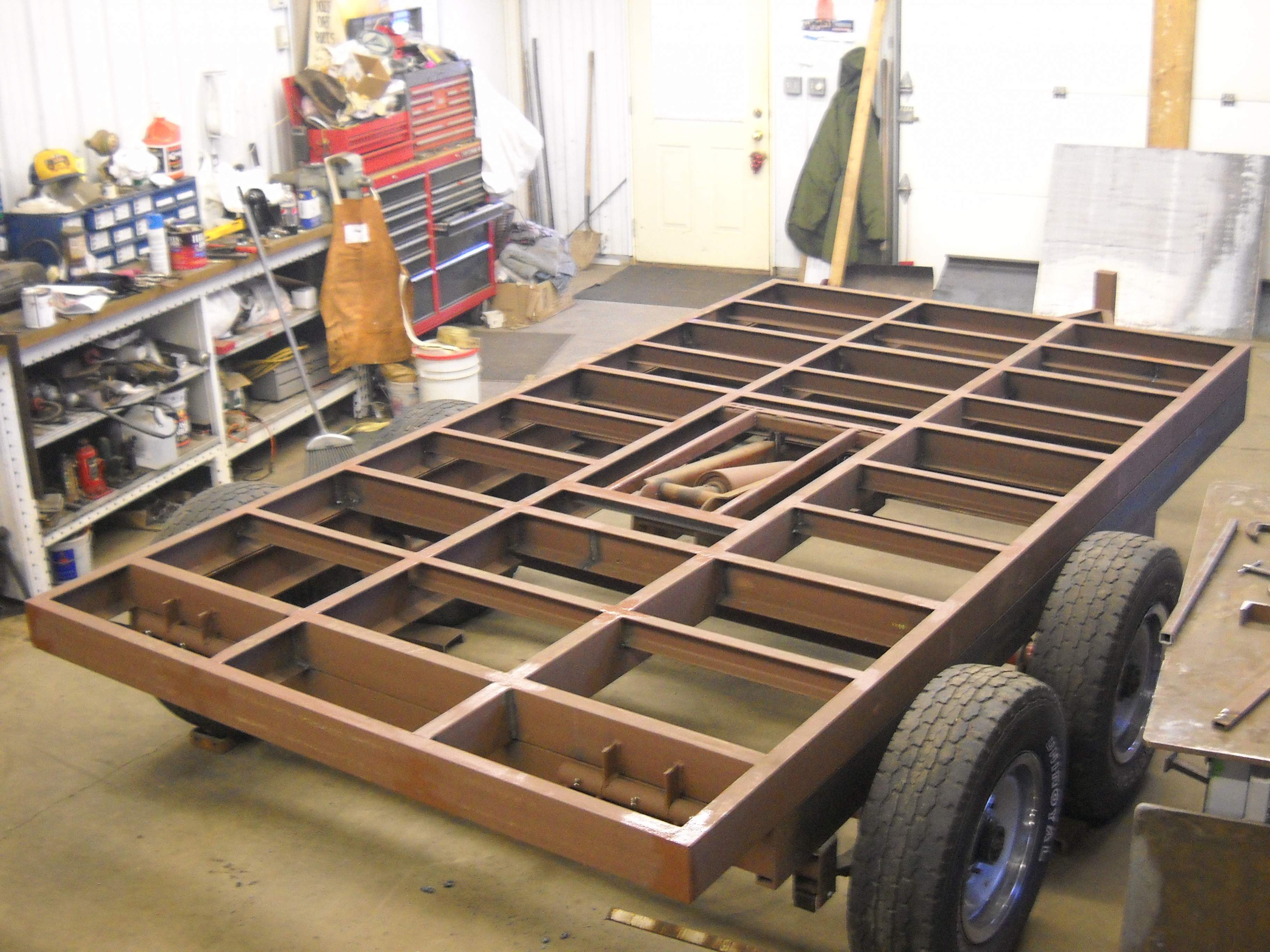

I am building my own 80" x 12' dump trailer. I can't see where they get their 6k plus price tag and some use such lite duty metal they are bound to fail. Mine is 6" channel frame and 5" cross supports. I have 10 guage 5x10 sheet steel bent for the floor / sides. Sissors type hoist and Dexter 7k axles. Materials alone I am looking to get it finished for two grand.

They are not using light material just to save money, it's to save weight. Your home-built trailer looks very solid and rugged but will probably weigh so much it barely has any payload left...

I was thinking the same thing, and having 7k axles will leave even less payload available.

I doubt it will weigh much over 4,000# completed so a 5 ton load will be possible. That is plenty for a dump trailer that size.

I was originally thinking that the combined weight rating of the axles was 7,000 pounds but after looking at his post again, it appears that each axle is rated for 7,000 pounds, for a total weight rating of 14,000 pounds, which I agree leaves plenty of capacity.
/ Dump Trailers #91
Main usage is hauling rocks, gravel, wood and equipment. Trailer house type frames will never take the twisting abuse and load. A little heavy yes.... but you won't find any future reinforcment patches added. I doubt if it weighs 4k complete.

I bet it will be very close if not a tad over 4K. I sold my uncle a 14' BriMar Dump in 2004 or so. Its got dual 7K dexters and the 3 way rear gate with slide in ramps and its 4,200# empty and I doubt its as heavy built as this one. I have used it well over 20 times and its been across that many scales at different gravel yards and it always comes in at 4,200#.

Frame wasnt cracked, it was broken open from the bottom. I mean the frame had a 11/2 inch gap at the bottom. Frame is made of box tubing kept light to reduce weight. Still these trailers are something every guy should have.
Exactly my case;
Why pay big money for an "engineered " keep the weight down trailer and patch it with ugly slabs of iron ? My brother bought one... loaded it with 3/4 the gross vehicle weight, and it folded in half crossing a field. He had to get an attorney to get his money back. I think the dealer payed the bill as the manufacturer had thirty excuses.
