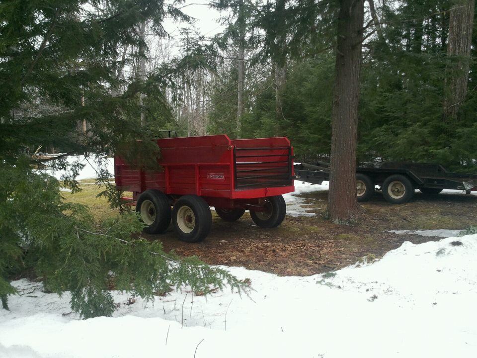

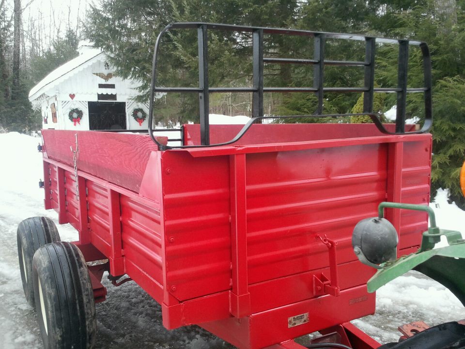

I have had a pronovost dump trailer for the last 30 years and it's held up very well. I just put new oak side boards on it and built a headboard and firewood tailgate for it. This spring I freshened the paint. This is the first time I have had to touch it in all that time and frankly it really didn't need the re-paint.The company was out of Canada back when I bought this from my local JD dealer. I think they have a website.
