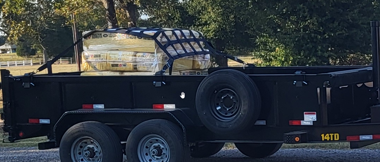

Picked up a pallet of shavings from TSC this afternoon. The dump trailer is easier to maneuver around parking lots than the 25' GN trailer by the hay barn. Mine is the Big Tex 14TD. The new model has a 5-stage ram instead of the 3-stage like mine.
Dump trailers are usually hauling material close to max weight. I recommend going with G rated trailer tires instead of E rated. I blew out 2 of the E rated in the yard after I got home hauling dirt. At least I wasn't stuck on the side of the road.

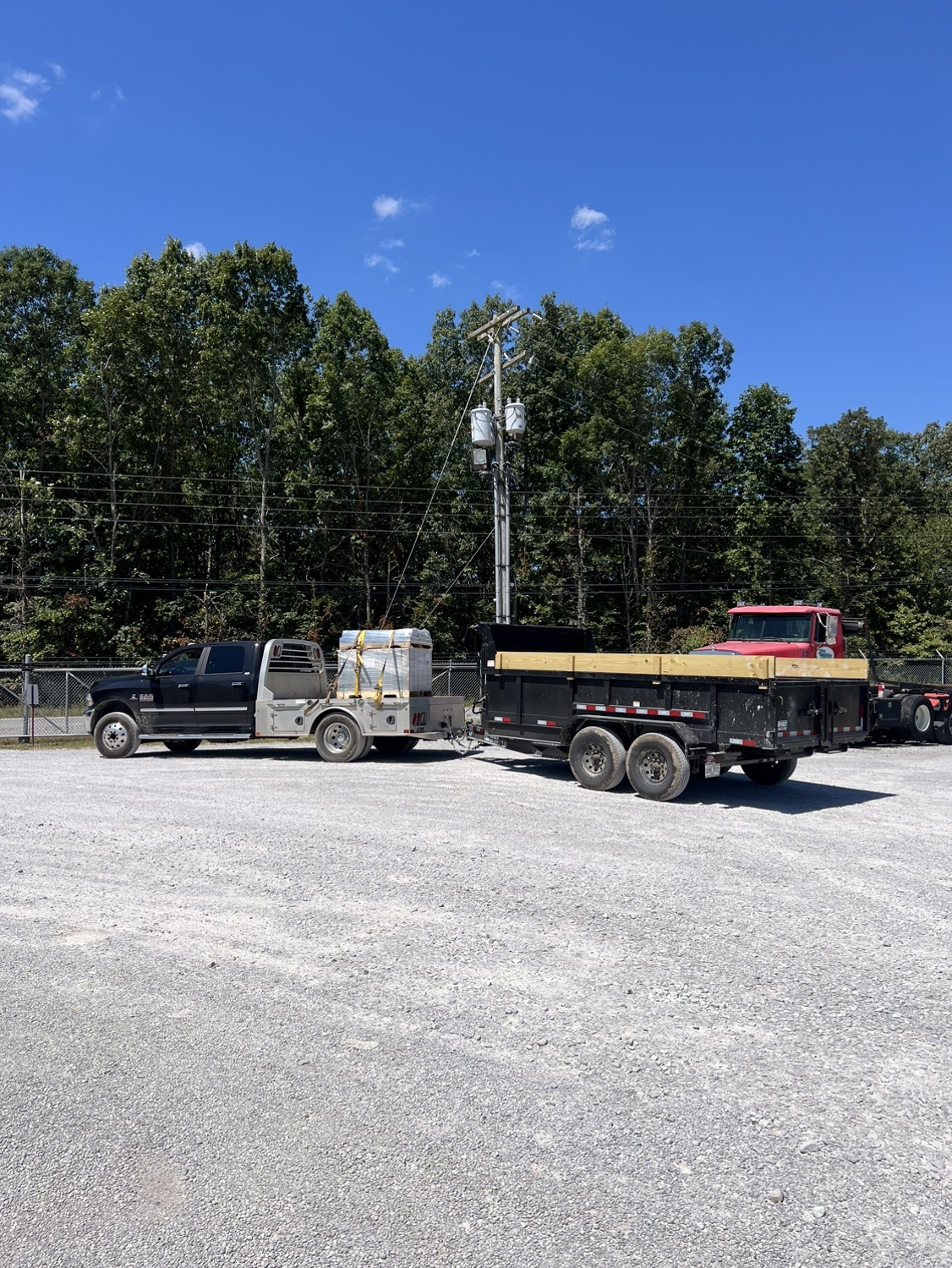

I was asked to spread part of a pile of dirt at our Church. I enlisted some help and we had 6 people moving dirt from 7:30-3:00 at which time 3 of us started moving it to my house a quarter mile away till 7pm. Then I rented the same trailer this weekend and worked 7am till after dark. This is what is left of the pile Saturday afternoon. The hydraulic ram won't dump as much as it will haul but if you pile it up in the rear and leave a foot empty in the front it has a good chance. If not, I have tractors at both ends to take a scoop out.

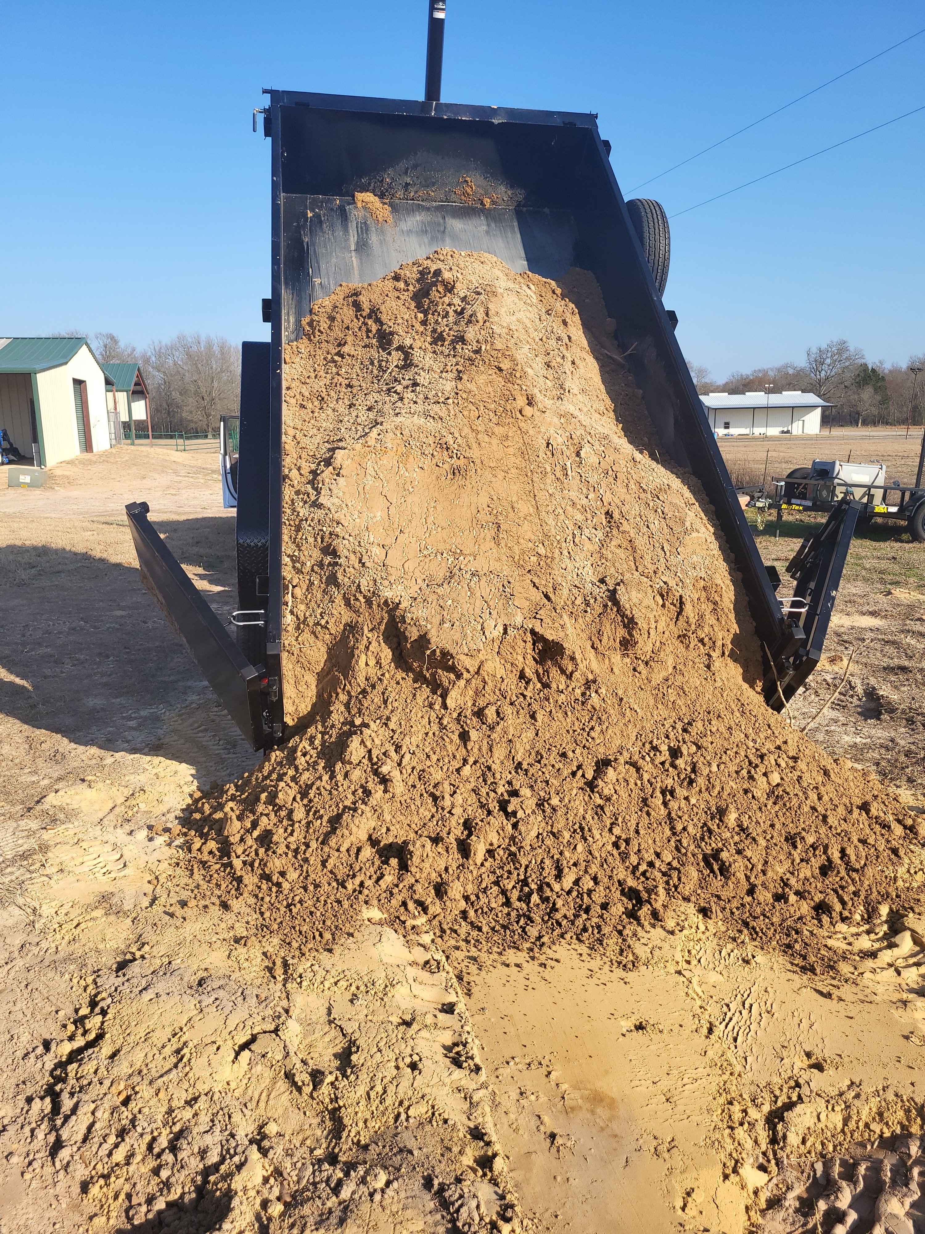

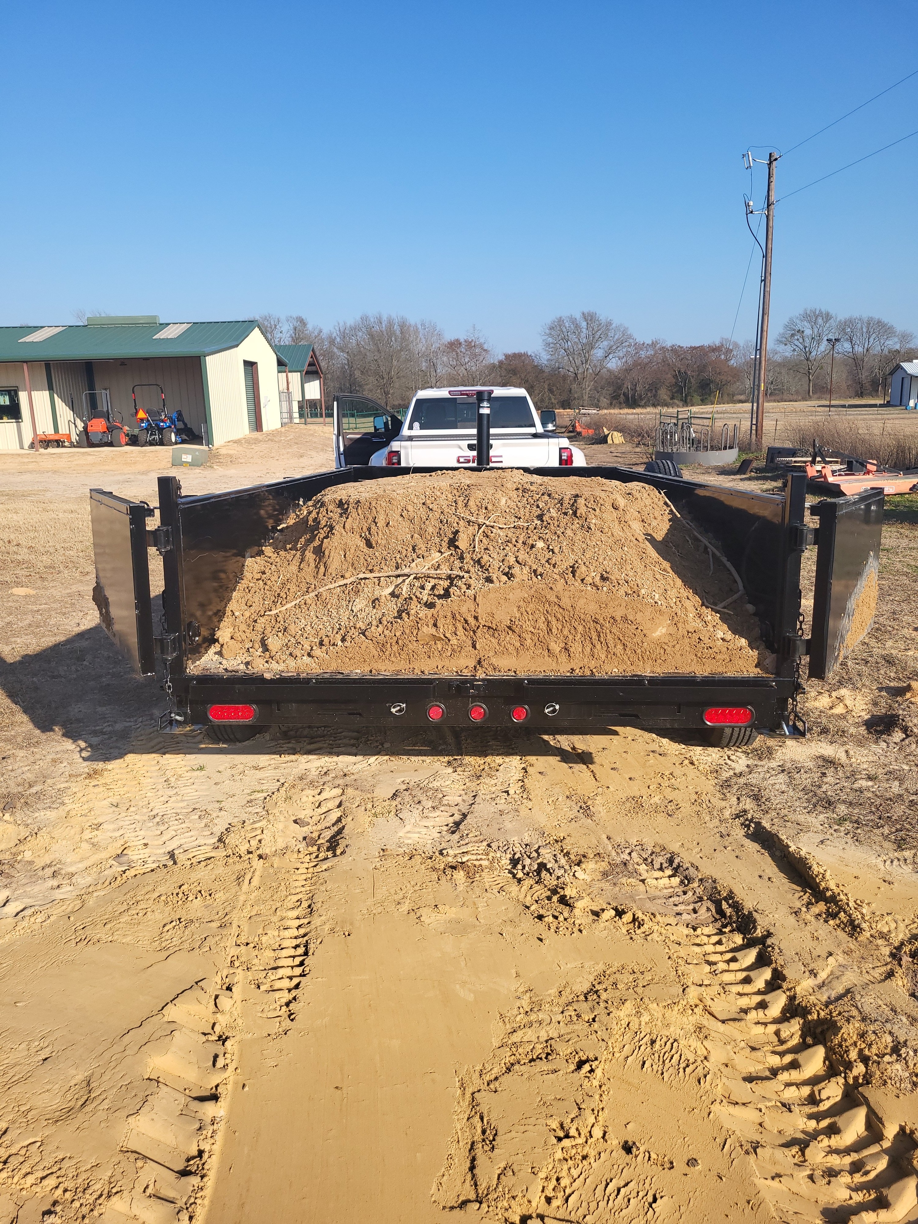

I vote for the hydraulic ram at the front. My first dump trailer was a 14' Big Tex 14GX with a scissor lift. Listed allowable payload was 11,250 lbs. Topsoil weights 2,000 - 2,200 lbs depending on wetness. It wouldn't lift 6 yards of topsoil without having to shovel some out of the front. And yes, it was overloaded a little. My 14' Big Tex 14TD has a 12 ton 3-stage hydraulic ram at the front. Lifted 6 yards without an issue.

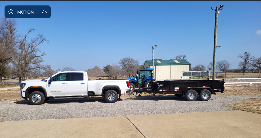

I currently have 4 Big Tex trailers, only brand of utility trailer that I buy. Had 3 more that I traded in over the years that I outgrew and traded in on new trailers. All the trailers have held up well. I have a great dealer in Triple M Trailers and we are close to the Big Tex manufacturing sites, so parts are readily available. No major issues, only warranty issue was they forgot the put hooks on the back of my 14TD dump trailer to hold the tarp bar in place when it was built. Dealer took care of that.
Only modifications after the purchase that I have had done was to put a winch and battery, 2 stake pockets at the front, and rear jacks on my 70PI utility trailer. I have d-rings in all the stake pockets to clip in chains and straps when securing the loads. Made quick work of securing the shavings with my cargo net that I hauled yesterday.
I recommend going with G rated tires on a dump trailer. Mine are the Hartland in house brand from Discount tire. I have TPMS on all my trailers that hook up with my GMC 3500HD. I did have to buy 4 new rims to fit a TPMS stem as the stock Big Tex rims have a larger valve stem hole.
