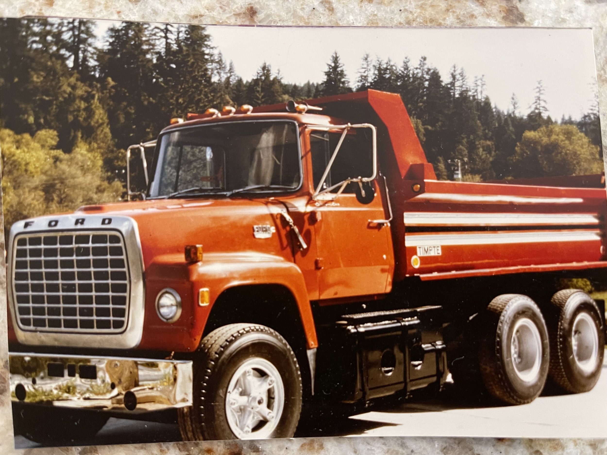

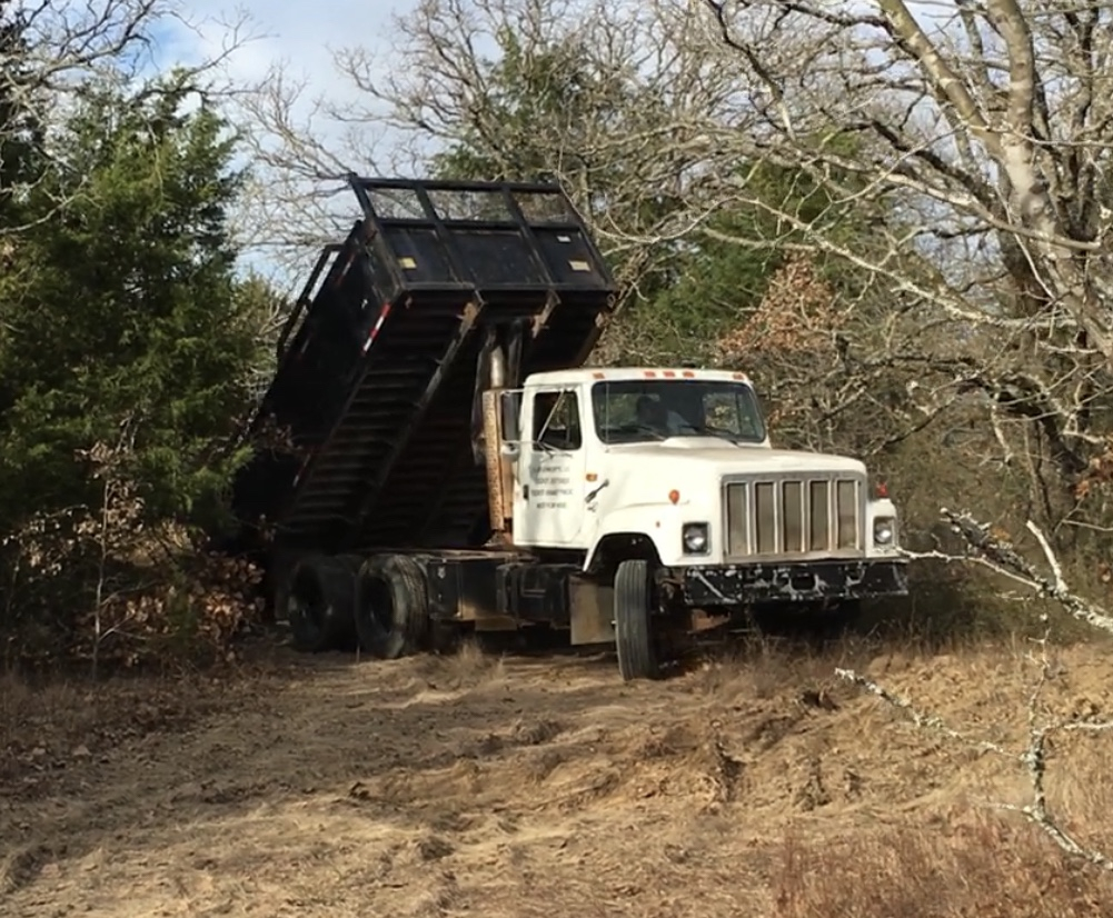

I had a mid 70s Ford but all they made was the cab and frame. The engine was a 14 liter or 855 cid Cummins. Known to be the workhorse of trucks at the time. It had Jake brake and it ran and held back too. Backed up by 13spd Fuller and Rockwell axles. Great truck except the cab was starting to rust on the inside when I retired. Paid $12k with bed, had to make a new tailgate and install the PTO and mount the bed, ran it fir 23 years and sold it fir $10k.
