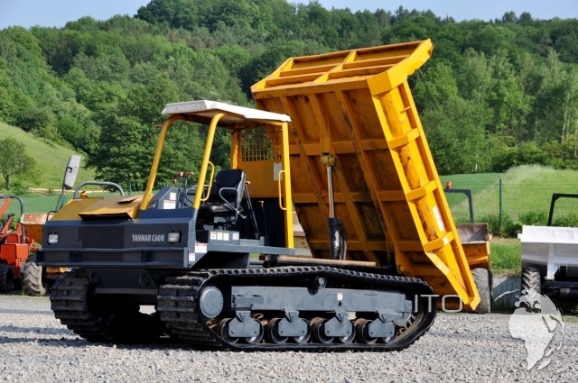

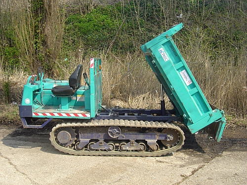

Here is another option for off road use:
Tracked Dumper.
construction-equipment-tracked-dumper-YANMAR-C30R-2---2_big--12121019442898103000.jpg tracked_dumper_1.jpg Tracked-dumper.jpg

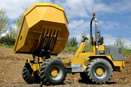

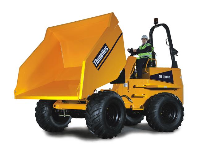

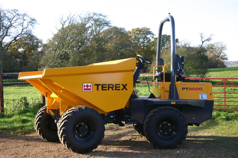

Articulated 4WD Dumper.

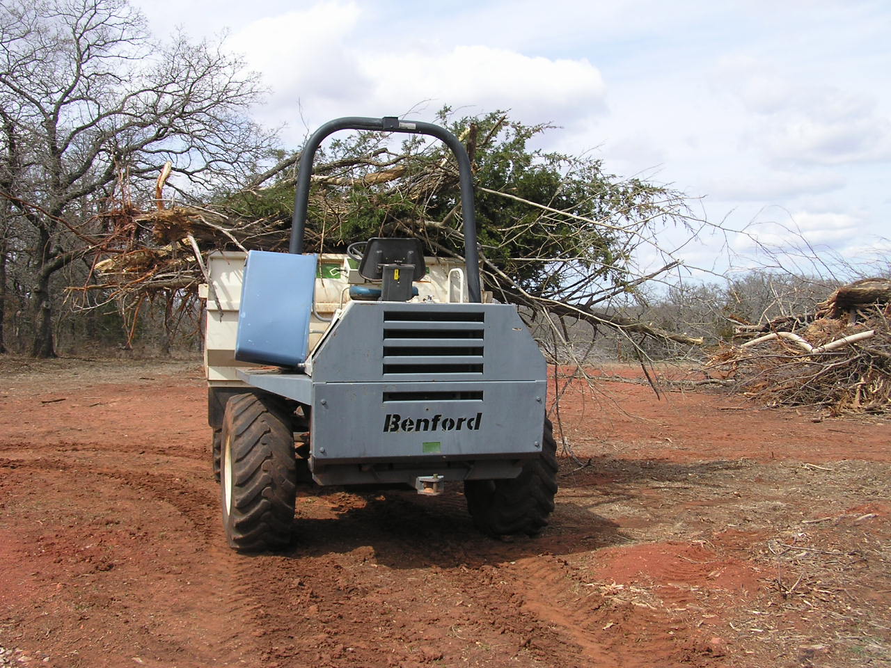

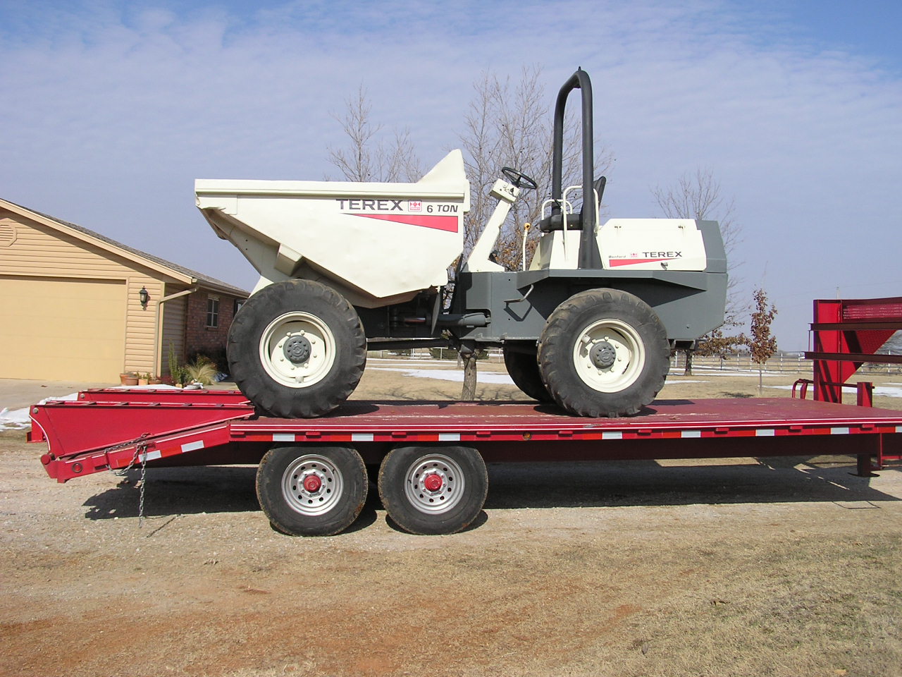

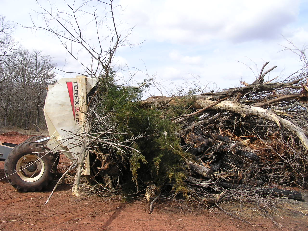

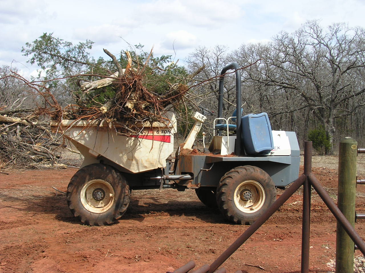

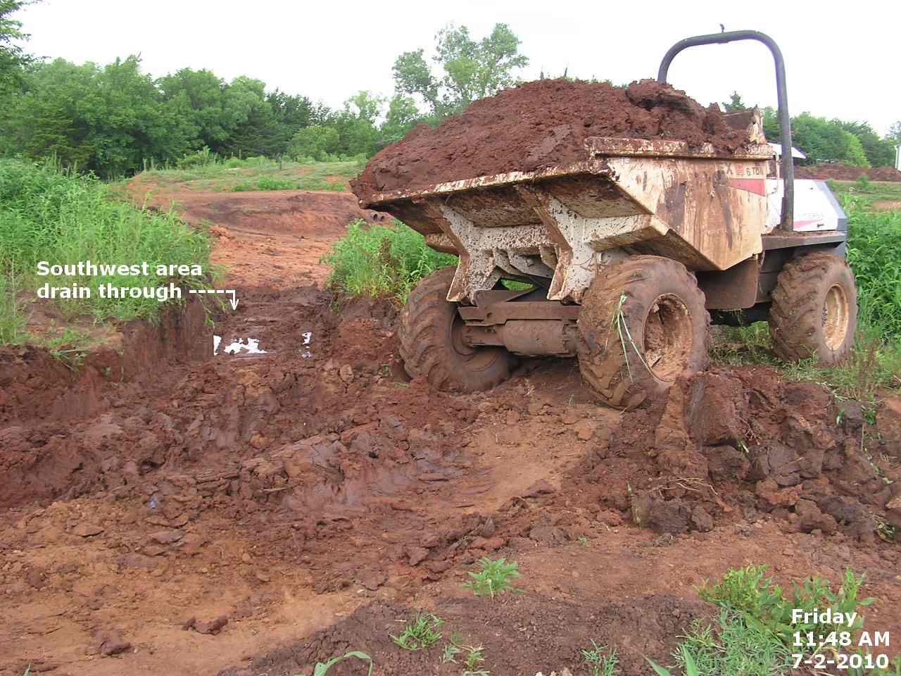

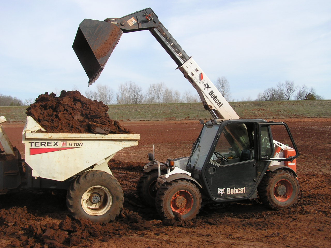

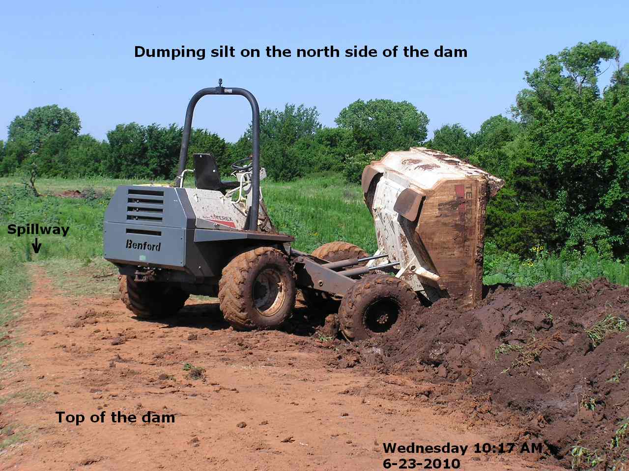

I found mine on eBay three and a half years ago.
Hauling brush.
Hauling about 13,000 pounds of dirt.

Depends on how far. It has a road gear, put a SMV sign on it and it would be just like driving a tractor down the road.
It weighs a little over nine thousand pounds, so I can haul it on my trailer.

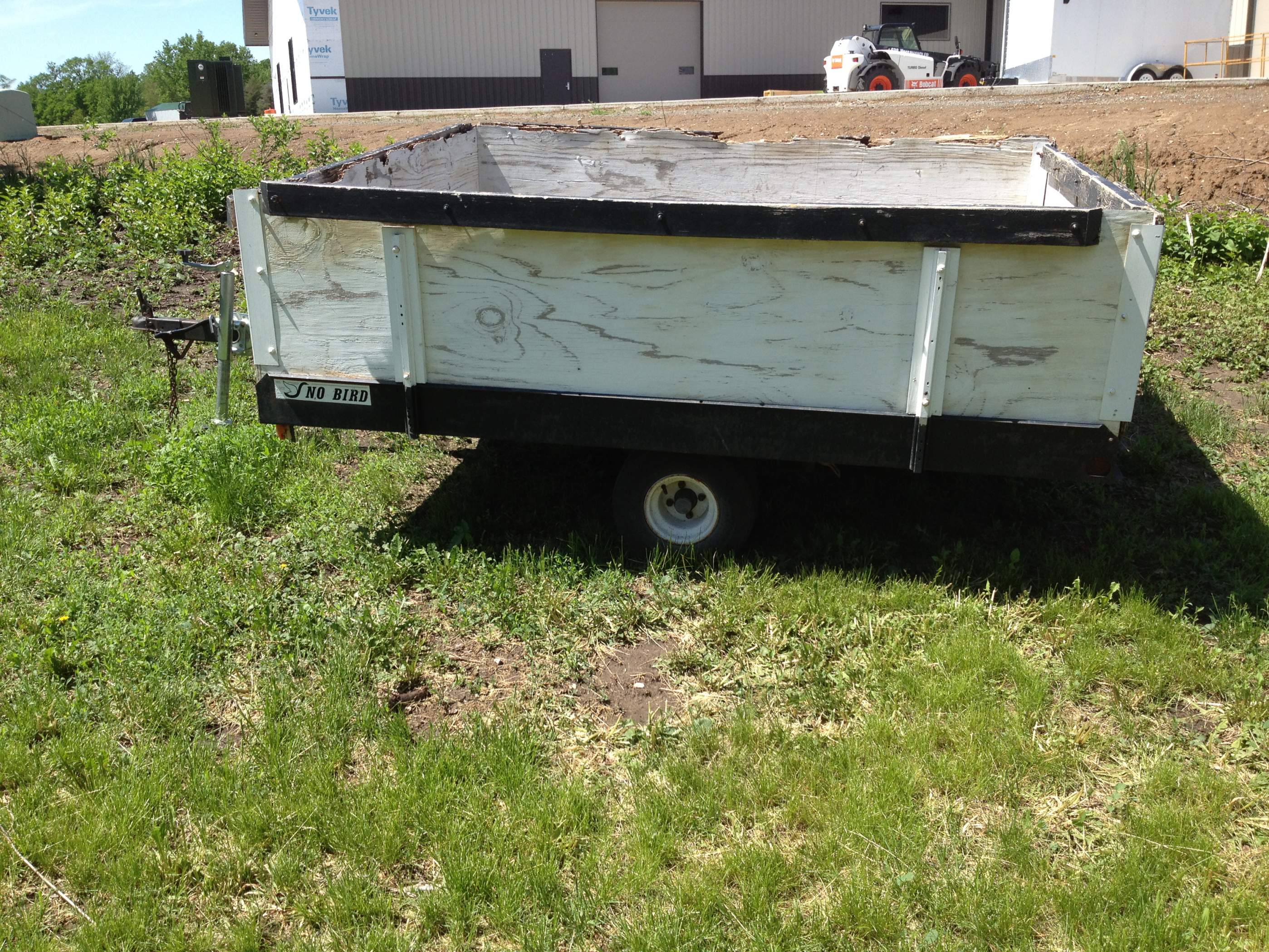

To add a bit of context to the discussion, here is a pic of my existing trailer. As you can see, it wouldn't take much to represent a significant upgrade.
