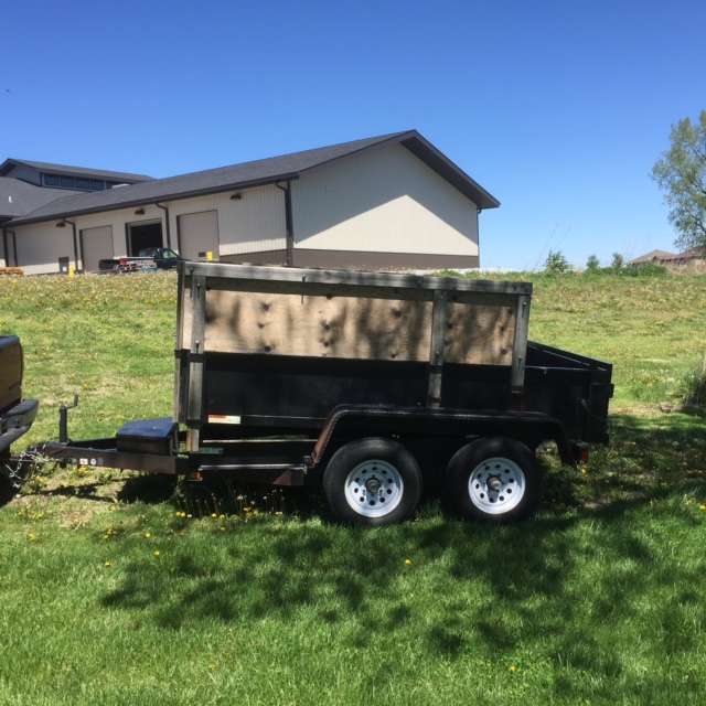

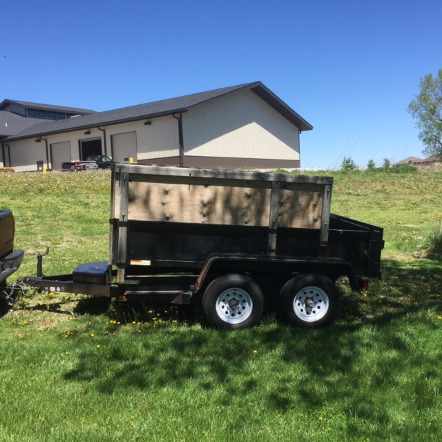

I'm not contesting the fact that you can put an extender on the gooseneck, etc. It's just that my owner's manual says the 5'8" box isn't supposed to do a gooseneck.
As far as dumping my snowmobile trailer, it does have a pin on the tongue, but by adding the weight of the plywood sides, it doesn't tip very well and when tipped, it's only about 30 degrees or so with the tail on the ground, so not enough to get anything to slide out.
