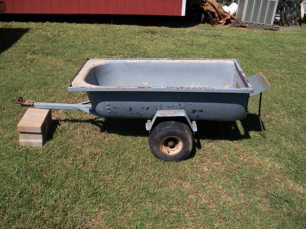

Well the old trailer's gone. Sold it last night. Pretty mixed feelings as it's been by far my biggest and best project so far, and was extremely handy, but I'm saving up for smaller and better things. LOL
Sold it for what I had into it (minus my time) to a fellow Jeeper that's going to use it more for camping/hunting then work.

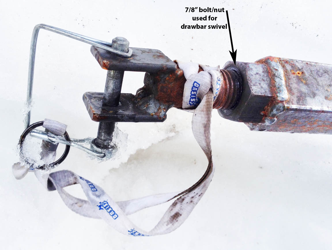

Very nice project! To protect your eqpt from trailer rollover you can make a rotating section on the drawbar with a large bolt and nut. Here's a pic of a small drawbar (on a snowmobile trailer) that uses a 7/8" bolt for pivot. It simply rotates on the threads. If you could find a 1 1/2 inch diameter thread + nut it would probably fit your needs well and low cost.
For scale, this drawbar on this snowmobile trailer is 1 1/2" square tube.
374309d1399578473-dumping-offroad-military-trailer-snowboarder-transport-trailer-swivel-jpg
It could let go if the trailer rolls over about 15 times.
Well I guess I found the limit for my little trailer. It bent the top portion of the pintle.

Yeah Sodo, I've seen those types before.... there are swivel pintles that are pretty cool. However, I think my roll shows that a normal pintle can take an incredible amount of twist... even though that trailer's sold, I would have built it the same way.
