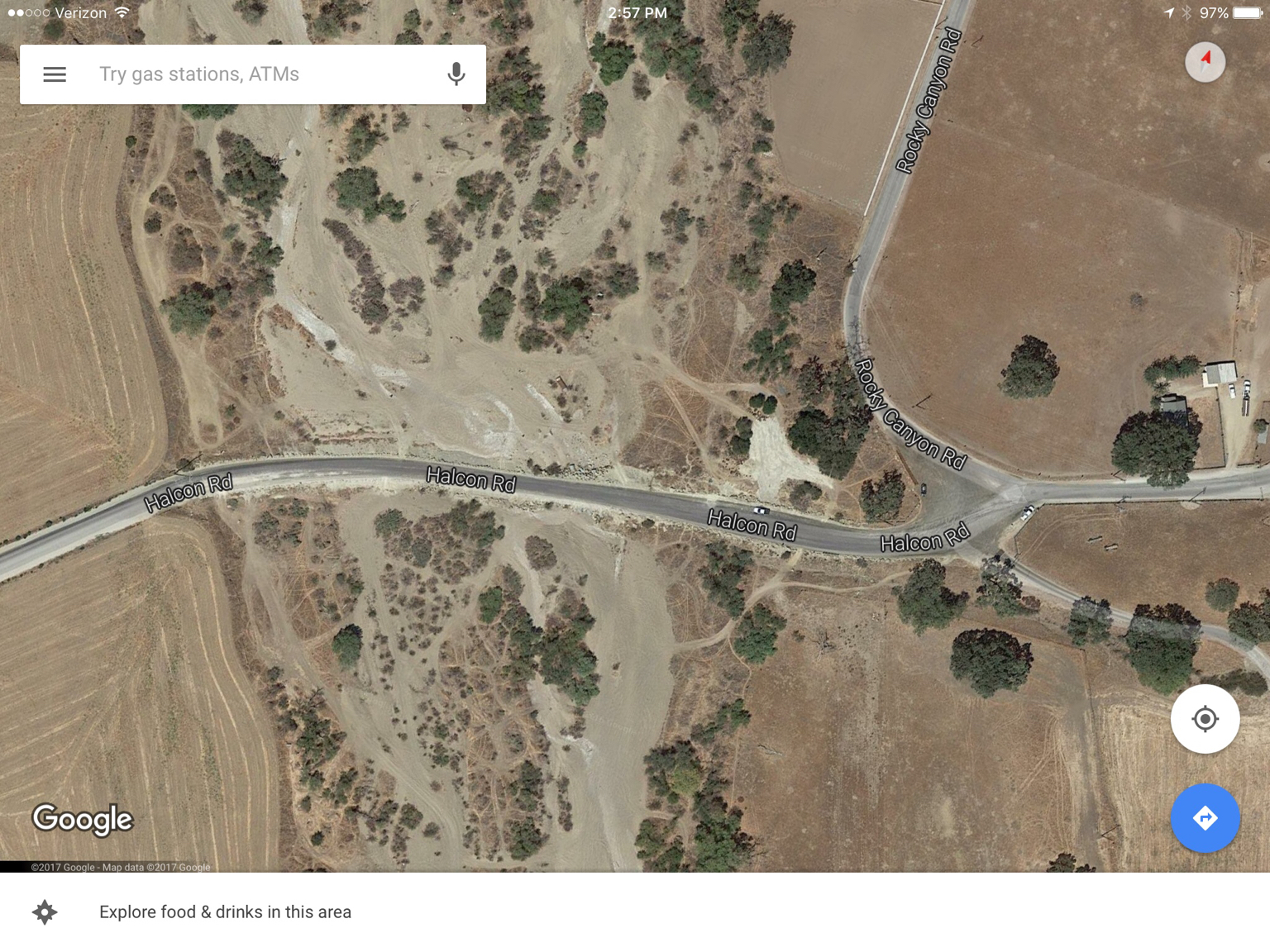

Yes chip seal was another option as a crew was in our area at one point. Big crew and lots of equipment. Cash at the end of the day maybe.::..but then it's last minute and the neighbors can't drive on it for 12-24hrs. Funny how similar the stories are! Glad it was a reduction in cost. Too bad it's still $700/yr to keep the dust down. I'll post a google earth photo of the dirt road over the river that uses the product. You will have a hard time finding where the dirt starts and asphalt ends- hint it's asphalt on both ends!
/ DUST CONTROL #30
This is after several years- don't expect that after the first application.
