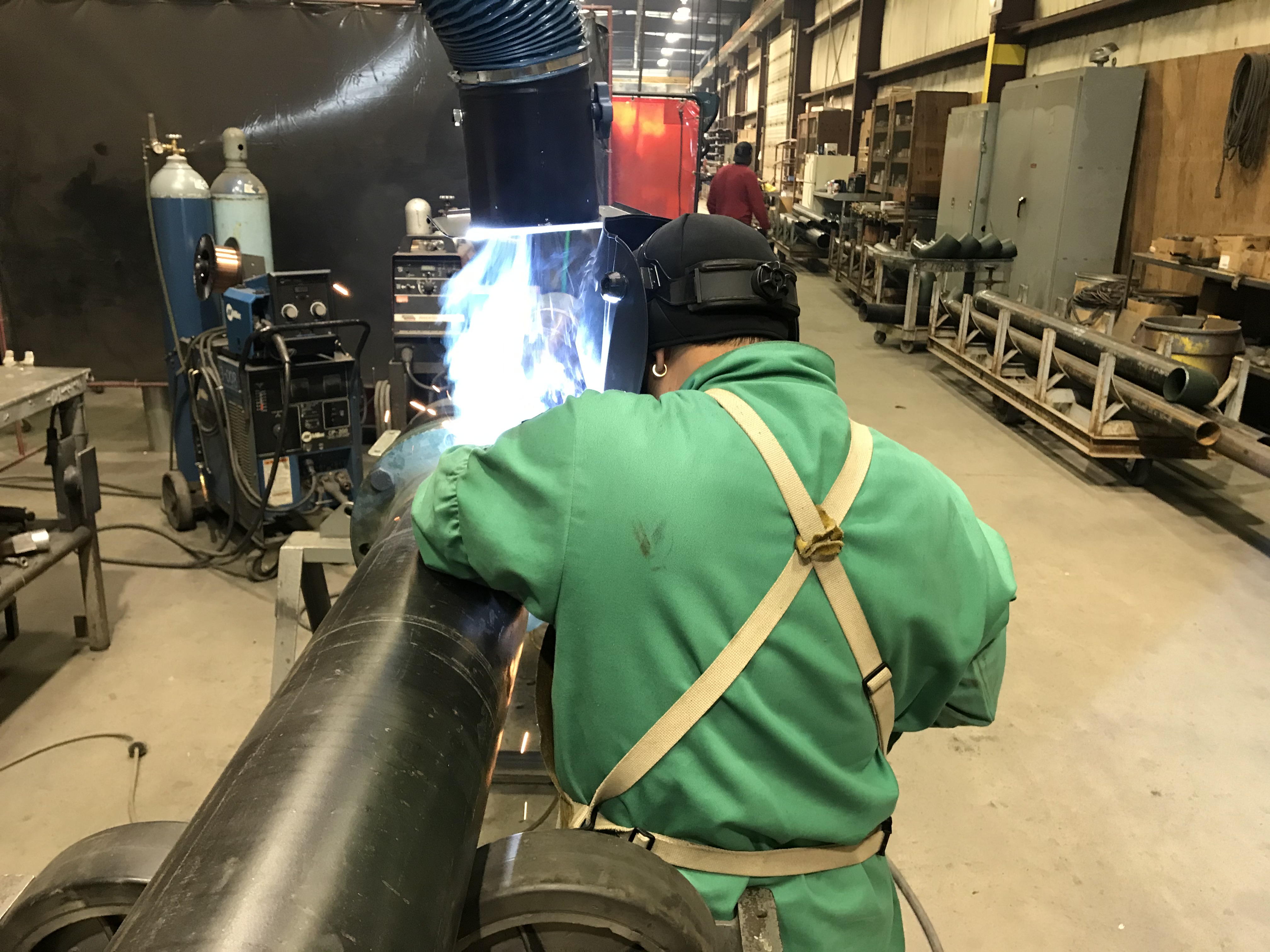

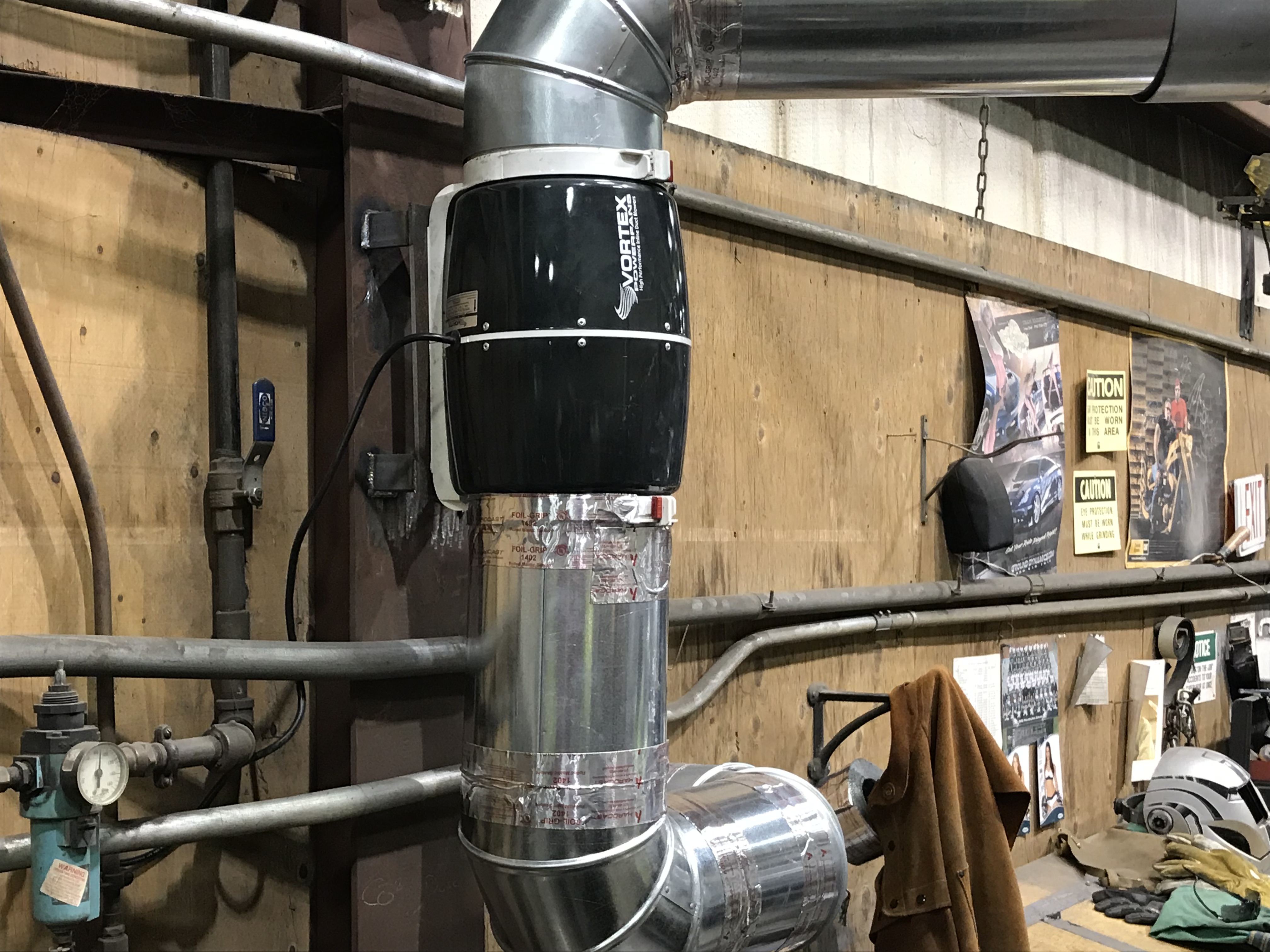

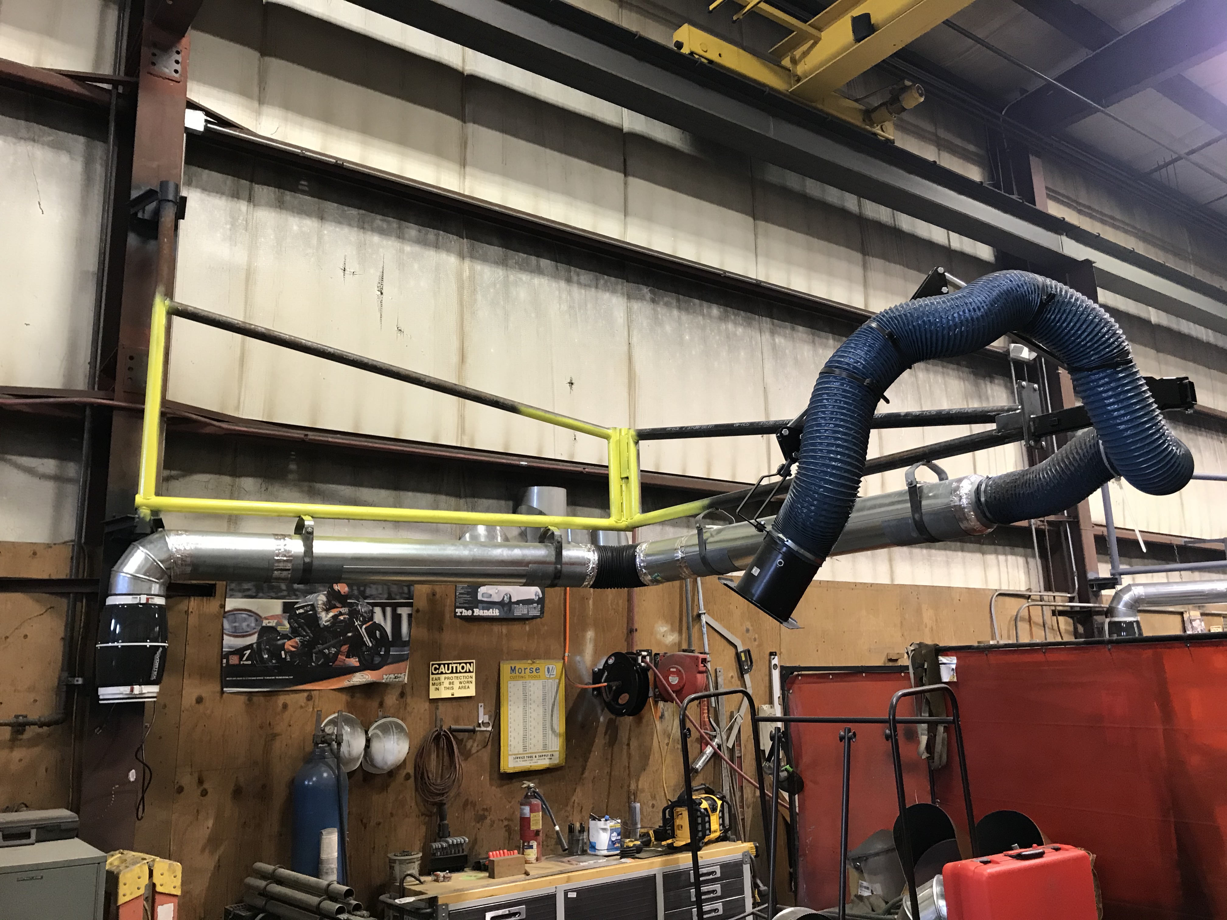

   / DYI fume extractor ideas #87
We made up 3 of these in our weld shop at work using the MonkeyArms on the end. That allowed quite a large radius of coverage:
