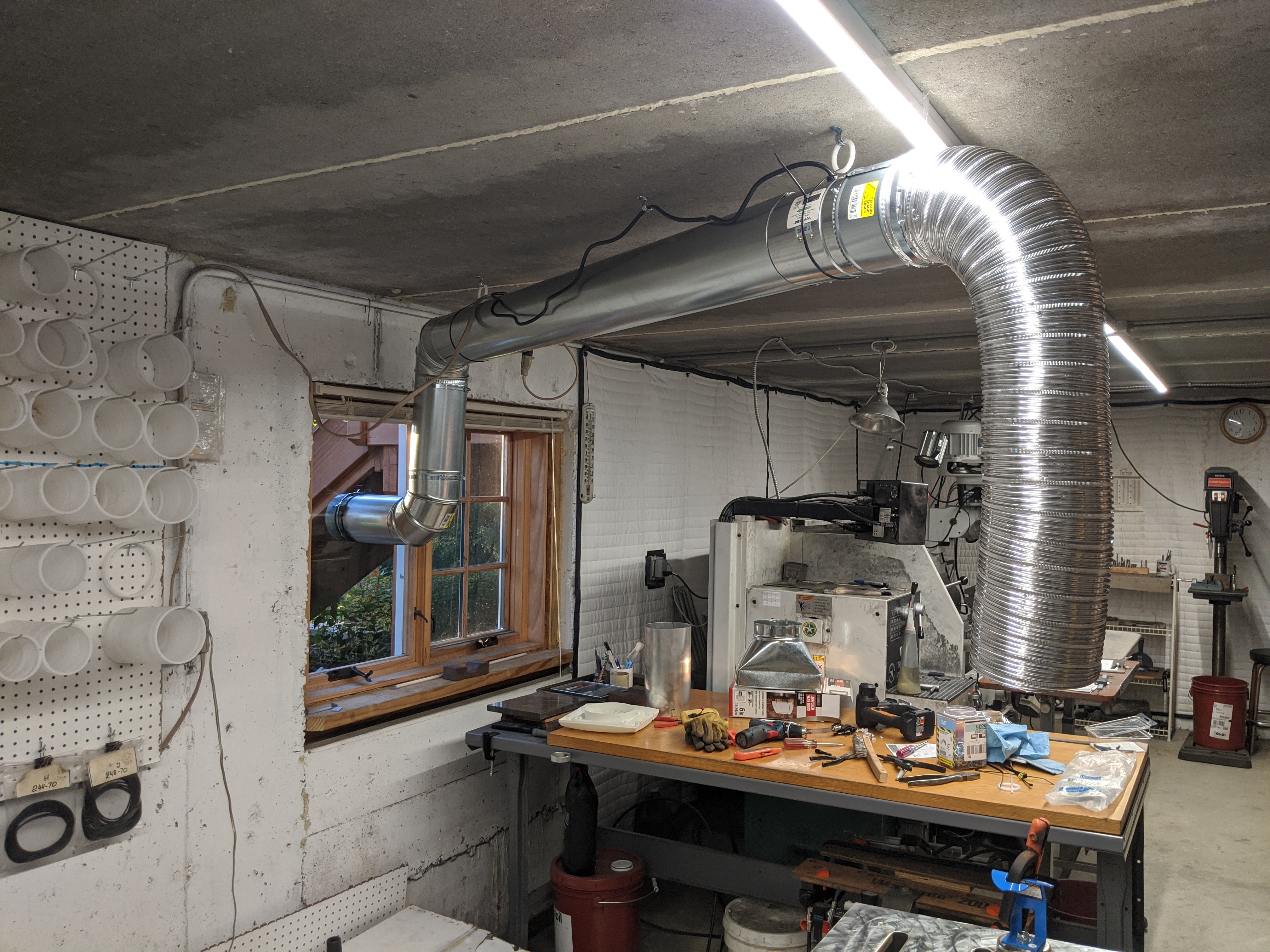

Gene, hope you get back to your welding exhaust project soon.
If I install a 6" fan like your, I might try one of these 6" charcoal scrubber units for about $50 to test with a small amount of ducting.
That way I would be cleaning the fumes and exhausting the scrubbed air back in my garage space, this just might work for me as I only mig weld with gas, and tig weld.
You welding with stick generates a lot more fume smoke, I'd guess.

Dragon, yeh that's 6".

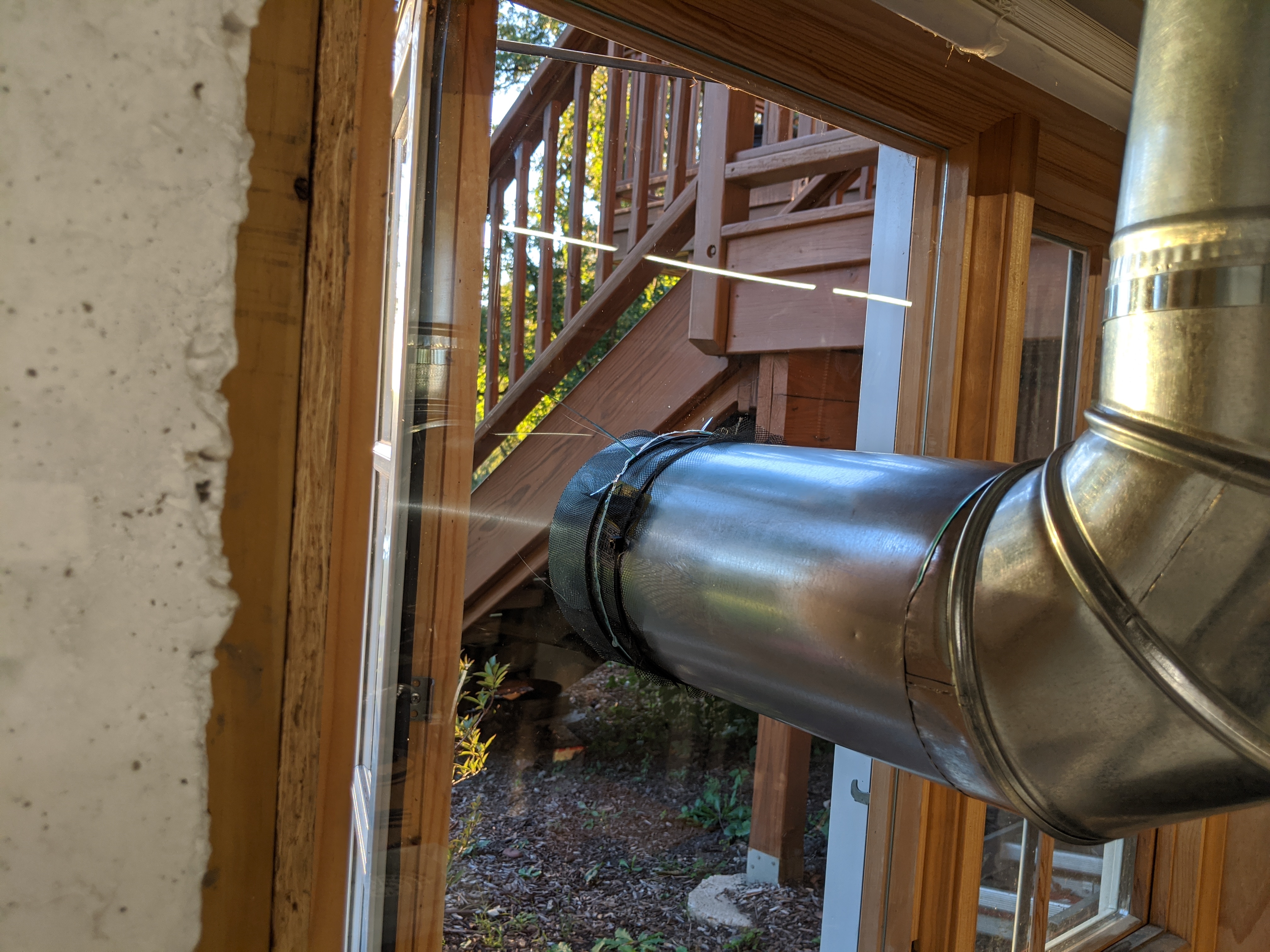

Is something wrong with this site today, or is it just my connection? Strange. Anyways, here's how I routed it out the window. Hard to see I guess, that's a piece of plexiglass with a hole cut in it.

Indeed! Looks great. I was about to ask you how you were going to enclose the window opening. The plexiglass is so clear and clean. Had to take a closer look on this post. Well done. :thumbsup:

How loud is the fan? You could always use a Harbor Freight dust collector and skip the collection bags and filter. I'm not sure about their smaller one but the larger one has a steel or aluminum impeller and steel housing. Both the 1hp and 2hp use induction motors so they are a lot quieter than a universal motor. You would also get a lot more air flow, that might be good or bad. You could put a duct register on the end to spread out where it extracts the fumes from.

Yeh, they look real good when brand new. I'm kinda pissed though, I cracked it a little while sawing the hole in it, arggg! I was so trying to avoid that. :mad:
Way quieter than the vacuum!
