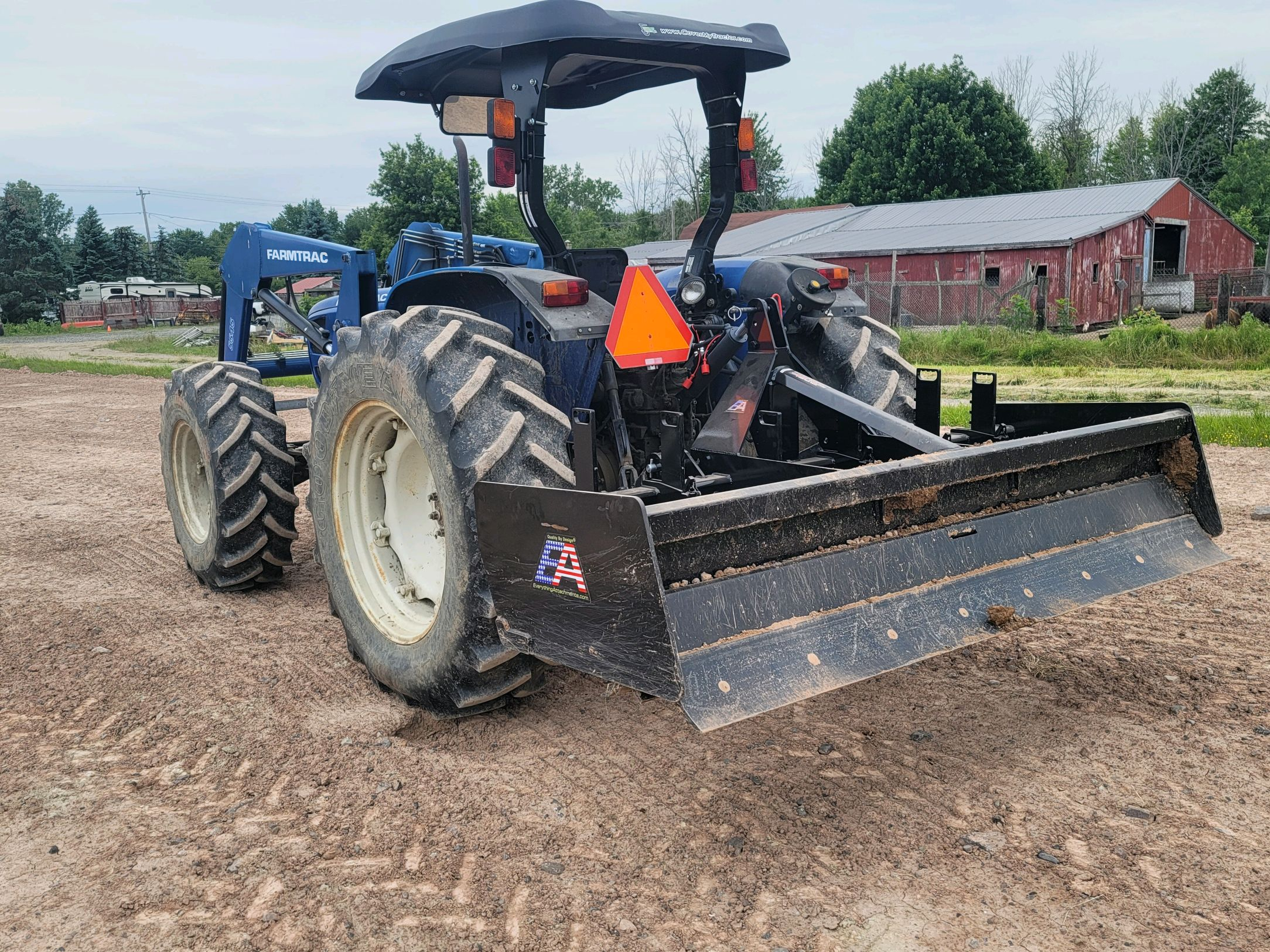

My EA box blade. They were the cheapest, heaviest blade (96") I could find. I'm new to using a box blade so I am learning but it has held up to an old stone area I was loosening up with the teeth. I have also ripped out some decent roots clearing a path through the woods. Gannon had a similar heavy blade but with hydraulic controlled scarifiers and a significant price increase.
