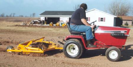

I would like to build a 20hp garden tractor size scraper somthing like this.
That is just sooo awesome !! it looks like that little tractor buries it deep into the ground, but i assume the pan sides arent that high after all so it looks like its going deeper than it is... ;)
I just have too many ongoing projects, i dont even dare to write the scraper on my wish list because i have a feeling that if i keep adding, it has to wait untill i retire.. :p

Kansas Kid, Were are you from. That one looks very close to my DB-6 from Hoelscher Commercial Products - DB Scraper
It would be fun to set them side byb side compareision, I could really use the front part to keep lose dirt in there while hauling it.

The little scrapers are really underrated. There is nothing you can hitch/attach to a wheeled tractor that will move more dirt as quickly as a dirt-pan.
I've used them to clean out tanks ("ponds" to the Easterners;) with great results. They can dig in a very controlled manner.......long and shallow or short and deep.....and do so with a good degree of precision. Honestly, I prefer to use them for serious earth-moving against a dozer because the amount of dirt moved and the cycle time in each 'pass' is generally better.
