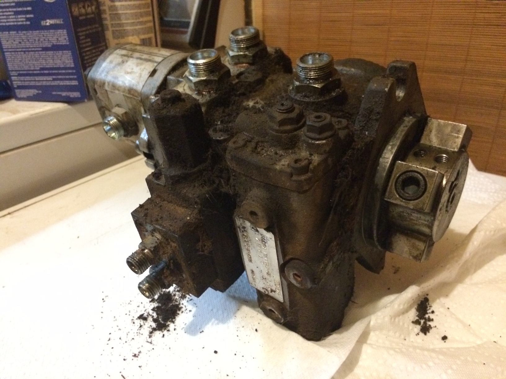

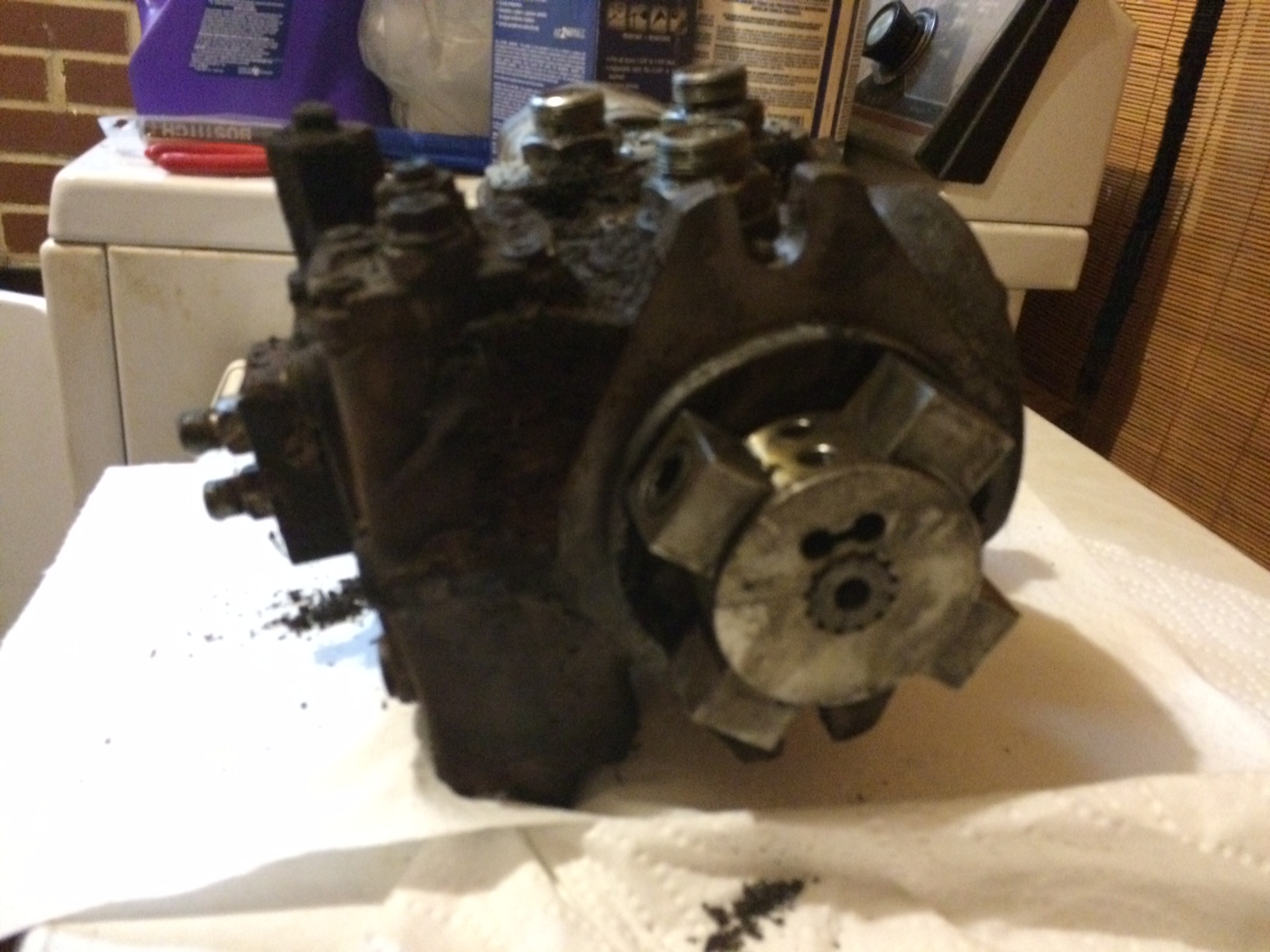

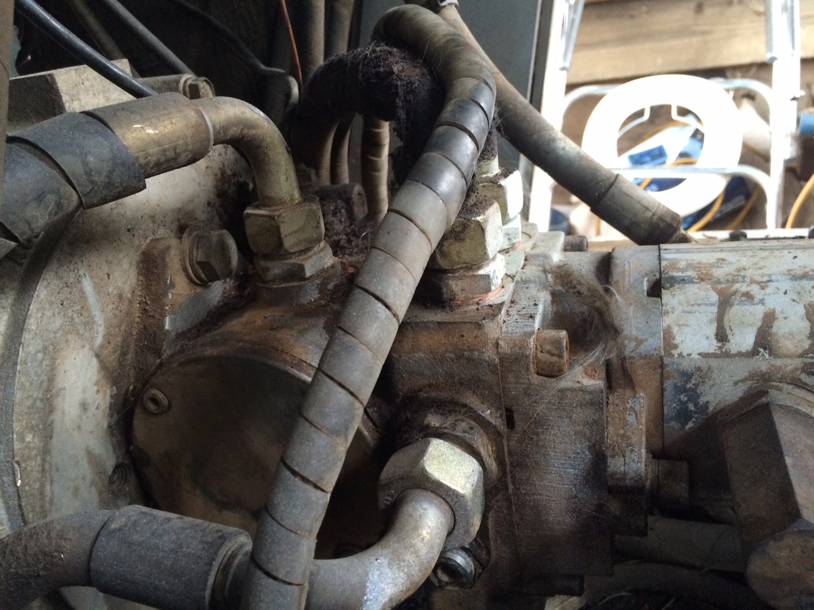

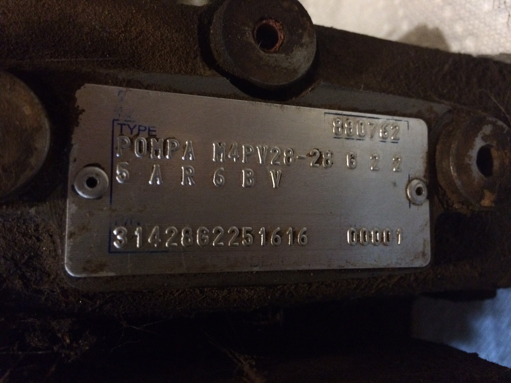

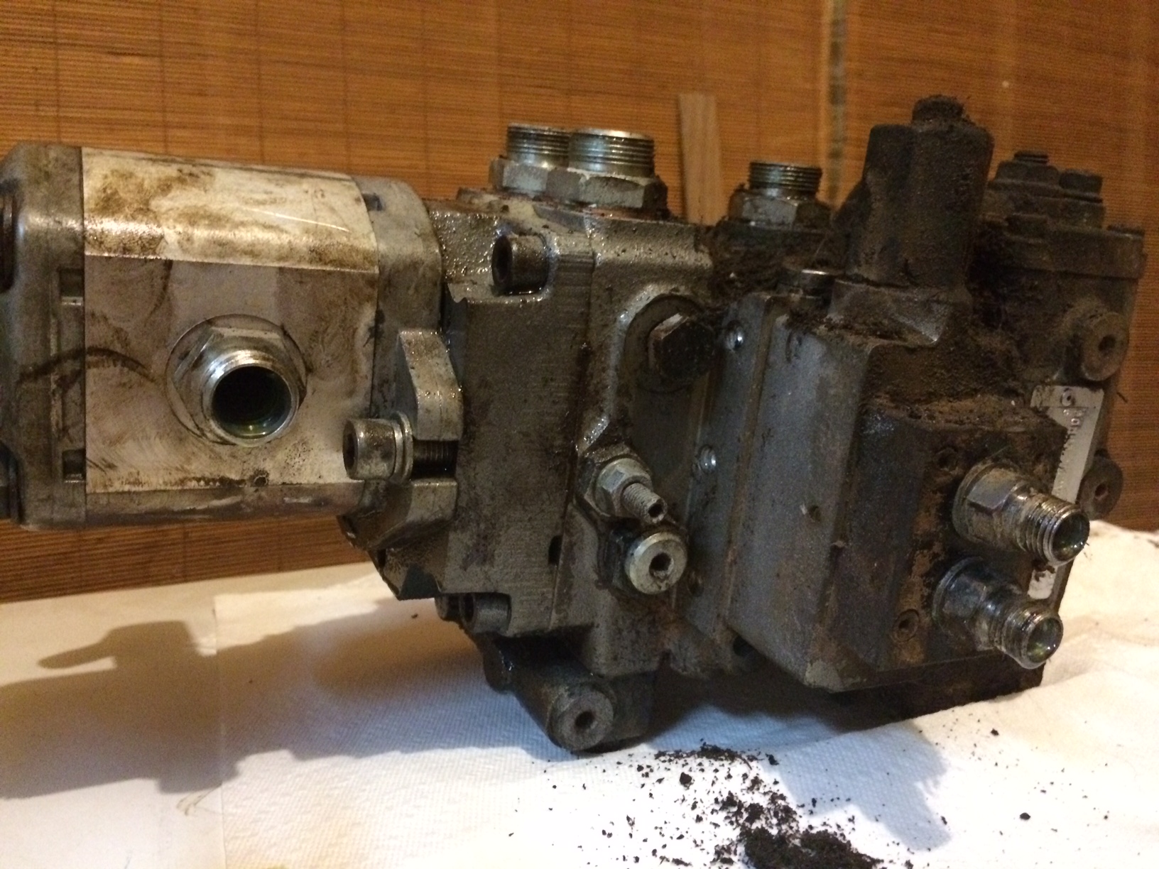

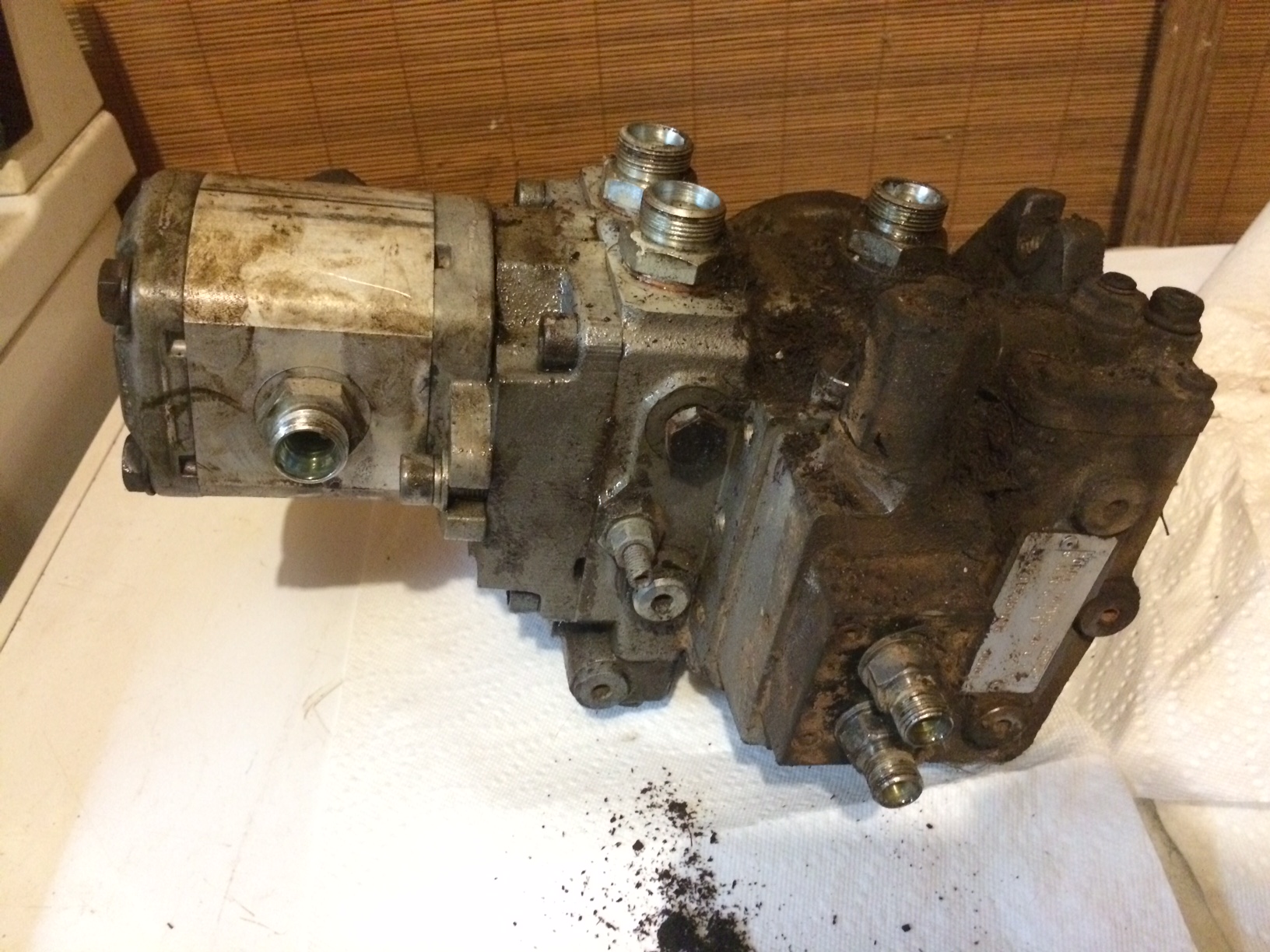

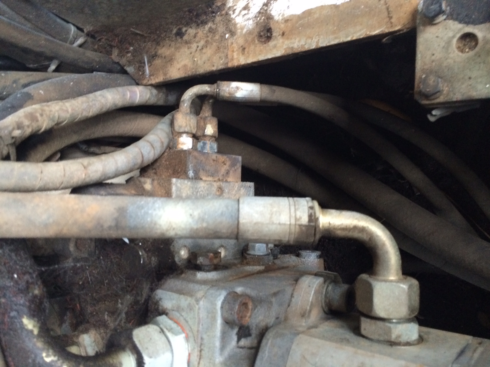

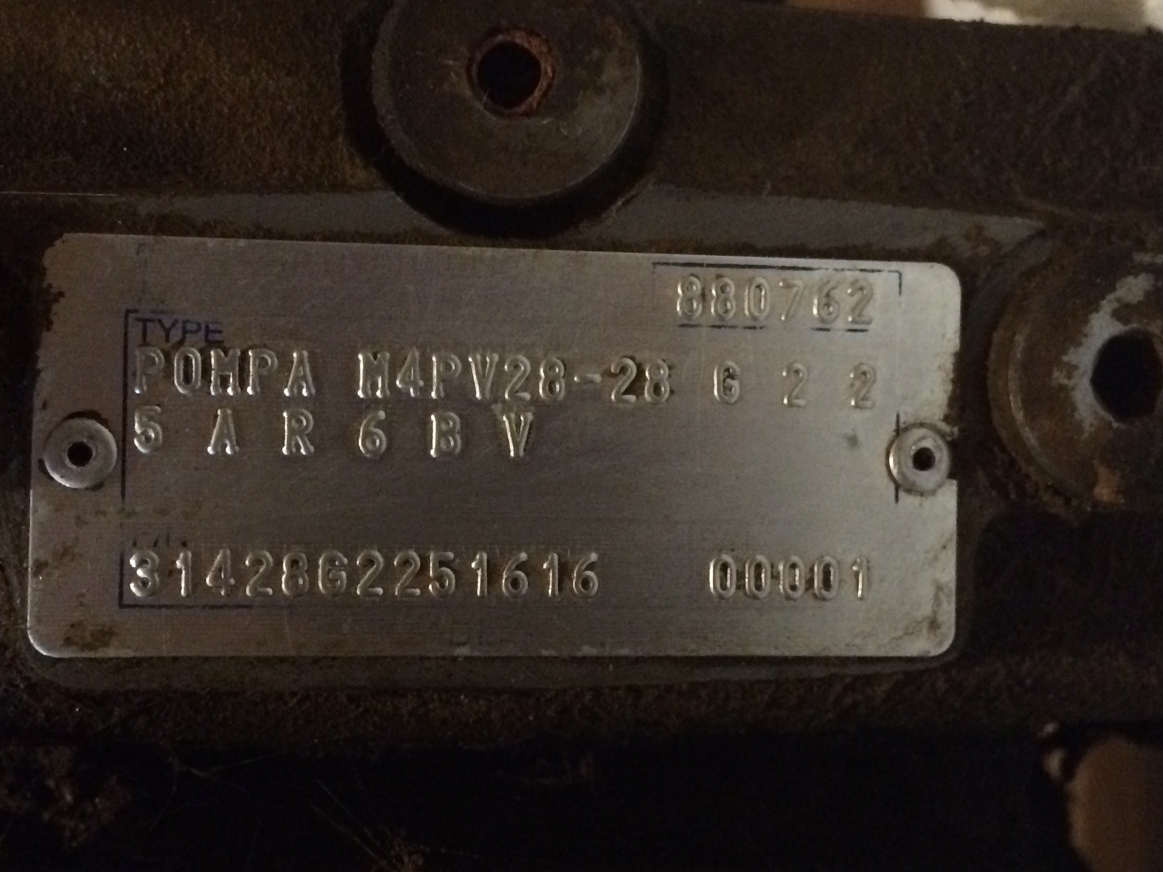

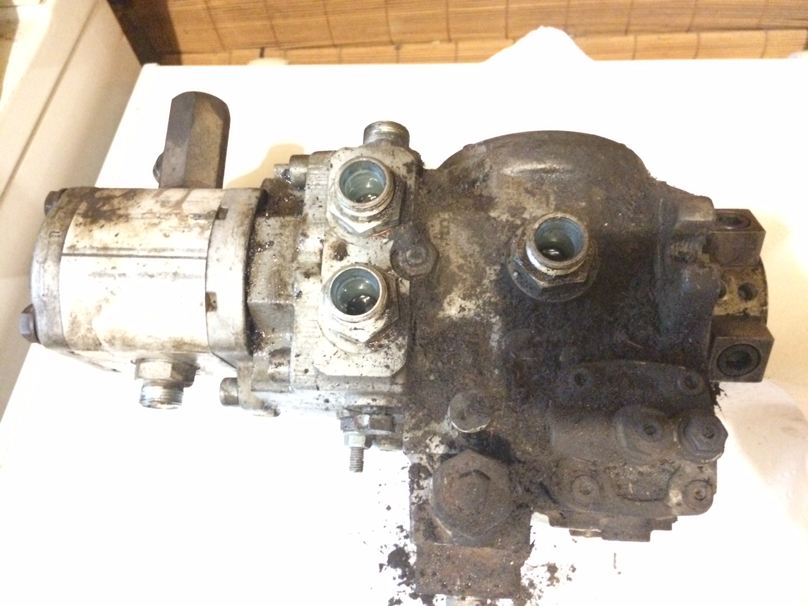

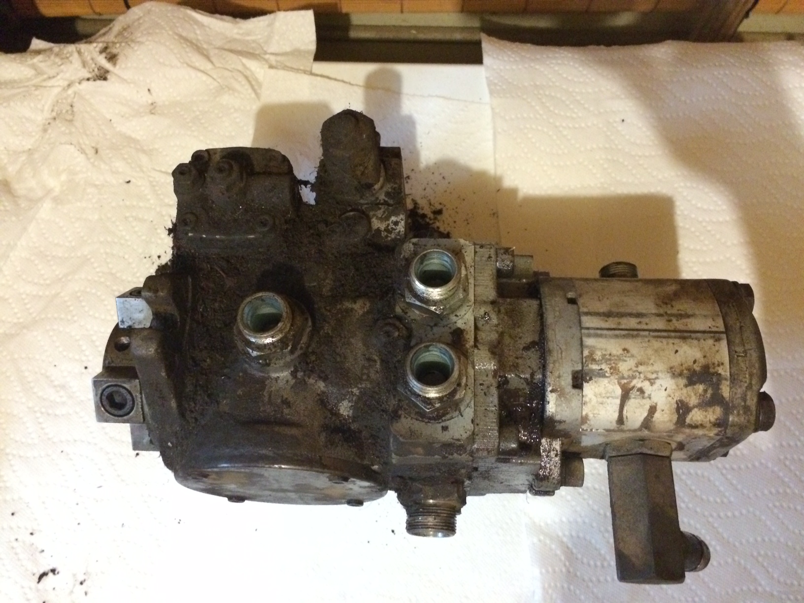

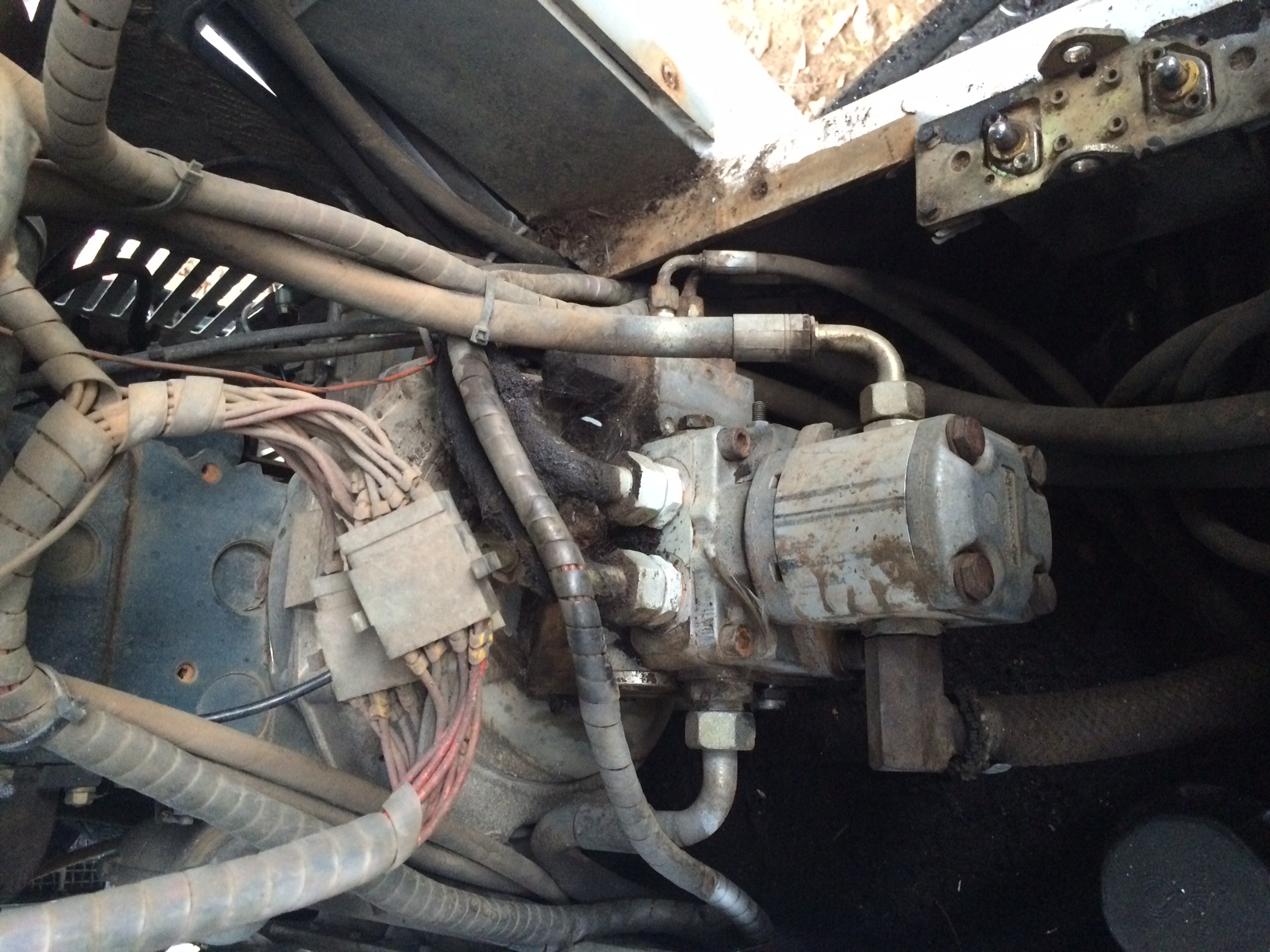

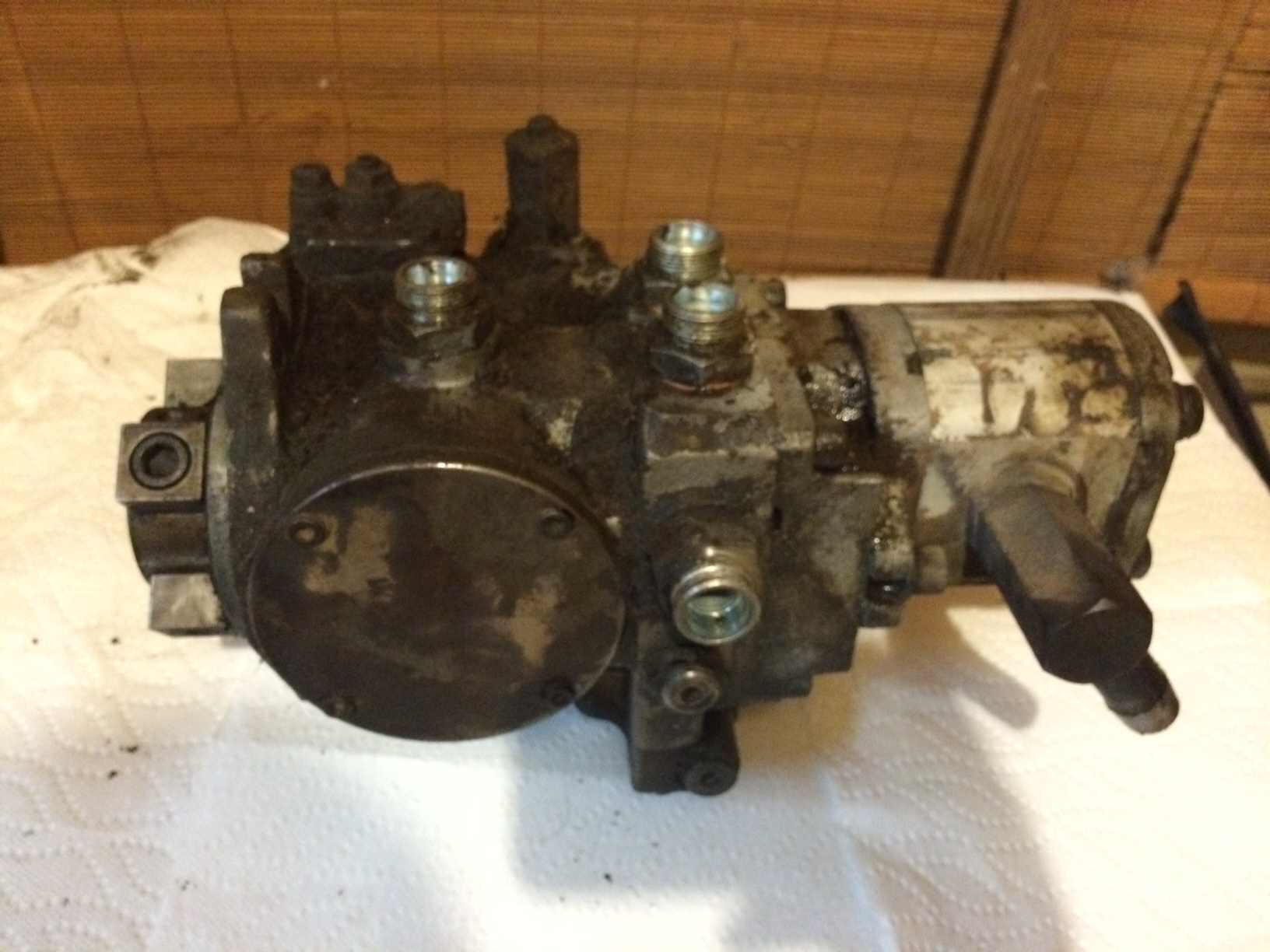

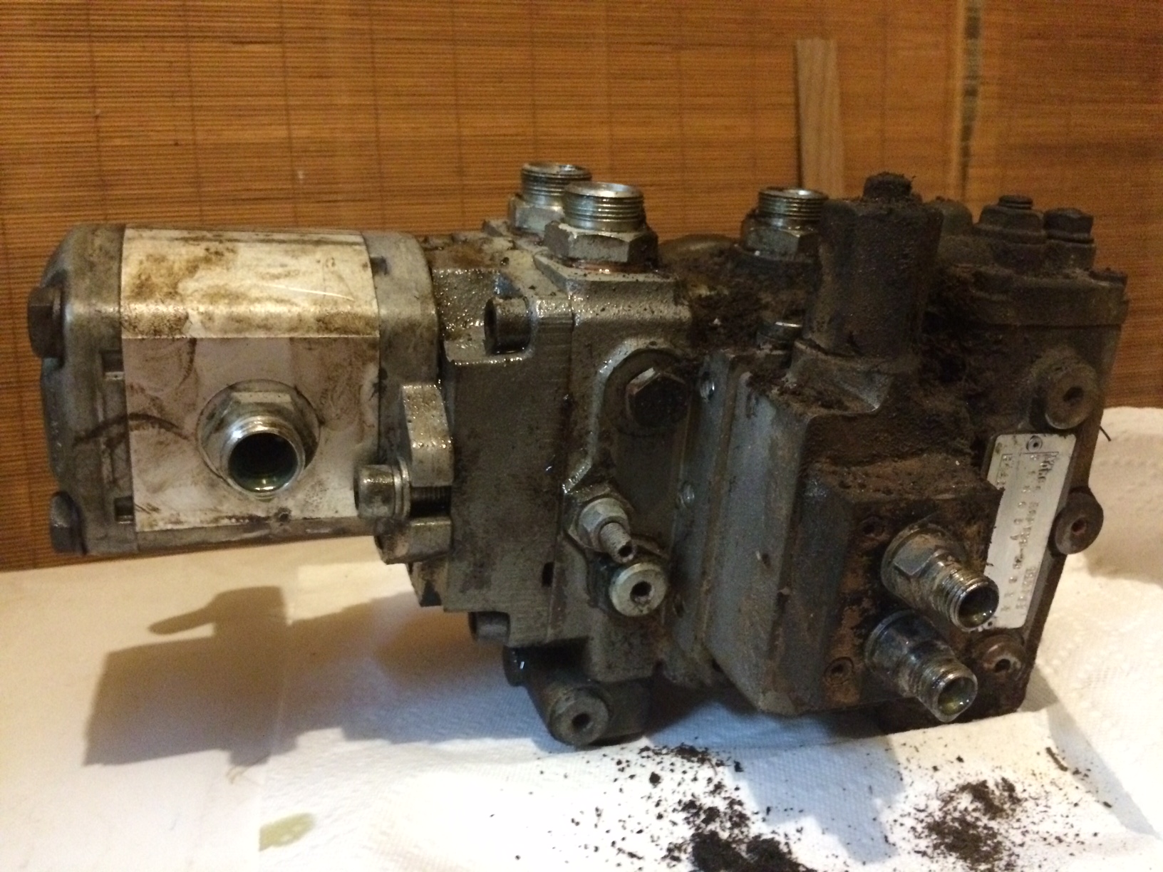

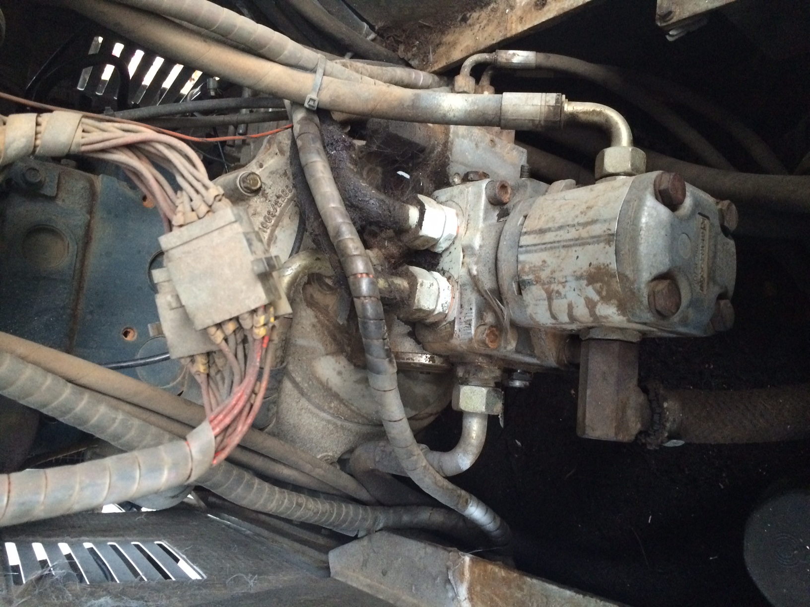

Ok, I pulled the pump today and have determined that the pump is made by Bondioli and Pavesi (Italian company), but fortunately there is a branch of the company in Virginia. I called the company and told the guy my model number and he said it's still in production, and that they would be able to check the pump out and diagnose it for free. He said I would have to get with my local distributor (in my case Hydradyne out of Charleston, SC) and have them send it back. I called Hydradyne and he said that they do their repairs in house. Either way sounds good to me and I am planning to send it to them tomorrow. No word yet on a price, but hopefully it wont be near as much as a new pump. I have attached some photos to this post that may help others having this same issue. My machine is a 1999 Earthforce EF-2 loader/backhoe. The pump model number is in the photos. IMG_1979.JPGIMG_1989.JPGIMG_1988.JPGIMG_1987.JPGIMG_1986.JPGIMG_1985.JPGIMG_1983.JPGIMG_1981.JPGIMG_1980.JPGIMG_1990.JPG

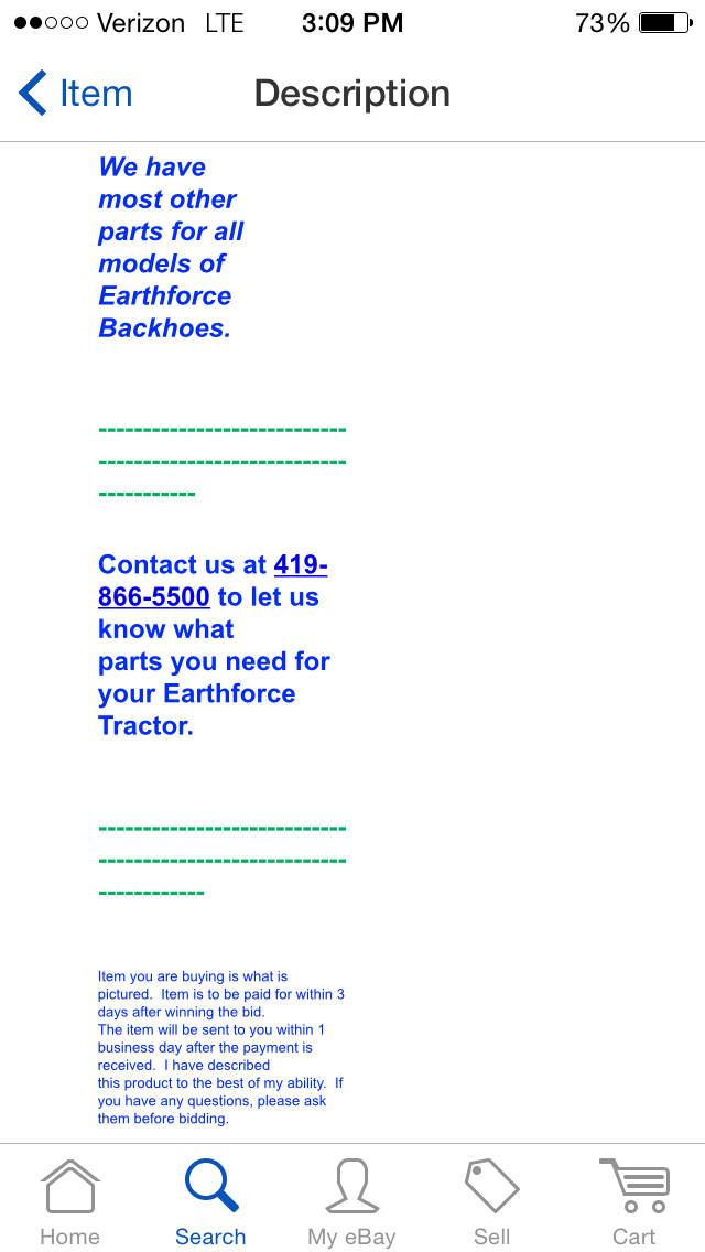

Through my research on these pieces of equipment, they are almost exactly the same machine as a TRAILBLAZER backhoe loader. There is a guy out of Ohio that I had spoken to a while back named Greg who said he can get almost any parts needed for them. I will attach the contact info for him to this thread. Hydradyne LLC can do all of the hydraulic pump rebuilds. They didnt want to take the pump off the machine, but I removed the pump and took it to them and they were able to rebuild it and test it. So far no problems and that was a few weeks ago.
