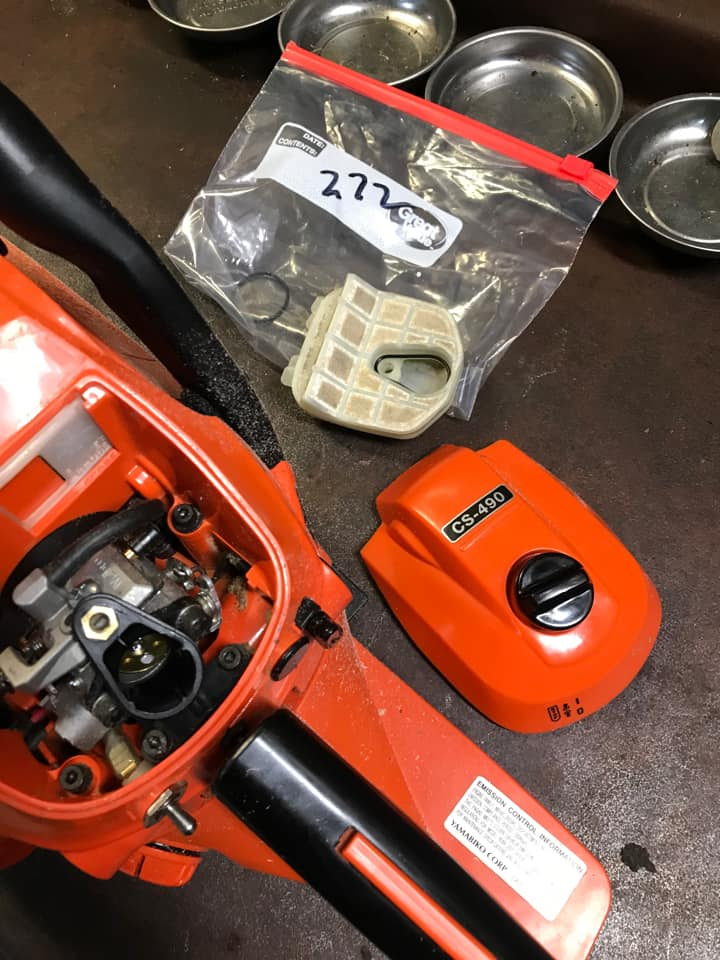

I hate to be that guy, but my lightly used Echo CS 490 won't start. Running when put away, now, nothing. I have spark- and new spark plug. Won't even fire when dosed with ether starting fluid. Kill switch is working properly. I'm at a loss. The gas isn't a problem- other chainsaw is working fine. Any suggestions are appreciated!

Update: still won't fire or start, after putting a bit of 2-cycle oil in cylinder and fresh pre-mixed fuel. Air filter on or off, no change. No more ether, although I spoke with a neighbor who does use it occasionally for his chain saws- and he's a retired engineer who worked with a military application drone company that used a lot of small 2 cycle engines, so he knows small engines. Anyway, I am now thinking I will pull the carb and clean it. I haven't squirted ether directly into the cylinder, and I won't, although that could rule out a carb problem.

I found a video on YouTube where the guy had exactly the same situation as me- except he went a step further and pulled the muffler to squirt ether into the cylinder directly, after which it fired. Blocked carb! I removed and cleaned the carb, and since it didn't appear to be gunked up in any way, I was holding my breath. Fired and ran on the first pull. Hardest part was getting the needle valve/spring assembly back together. It's running like a champ now.

You got it, jonconner. I posted earlier that I removed and cleaned the carb. Although it appeared clean, something was clogged. Runs like a champ, once again.
