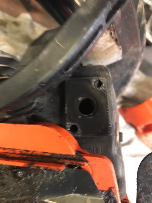

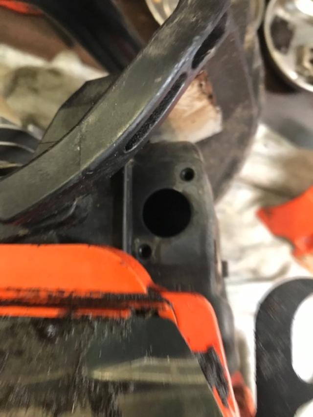

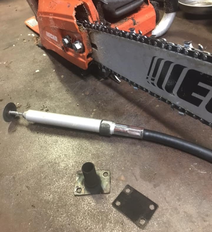

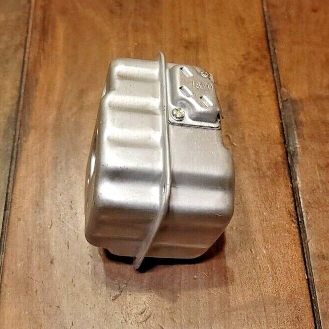

Muffler mod is a must on these. Their muffler is so restricted. Takes you around 10min to 30min if never done it.
/ Echo CS-500P any good #5
My 490 muffler looked like this. Guessing 500P does too.
Remove that deflector and pop that little piped restriction out and toss it. Then put deflector back on or go 1 step more and open front of deflector up like I do. Retune carb then.

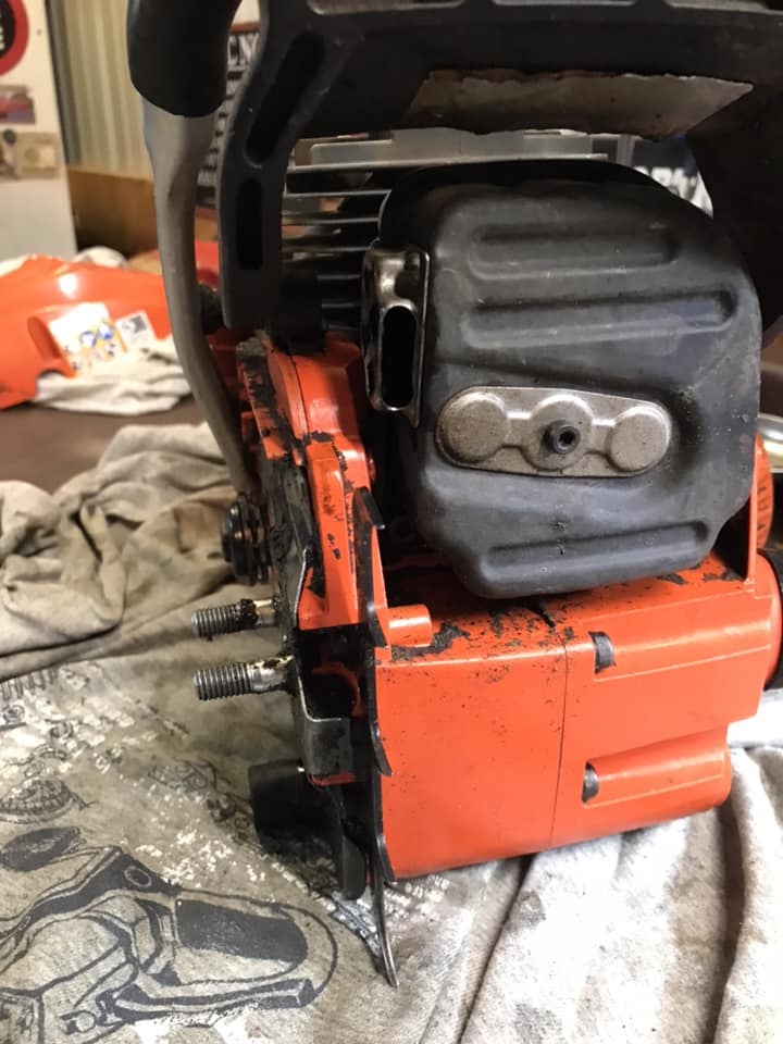

You sir were not kidding, that stock muffler was super restrictive! They cheapened the muffler up a bit from your pictures as mine doesn't have the "bolt retainer plate" and the outlet baffle is like the top picture of the new muffler with just the small slit on the front facing side and the three louvered baffles. I ended up taking tin snips to the baffle and adding another slit and folding the whole thing out, of course left the spark arrestor screen in place. But man did it wake the thing up! It can breathe now! Throttle is super responsive...

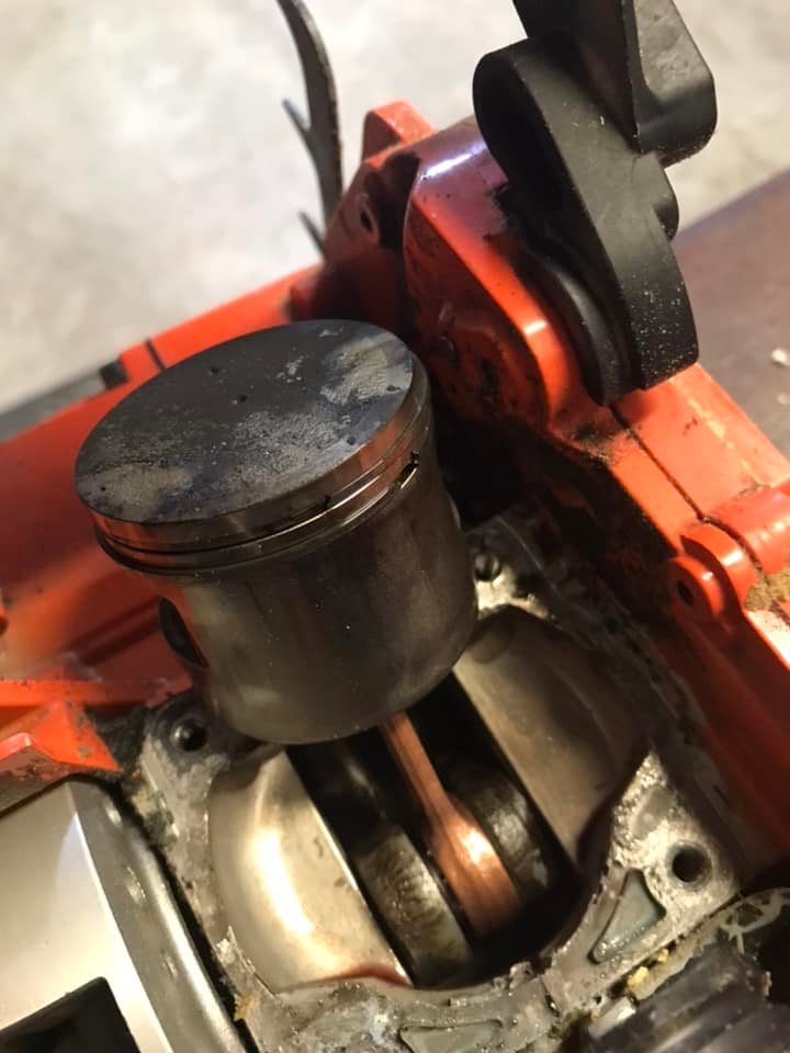

On the plus side I took the muffler off to do this since I couldn't get a screwdriver to the bottom screw but in doing so I saw the shape of the piston and cylinder walls, they're cherry, look pristine and new, it has an Oregon chain on it that doesn't look like it's had a round file to it, I wonder if they didn't put an hour on it and just keep it around... super glad I jumped on this thing...

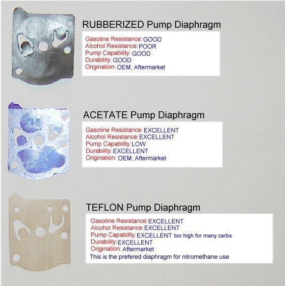

I like tan 1st, black 2nd. Then blue only if I have no other choice. Black before blue always if I have a choice of the 2 when brand new.
Tan best all round, black next best IMHO for flow.

You didnt remove the outer deflector to remove the inner small restriction pipe? Just 2 screws hold outer on on older muffler.
Watch opening the sides like it sounds like you did. Will blow hot exhaust right on the plastic brake handle and possibly melt it when being used alot.
Reason for opening the front of the deflector.
Then my newer 501 muffler on how I do front deflector after remving that little inner pipe.
View attachment 4079945View attachment 4079946
I did basically like your bottom picture but just with a simple clip with tin snips and pliers to fold the flap out, left the flap to keep the exhaust going forward, the louvers on the side I left alone.
On the pump diaphragm it had the black but since it didn't run right I didn't trust it, felt stiff at first and was kinda grody on the carb side... I have a gross of parts on hand so all 3 were available but found the blue first in an open kit... brown is my preferred as well.
