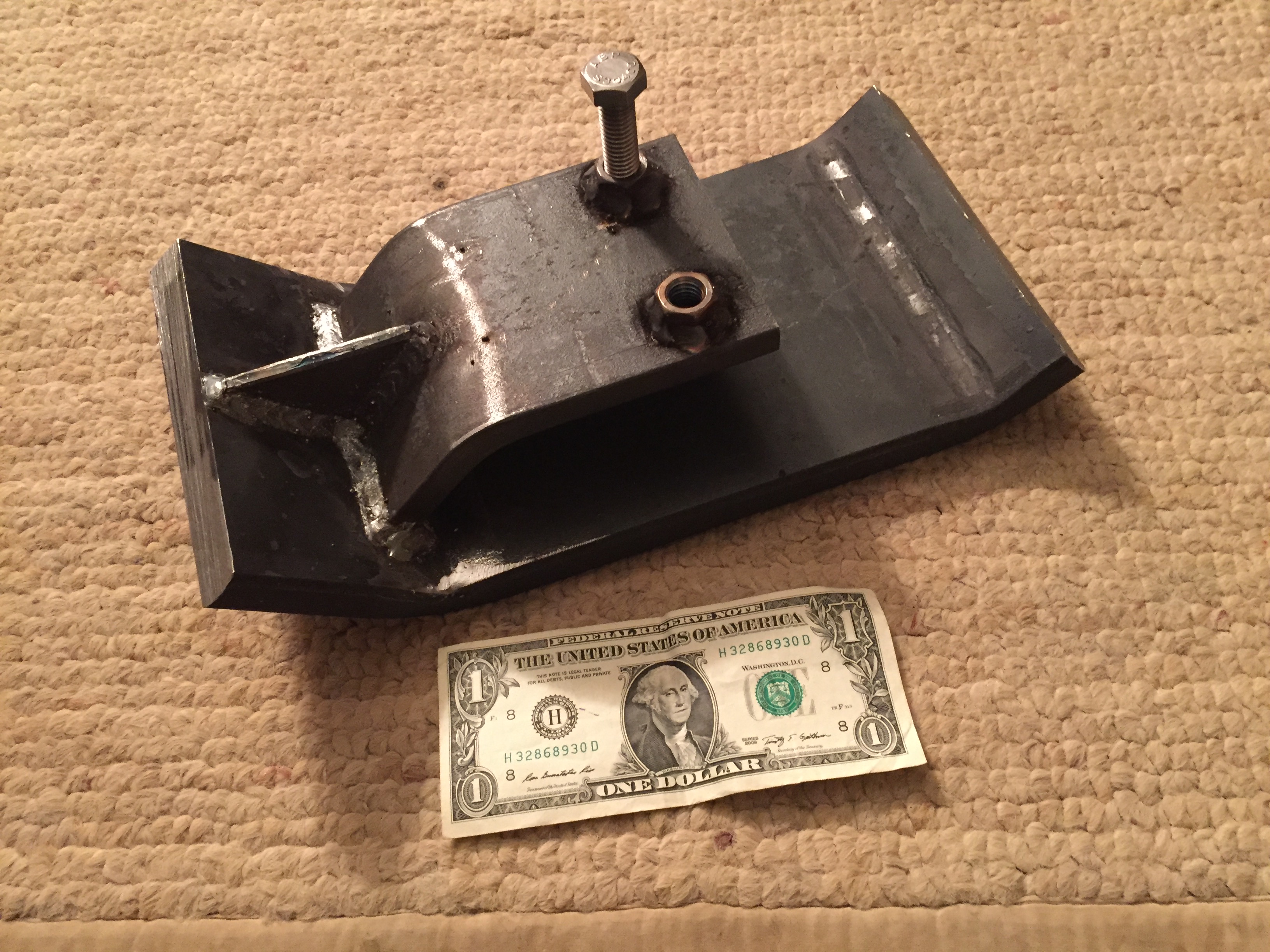

Got the brackets from the fabricator on Friday. Don't know what they costed me because I have an account with them. I'll post up when I get the bill. Put the brackets on right away, just in time for a 8" snow. First one of the season so there was no base on the gravel. The shoes worked really well where the gravel was hard. Worked nicely for back dragging too.
The only time I saw gravel in the dumped snow was from an area where the gravel didn't have enough fines to lock in the top layer of stones. In this spot the shoes dug in and I scooped up a ton of stones. This only happened in the spots where the gravel wasn't locked in with the fines. Otherwise they worked great. Good enough that I might sell the box plow and stick with the snow bucket. I like the snow bucket because I can push the snow up hill which is something I could never do with the box plow.
Regarding the design, the brackets just barely fit, so be sure to test fit them on your bucket before finish welding. When tightening the bolts, there is a slight deflection to the 1/2" plate. This causes the first bolt to loosen while the second one is being tightened. I'd suggest going with a thicker piece of steel, fabricating a longer brace, using a single 3/4" bolt or just tighten the bolts several times. As designed, the brackets never moved even when back dragging so the last option is workable.
