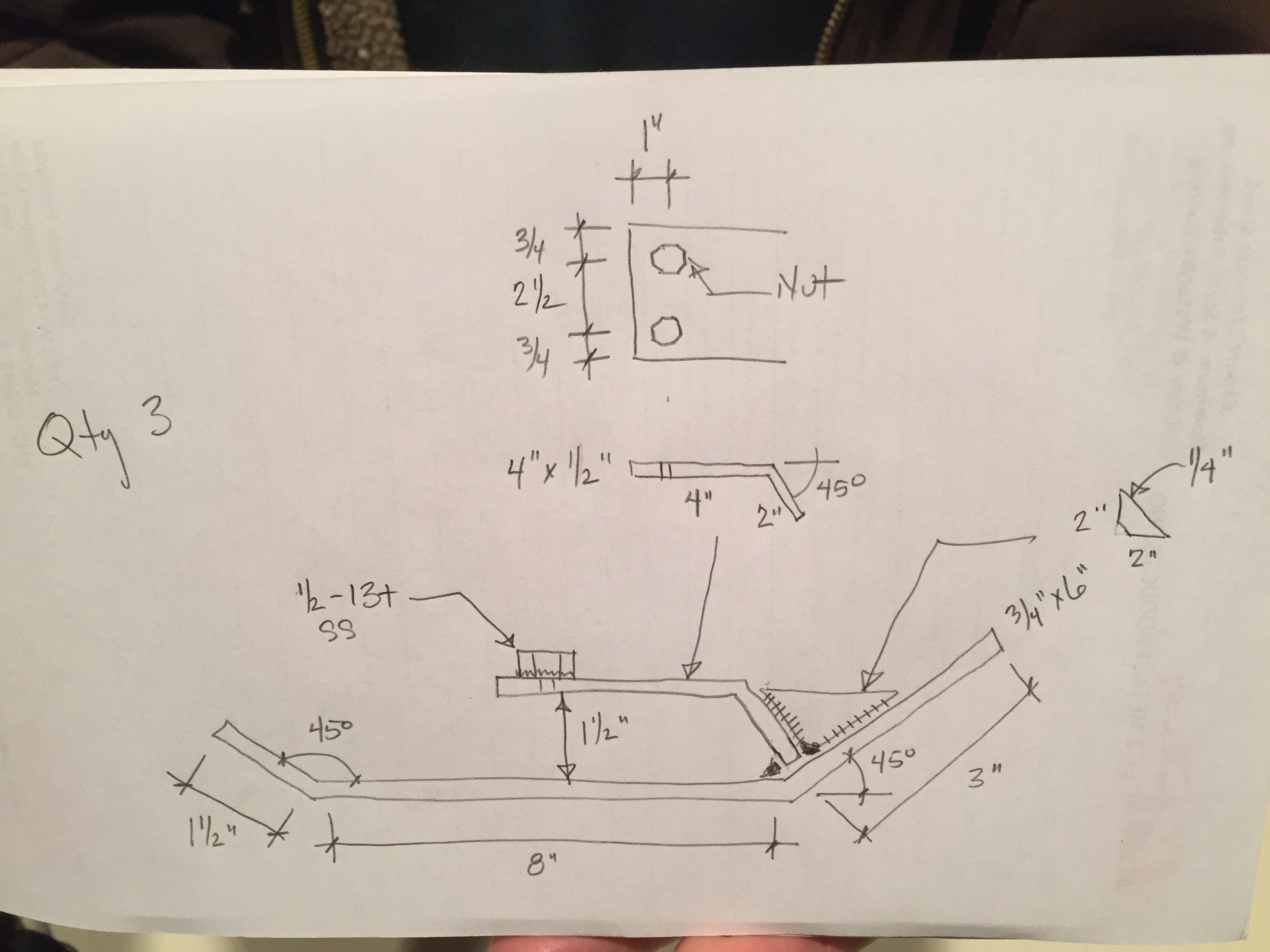

Well, I gave up waiting. Drew this up the other day and it's over at a fabricator for bending right now.

What did the fabricator quote you for cost?

LOL, I have a similar sketch on my desk as we speak.
Rather than farming out bending I cut about 1/2 way thru and hammer the bend in my vice and then weld the cut closed.
I have done this on even 1/2" flat stock and it works just fine.
