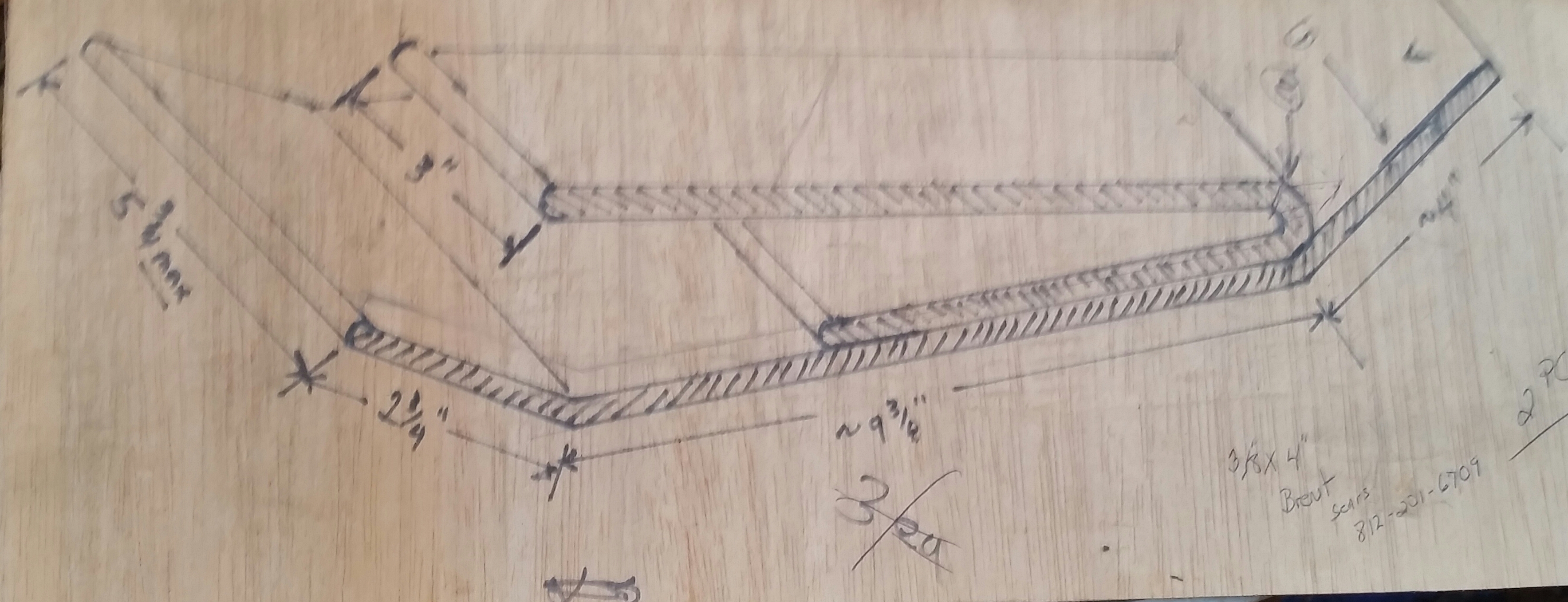

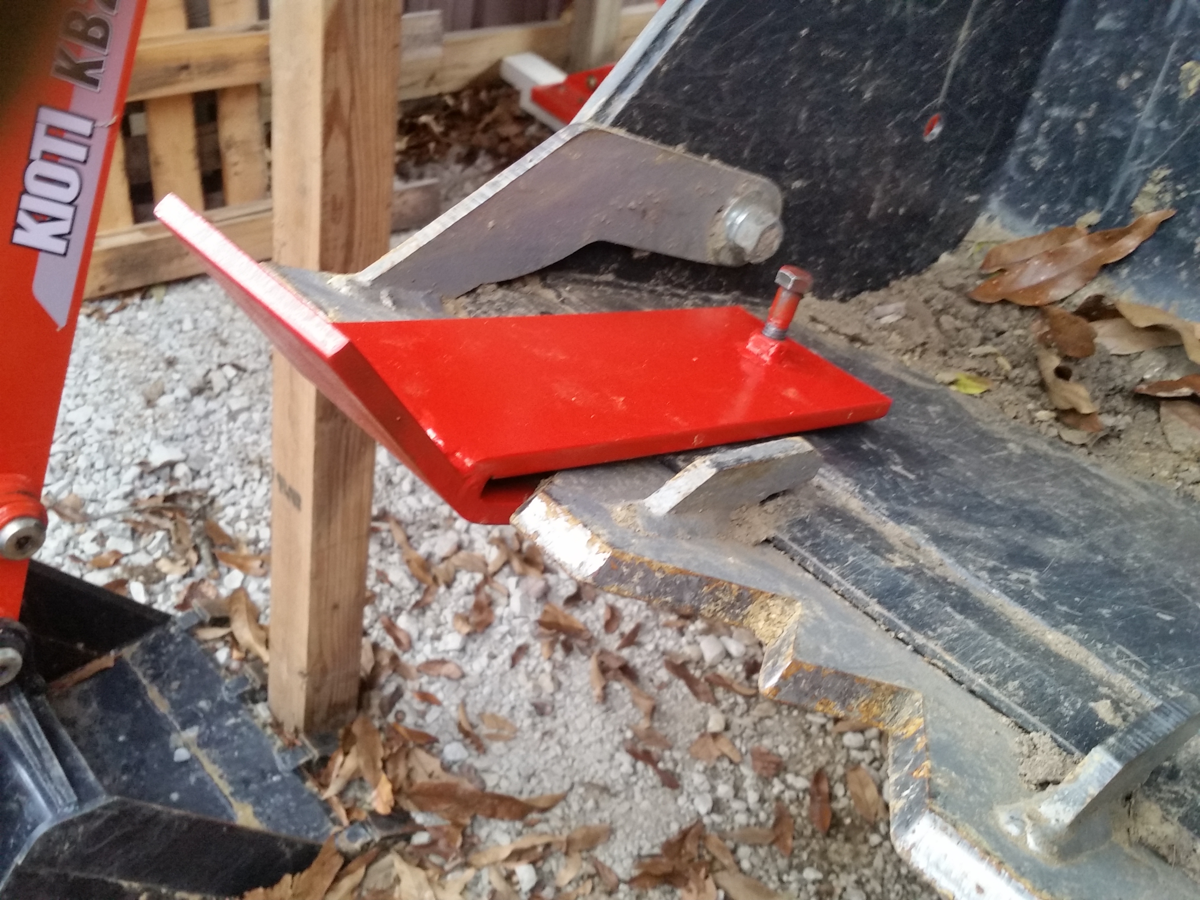

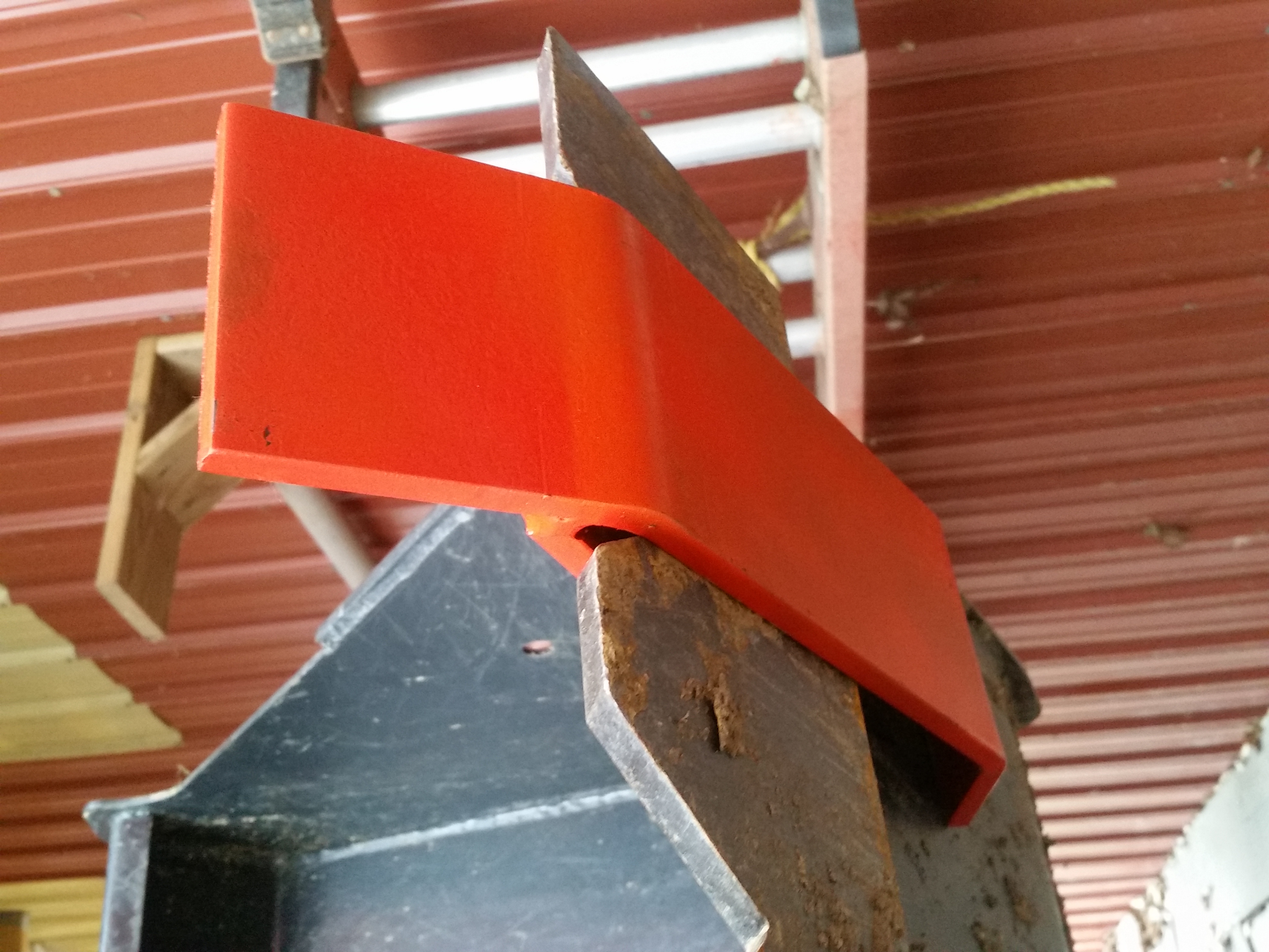

Couldn't bring myself to spend that much even though they may be worth it so I decided to fabricate my own. My criteria was I didn't want to remove my piranha tooth bar. So I took wood from my cabinet shop and fabricated one until I got proper fit and then transfered to a drawing. The only modification from the drawing is I eliminated the metal U and opted to weld flat stock of the same width directly to the shoe. When I took the drawing to the metal shop they offered to bend it for me. So I then welded it, drilled the bolt holes and welded the nut on and then painted. Fit is nice and tight. Total cost was $35

Great job comancheflight.
