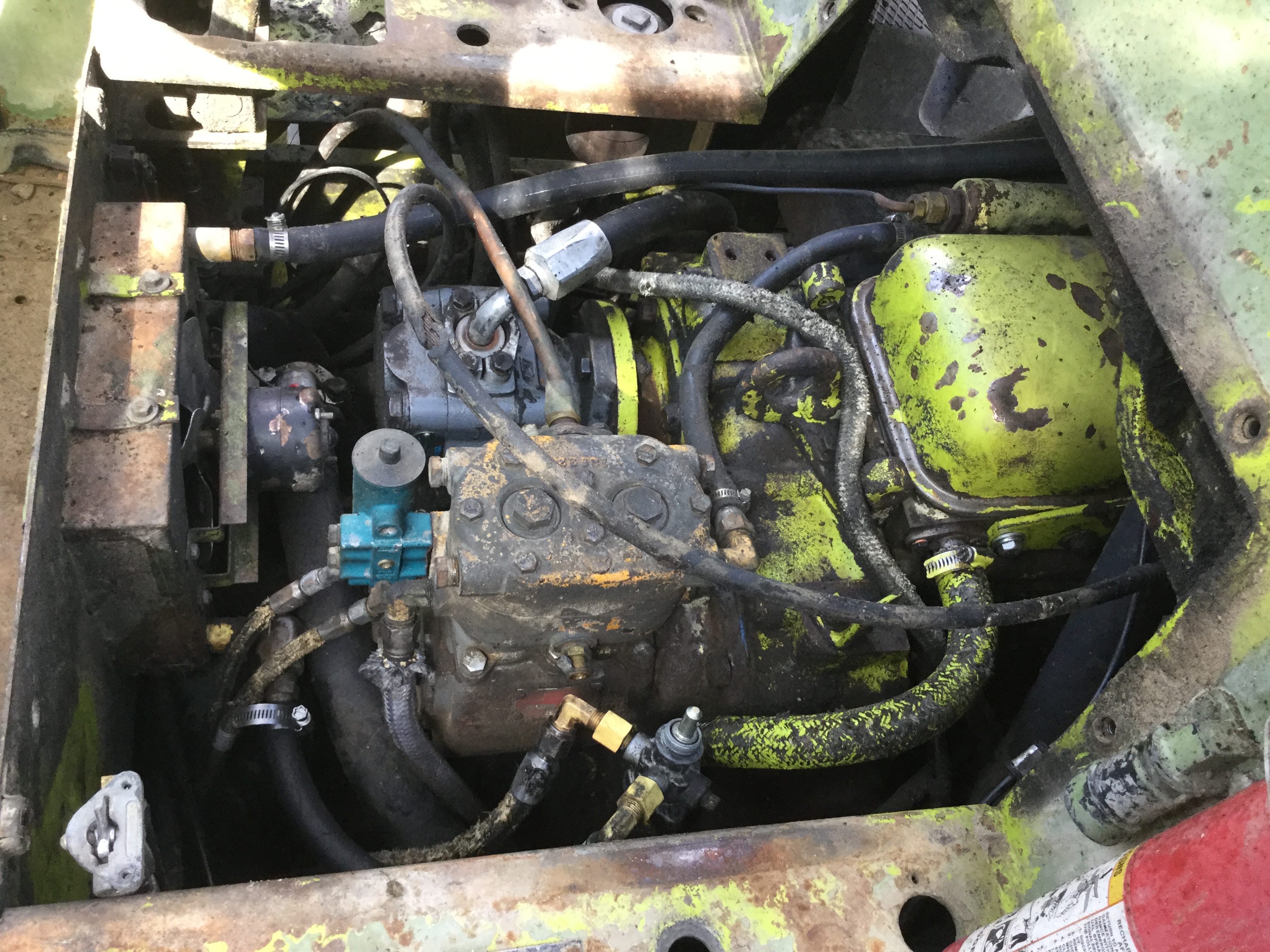

Nice old machine. Does it have a 2 cycle GM Diesel?
Yes, it's visible in some of the pictures. It's a 284 cubic inch four cylinder. Here's another angle, under the seat.

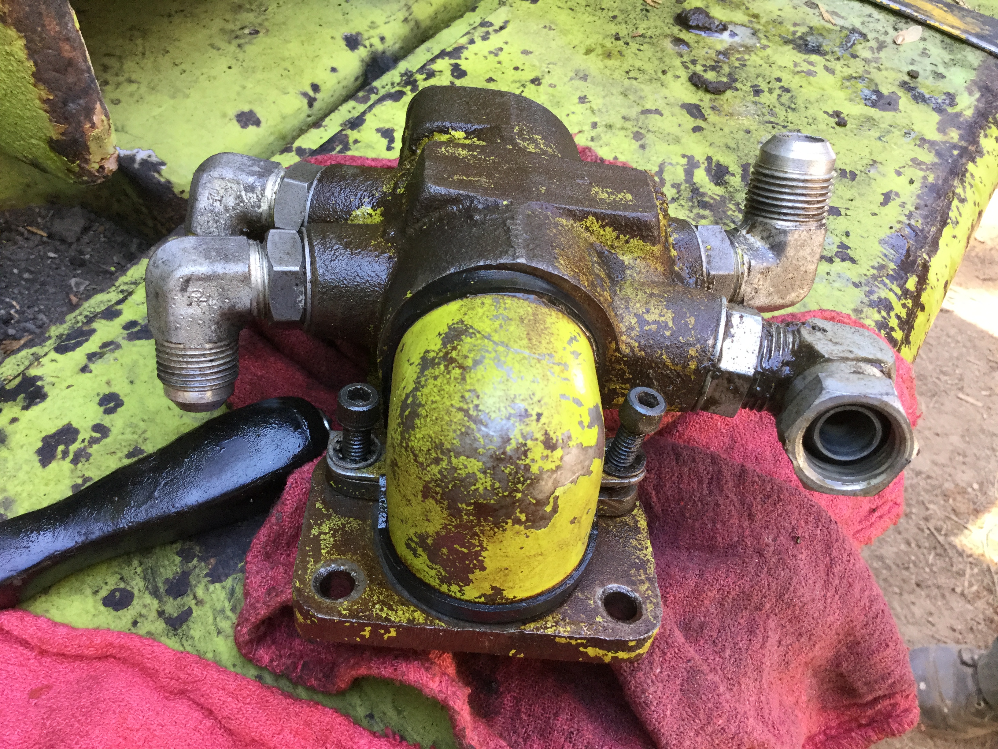

We put the new seals into the steering hydraulic control valve.

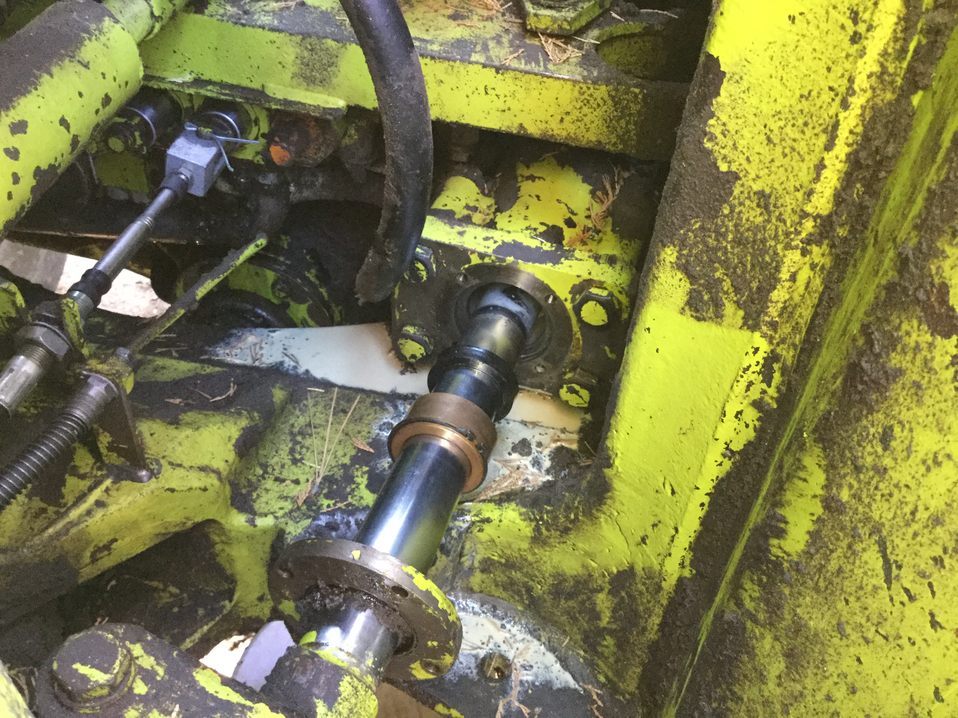

Thought we were gonna reseal the steer cylinders, but wrong packing. It came with the machine, doh! I have the right part number to order a seal kit for them. Need the bushings too, they're worn.

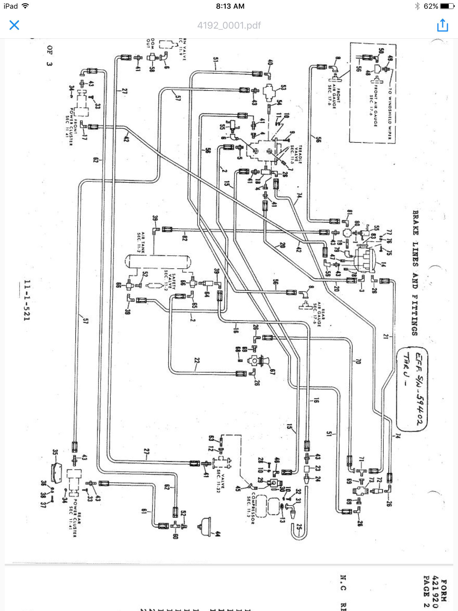

Got a schematic of the air brake system from Terex, we didn't have the right one before.
