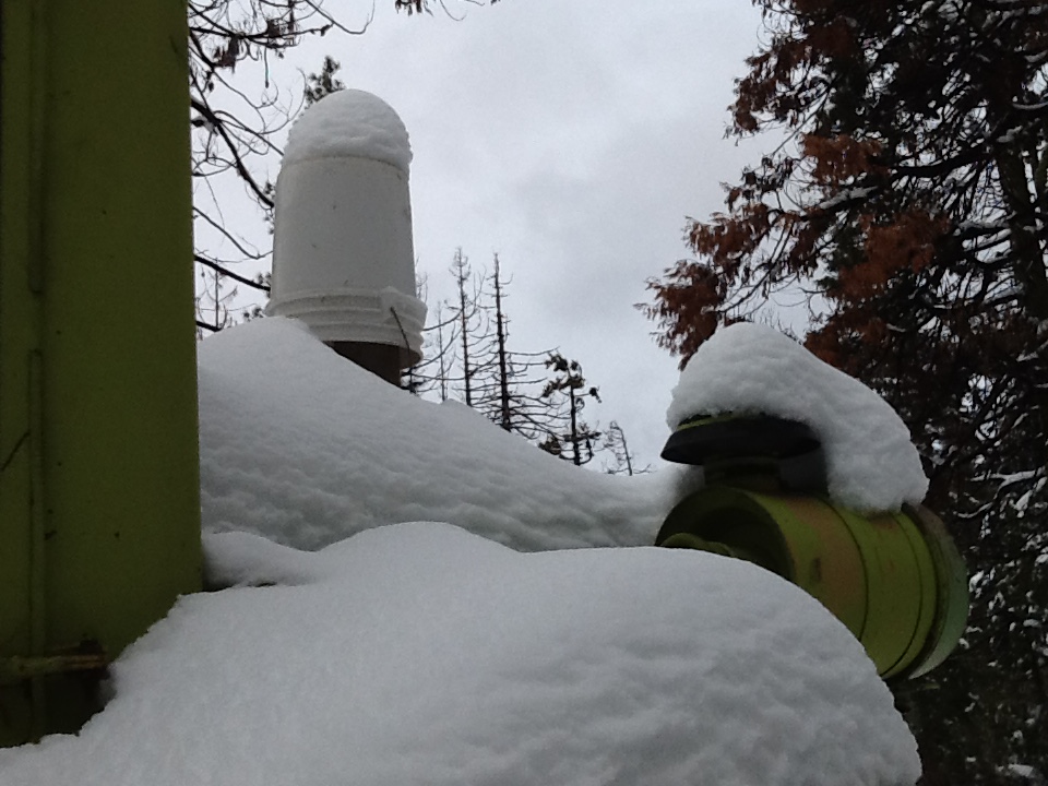

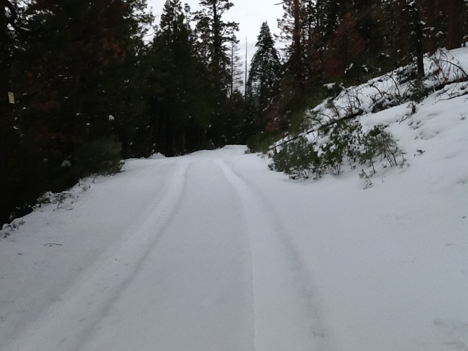

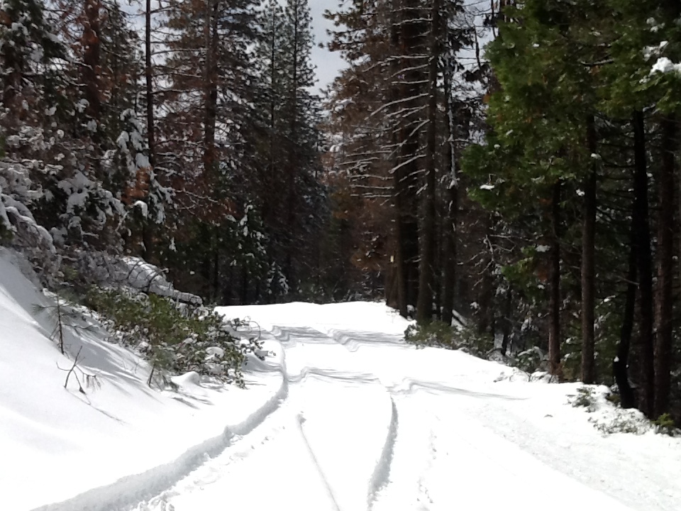

These pictures are from yesterday, a storm finished the day before.

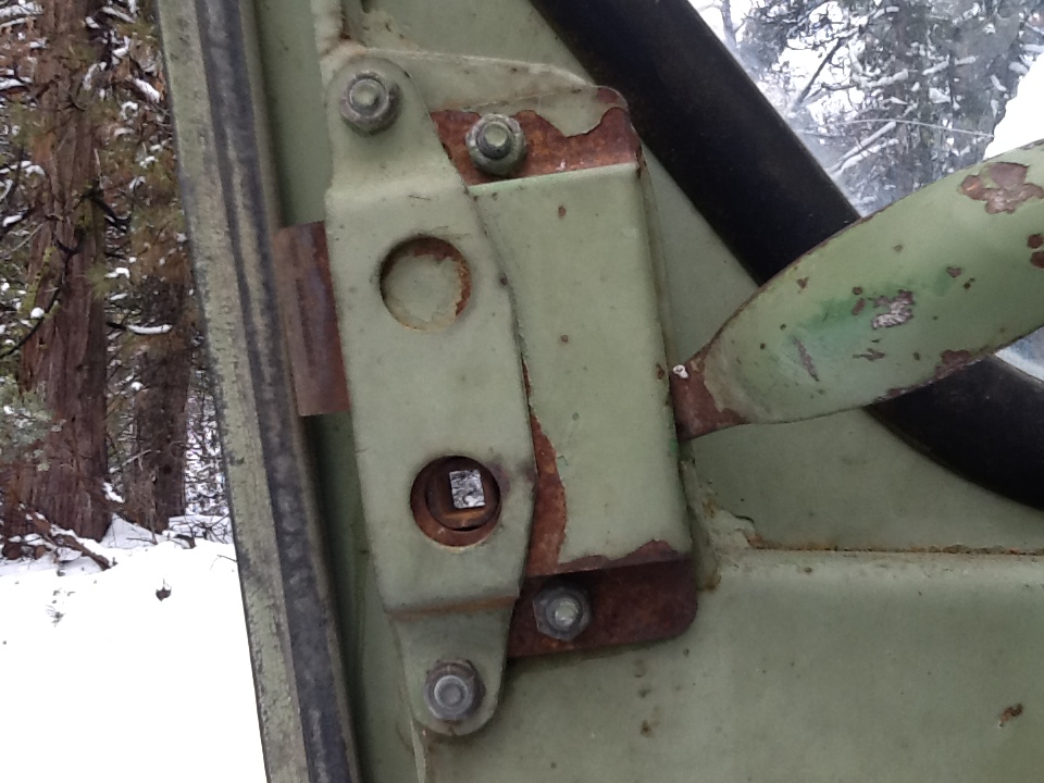

The locks I got will work, but will have to be modified. I didn’t take the truck all the way to the loader, because it’s a sloped shelf road and that might not go well in the snow. So I didn’t have power (inverter) to run the drill, didn’t think to bring the battery powered drill. Will need to bring a 1” hole saw next time too, to make more access to attach the screws.

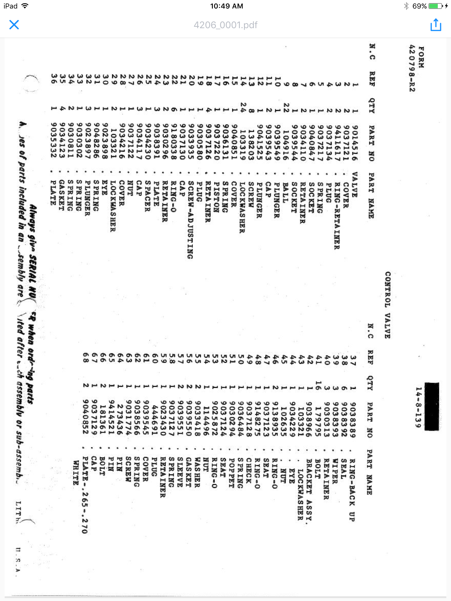

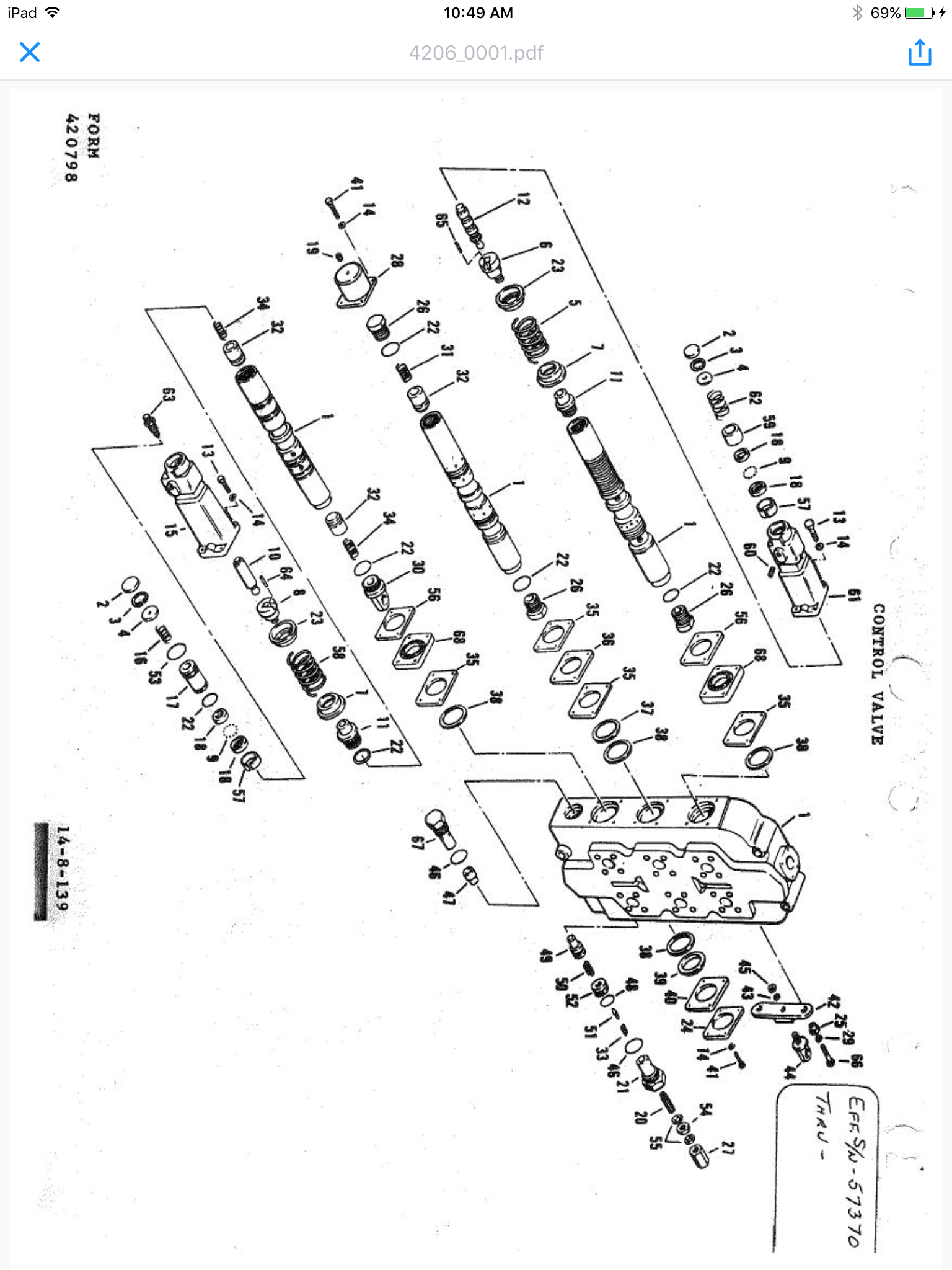

Does this make changing the spool valve o-rings look easier?
   / Ed's 77 Terex 72-41 Wheel Loader #49
NO. Spool valves are complex creatures.
I give you credit for getting in there...
#50
I tend to break things down. There are seven holes with parts in them, i’ll put six out of my mind and focus on just one. Then i’ll start to see a pattern and it gets easier. Plus my mechanic thinks he will be in good enough condition to go help, he’s healing from injuries. He likes that stuff, he has a reputation for rebuilding components all the other mechanics/shops want to replace whole.
