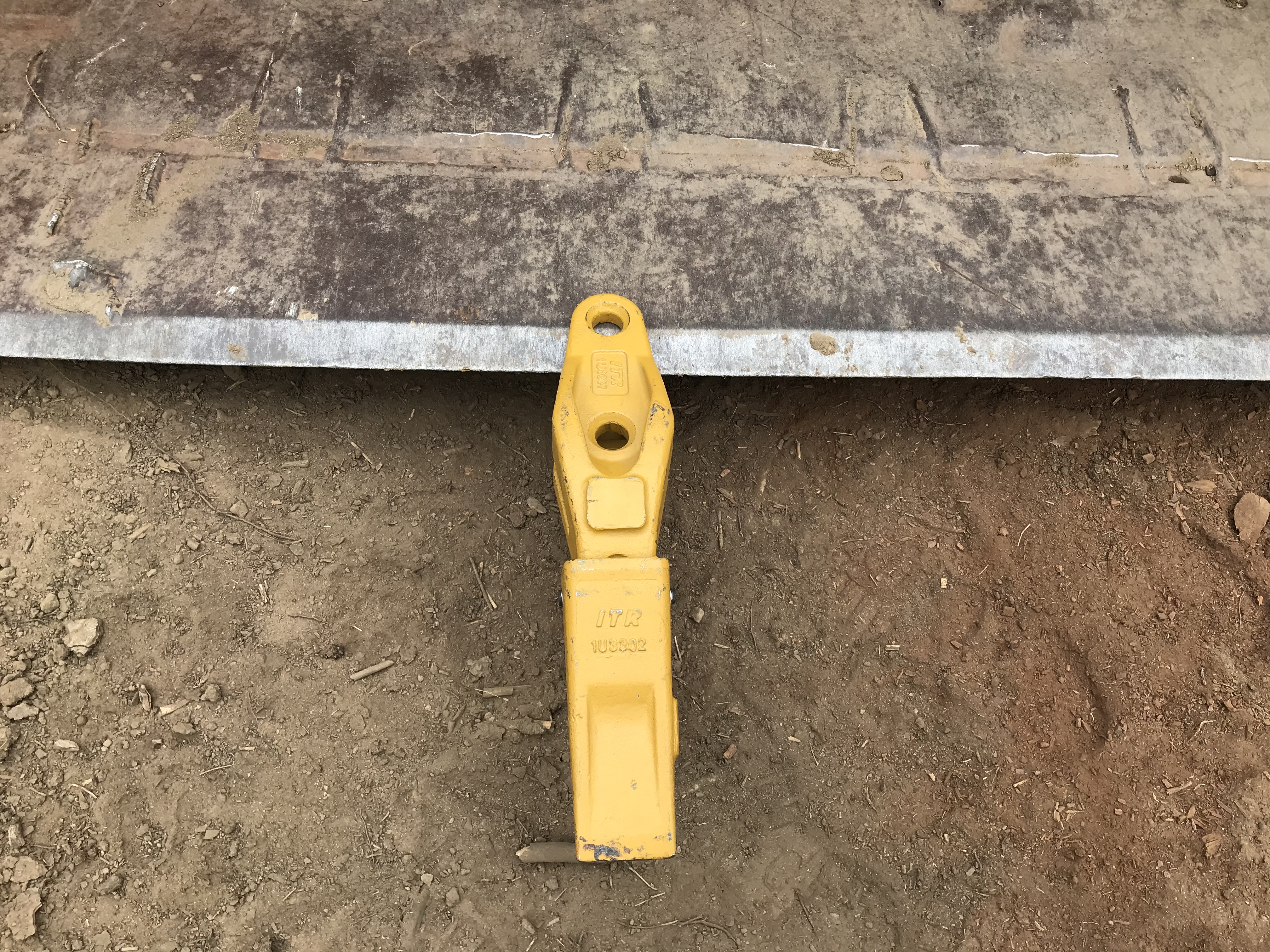

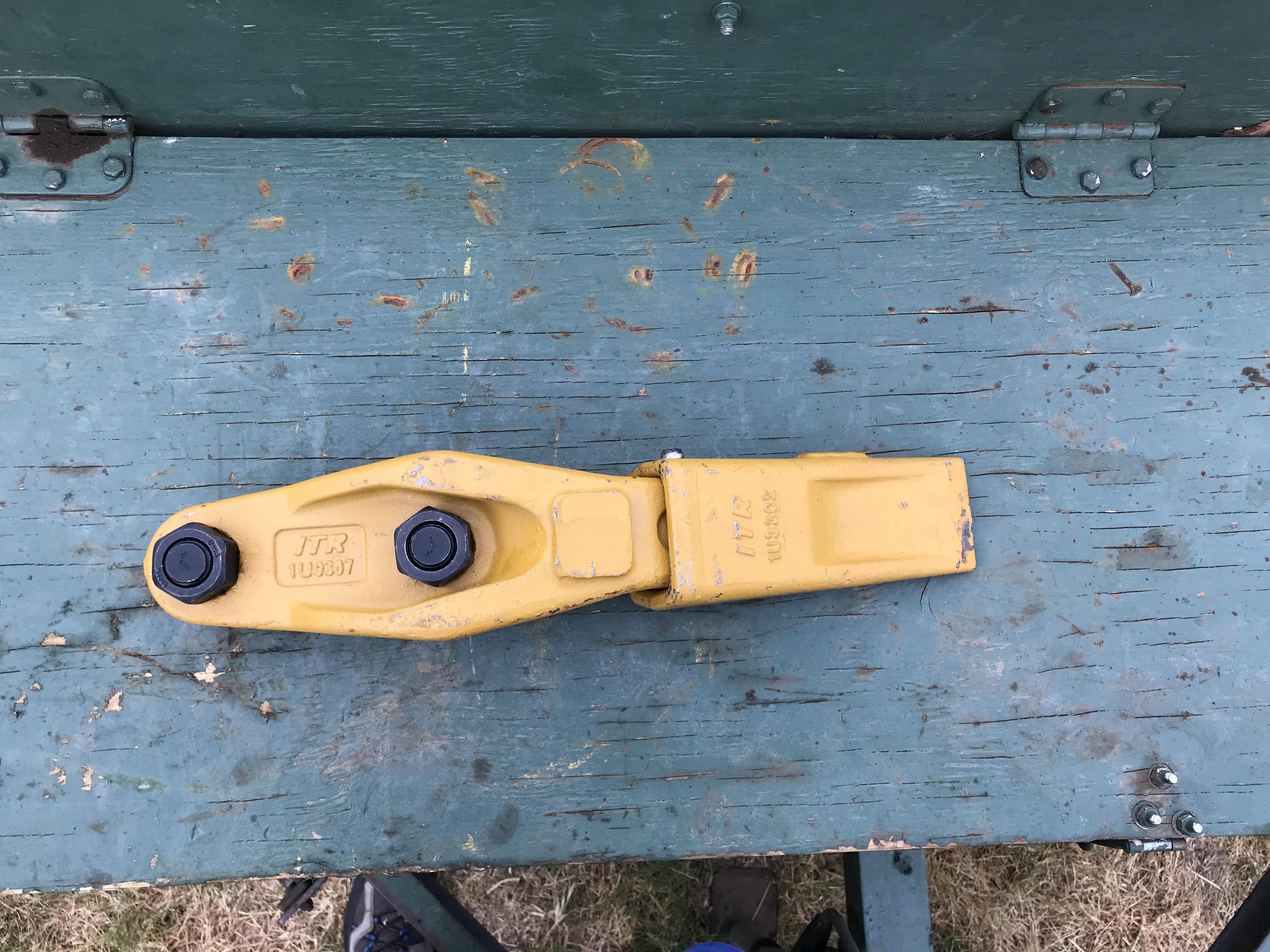

Got some teeth and adapters, still have to put corresponding holes in the bucket

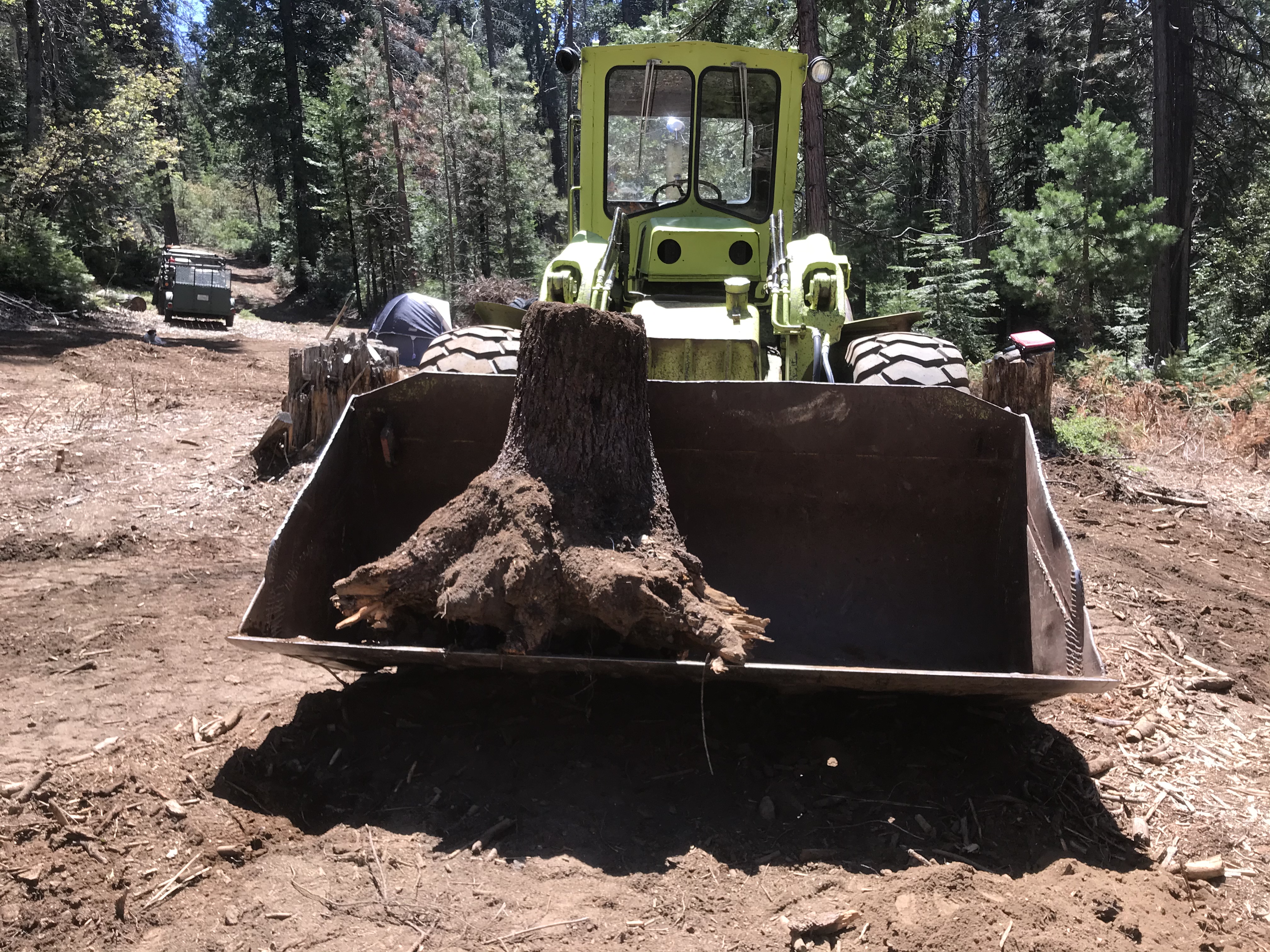

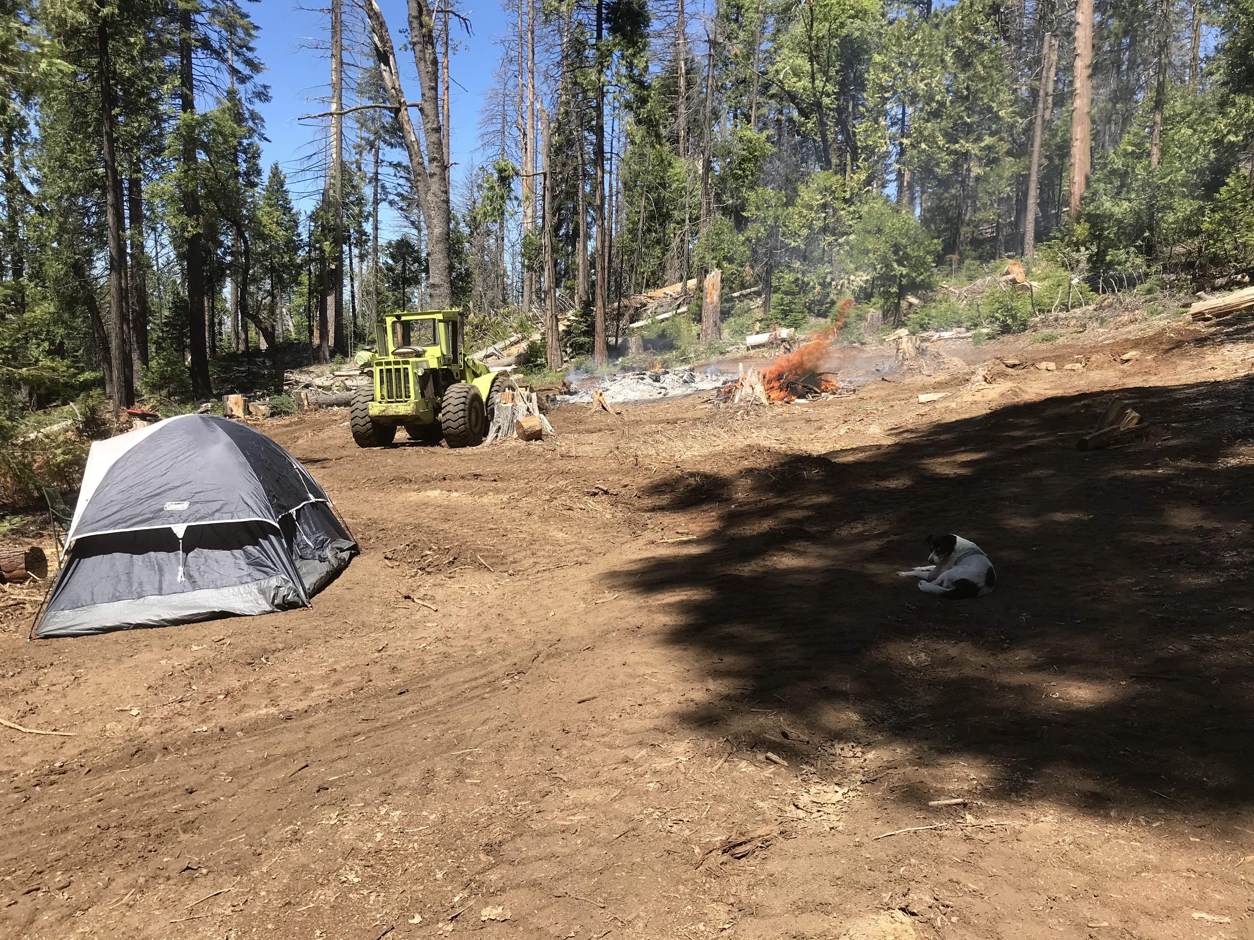

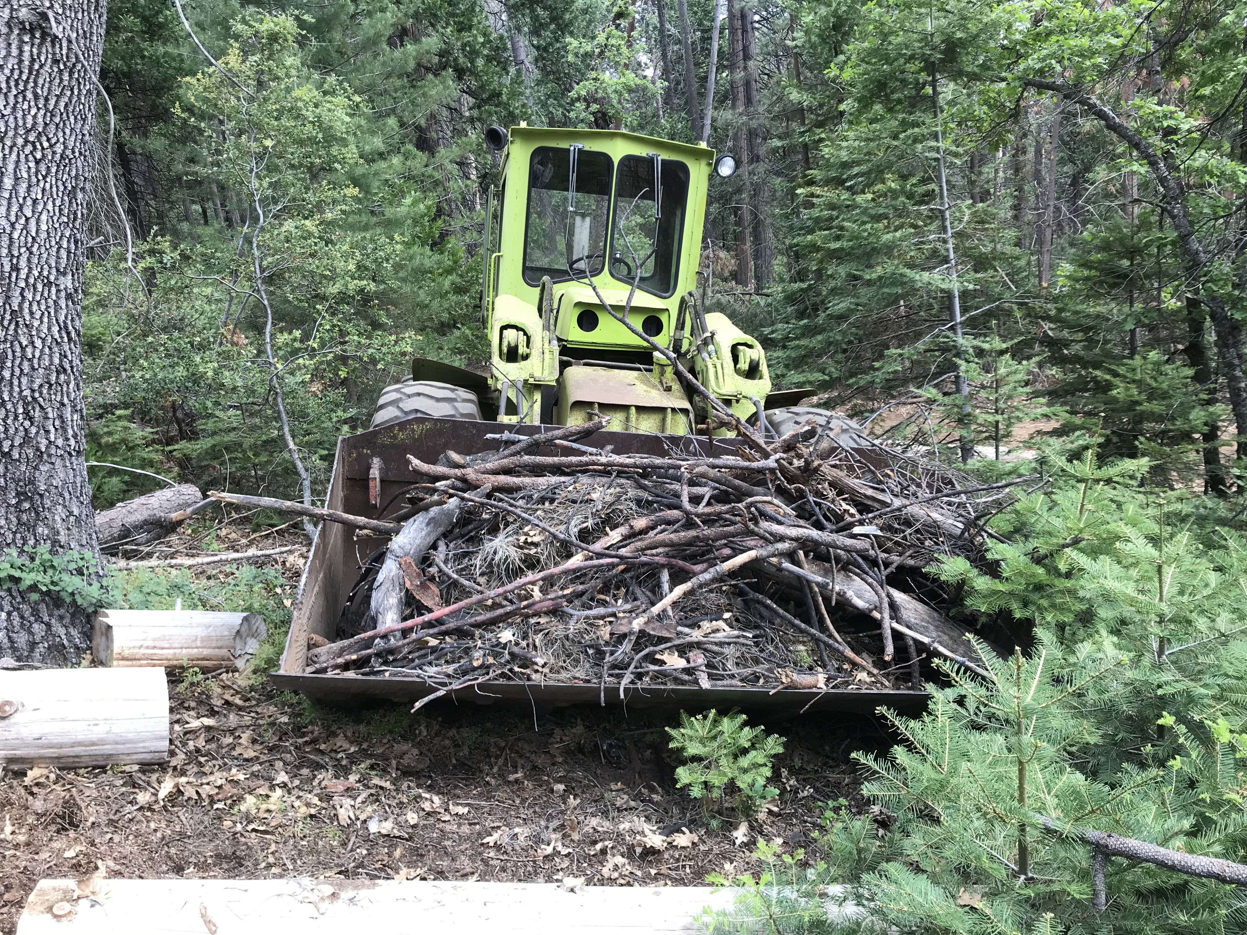

Used the loader to do some cleanup and burning.

#385
It starts in, so not much metal will need to be removed.

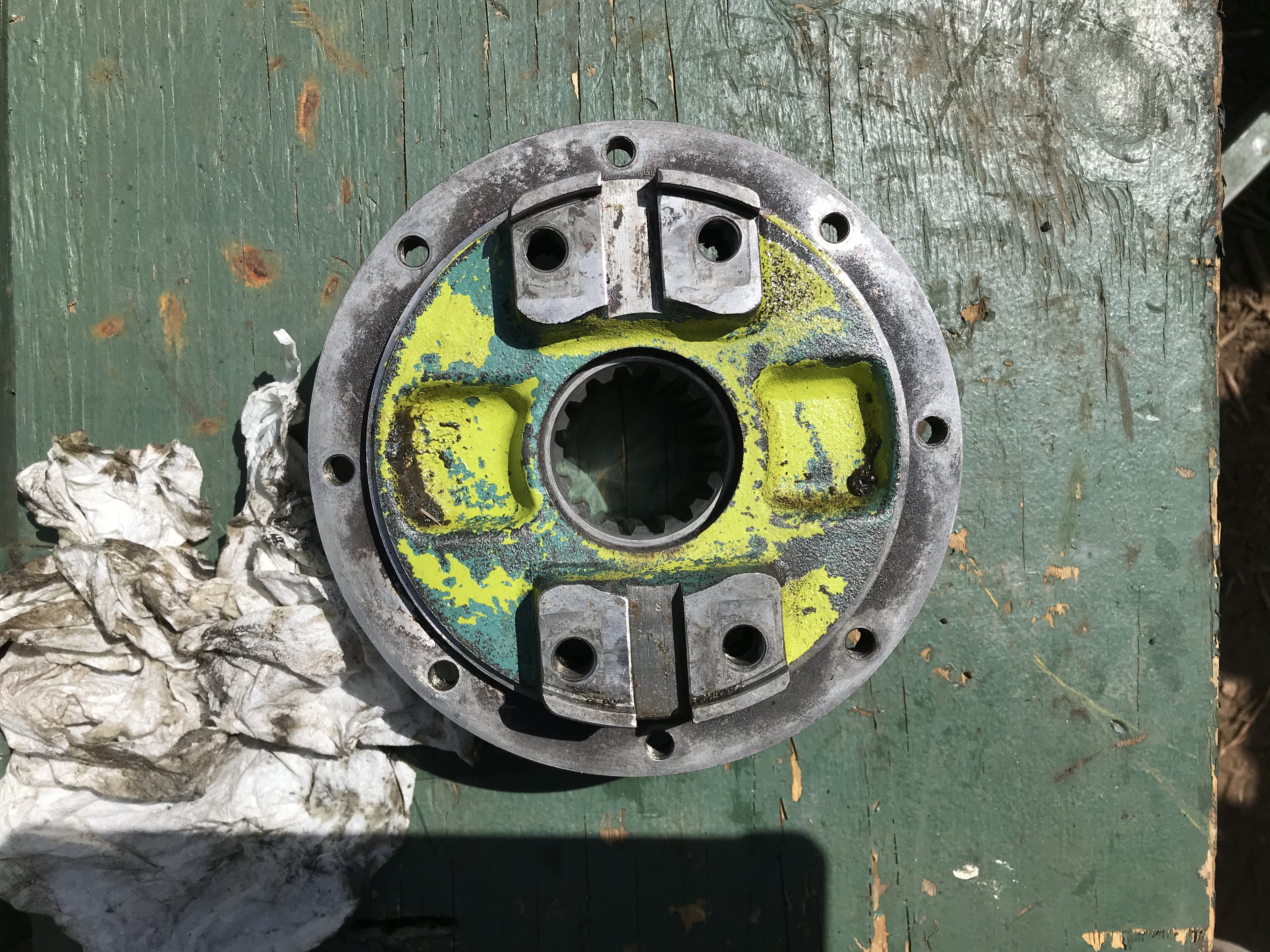

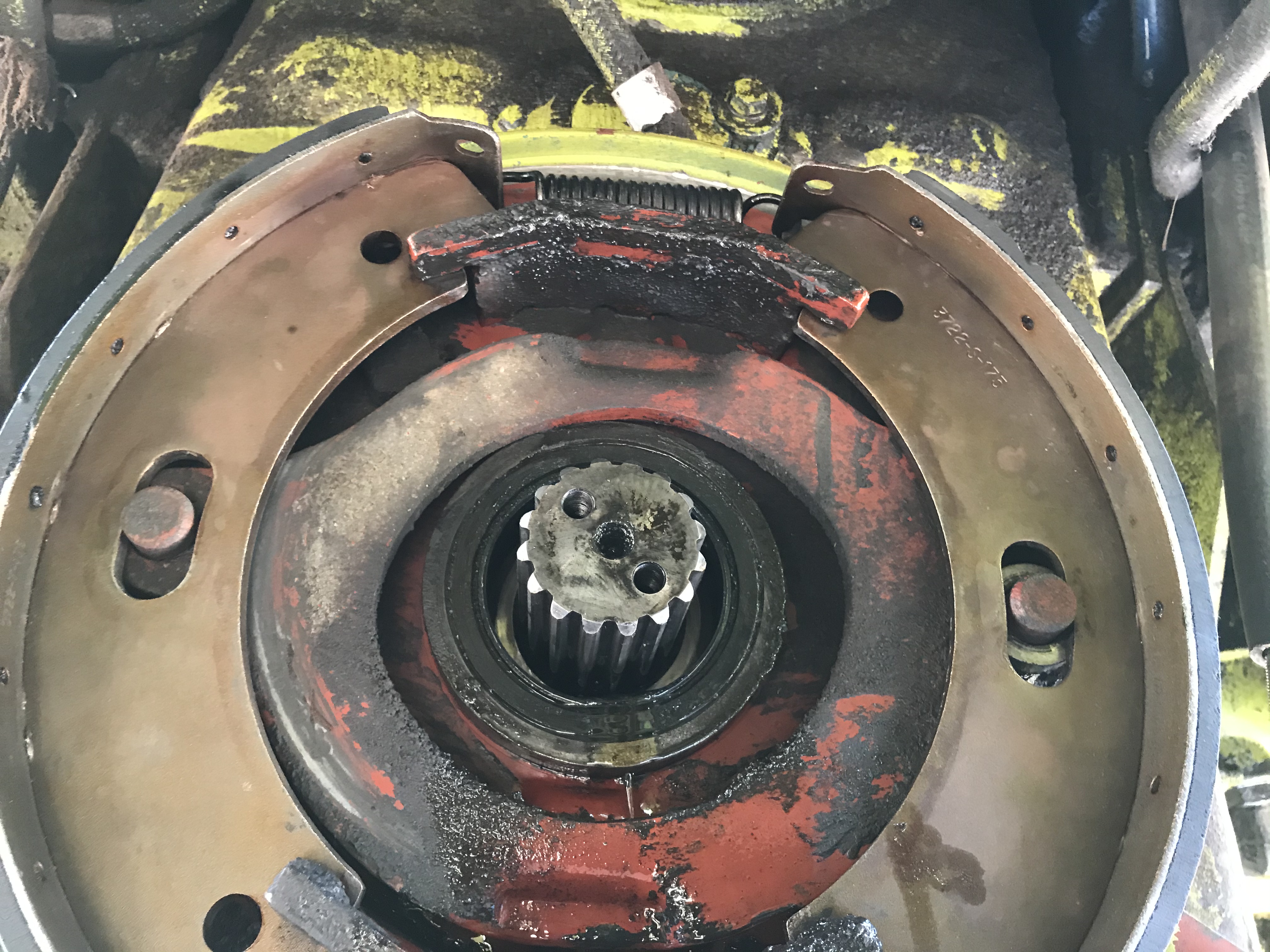

I went to replace the transfer case front output seal, but that was not the leak. One drive flange retaining bolt had the head broken off, the other was loose. That stops the oil that got by the splines. The other bolt head also broke off when I touched it. I think they broke from driving with the parking brake on, I have not made that mistake since. Went ahead and installed the new seal, since I was there and ready to do it.

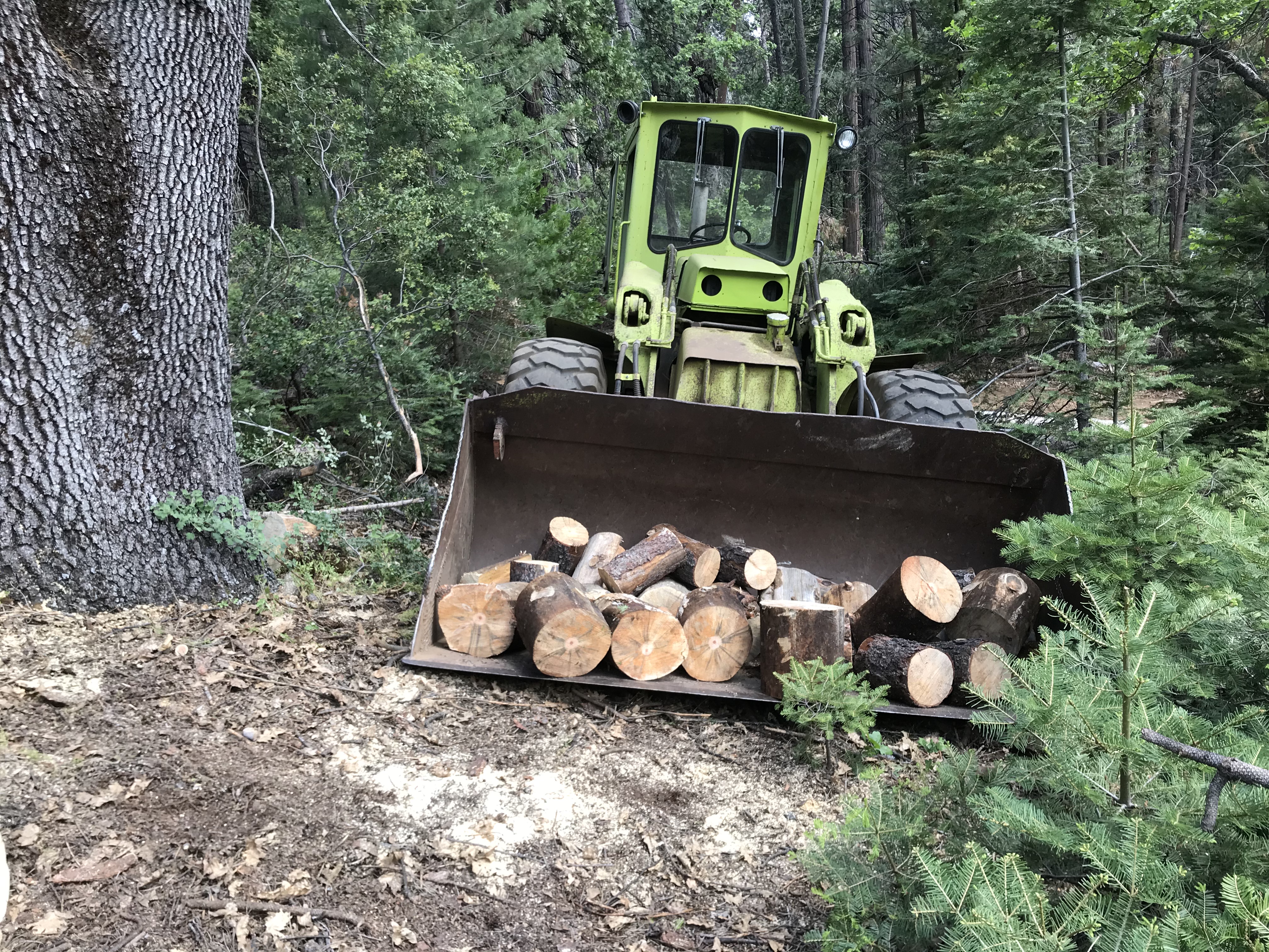

That was the only work I did, then I used it to get some more work done.

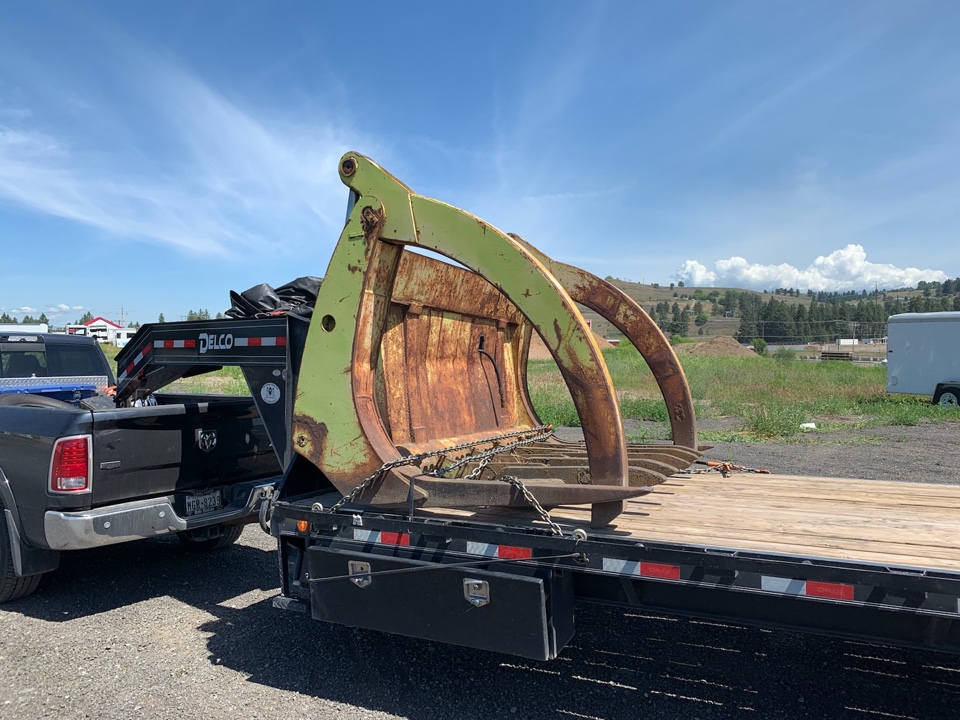

These are on the way.
   / Ed's 77 Terex 72-41 Wheel Loader #389
Awesome, it makes my Monster Grapple look small.
