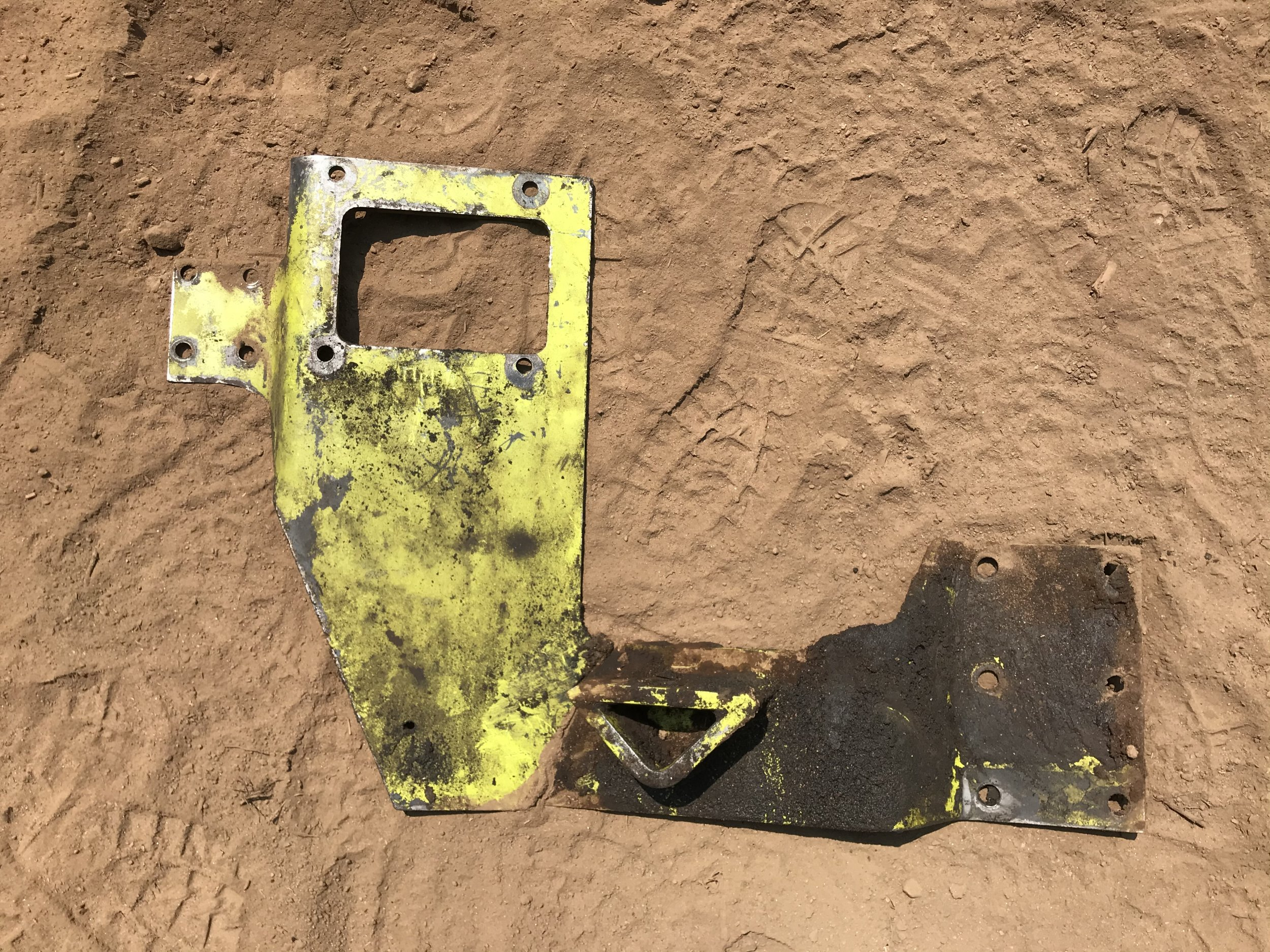

Removed the broken cradle, it holds both the engine and transmission. The triangular part goes in the frame.

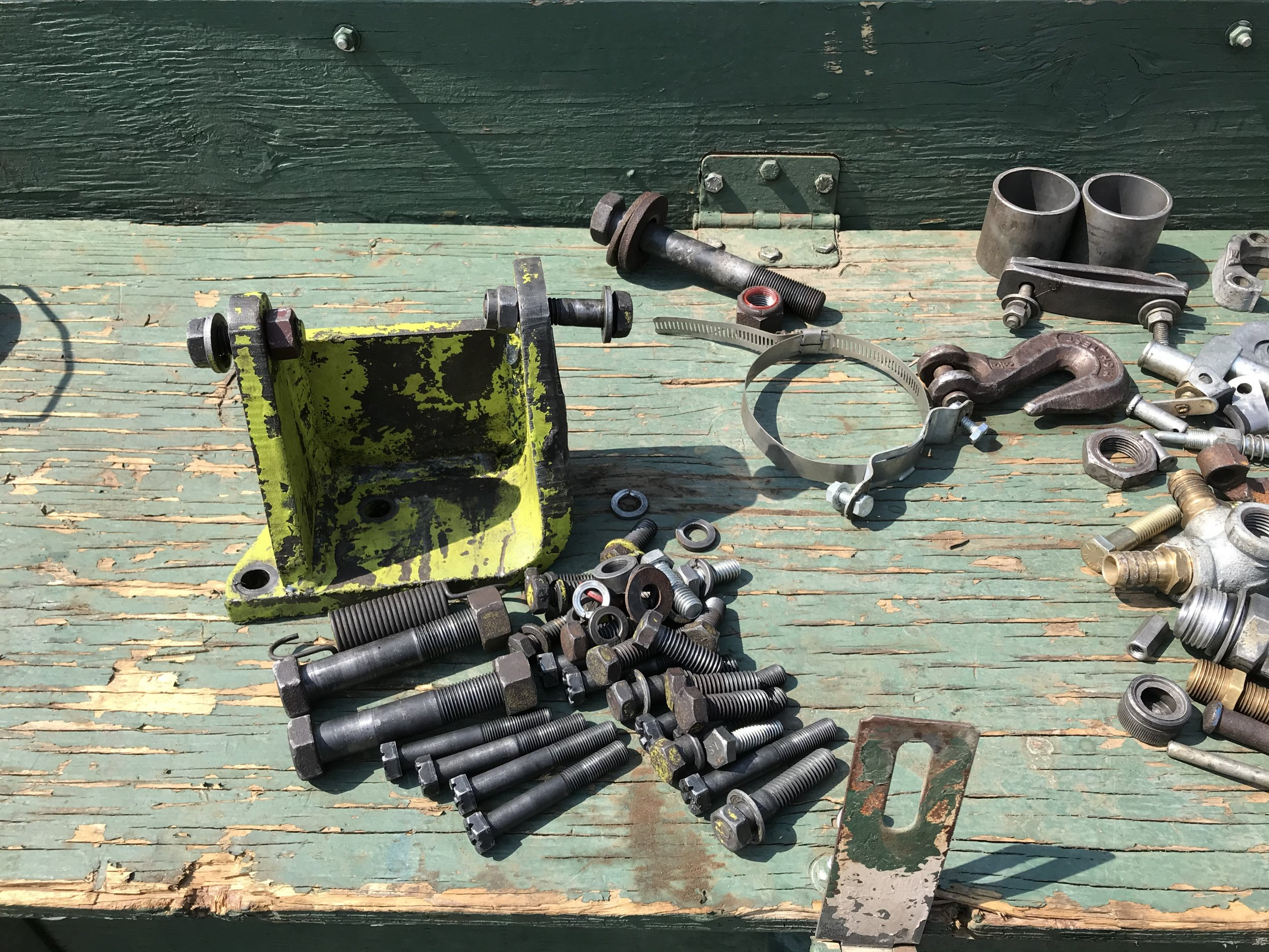

#503
I pressure washed and blew off the hardware, still need to wire wheel or grind some of the bolts.

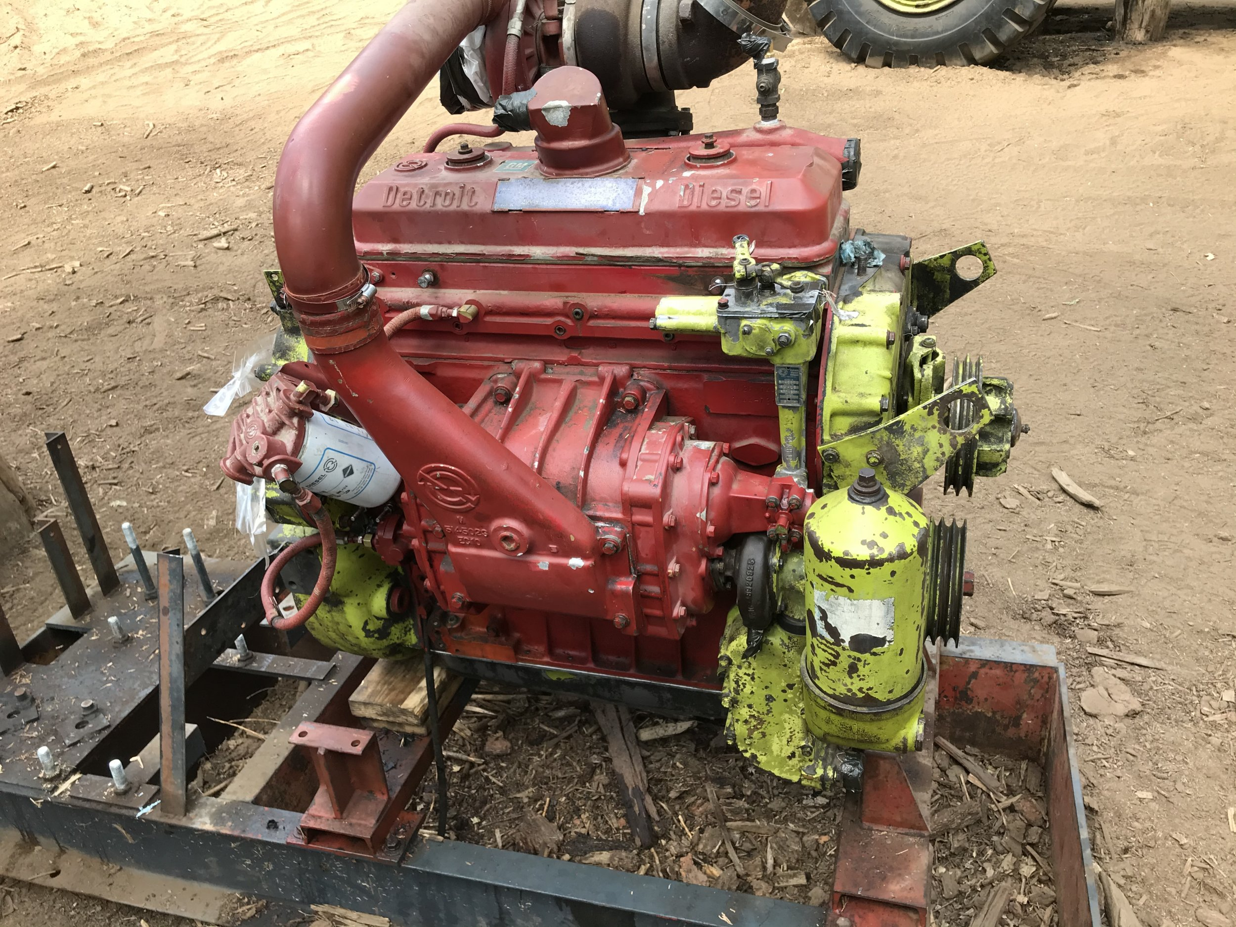

#507

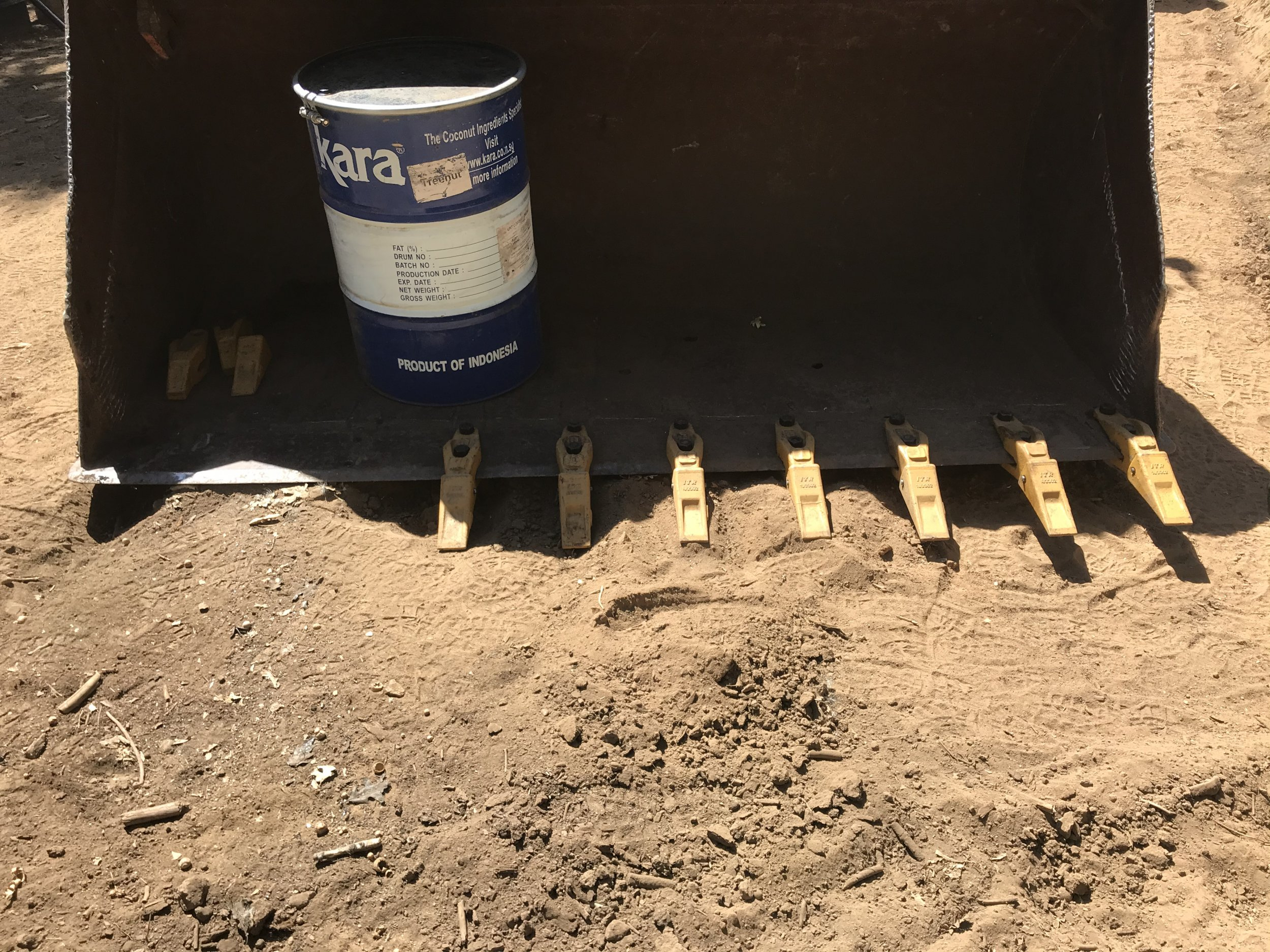

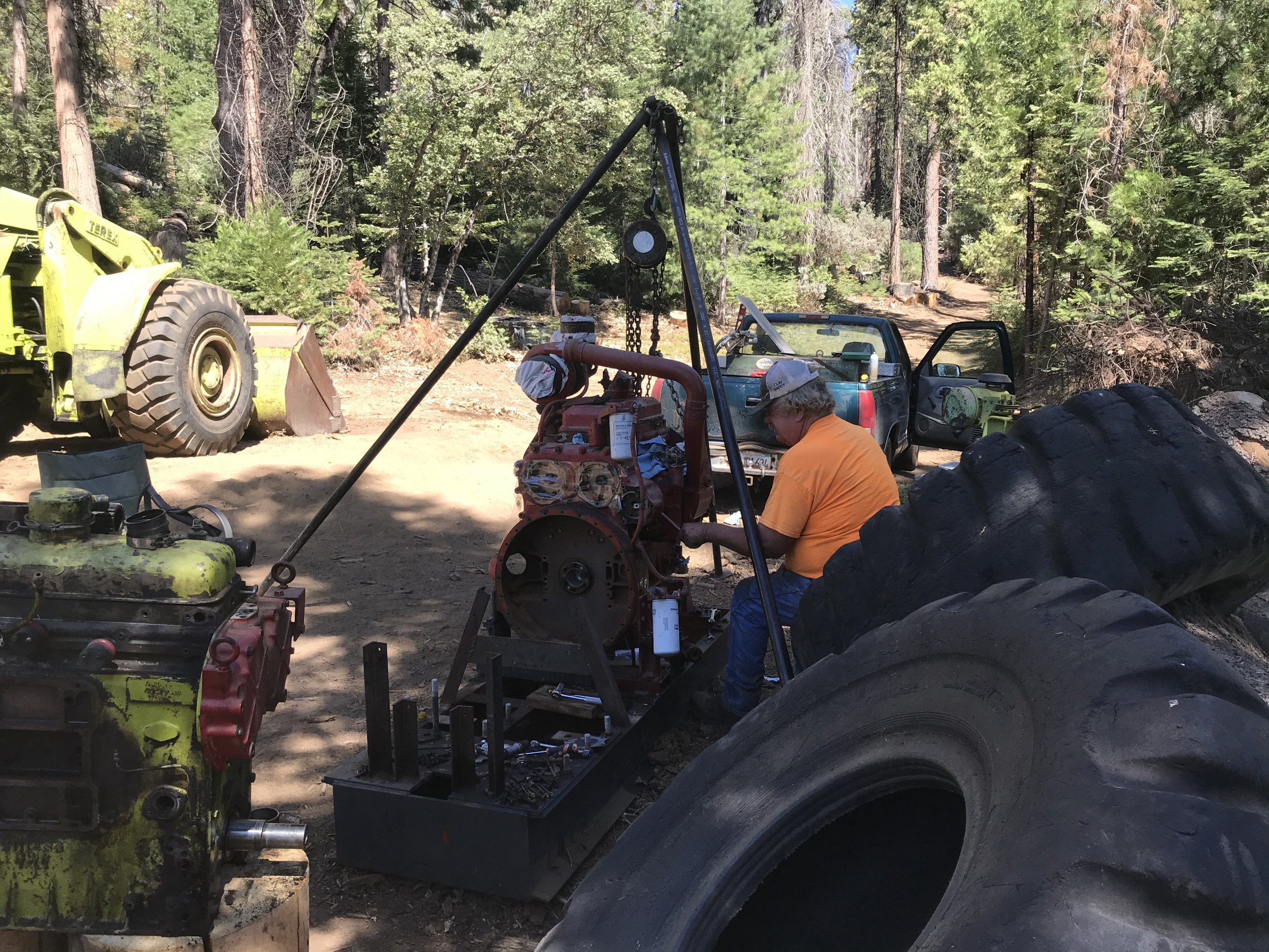

Maybe two more days and the engine will be ready to go back in.
Used a tripod and chain hoist to lift the engine and work on the bottom.
Got more bucket teeth installed.

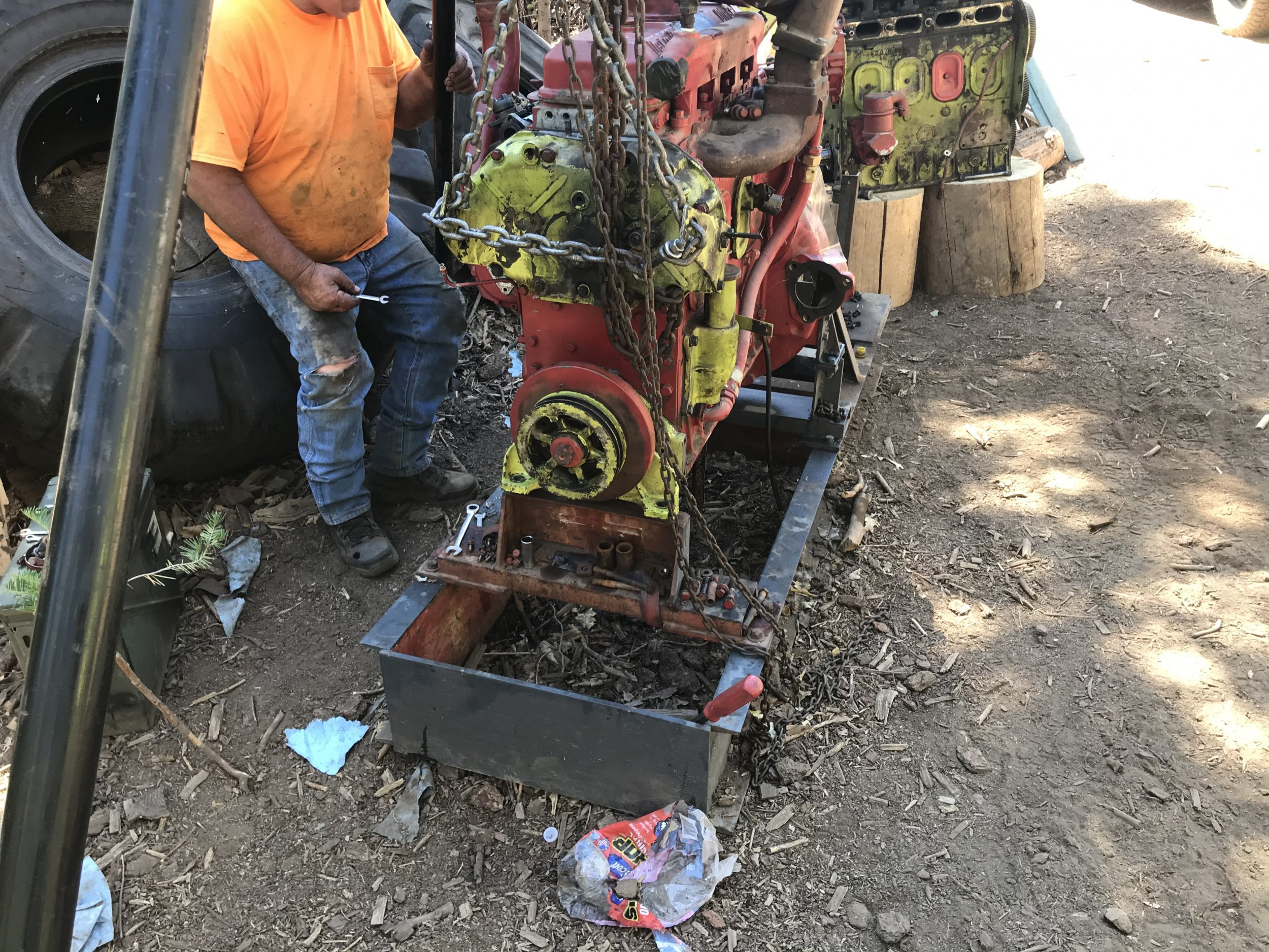

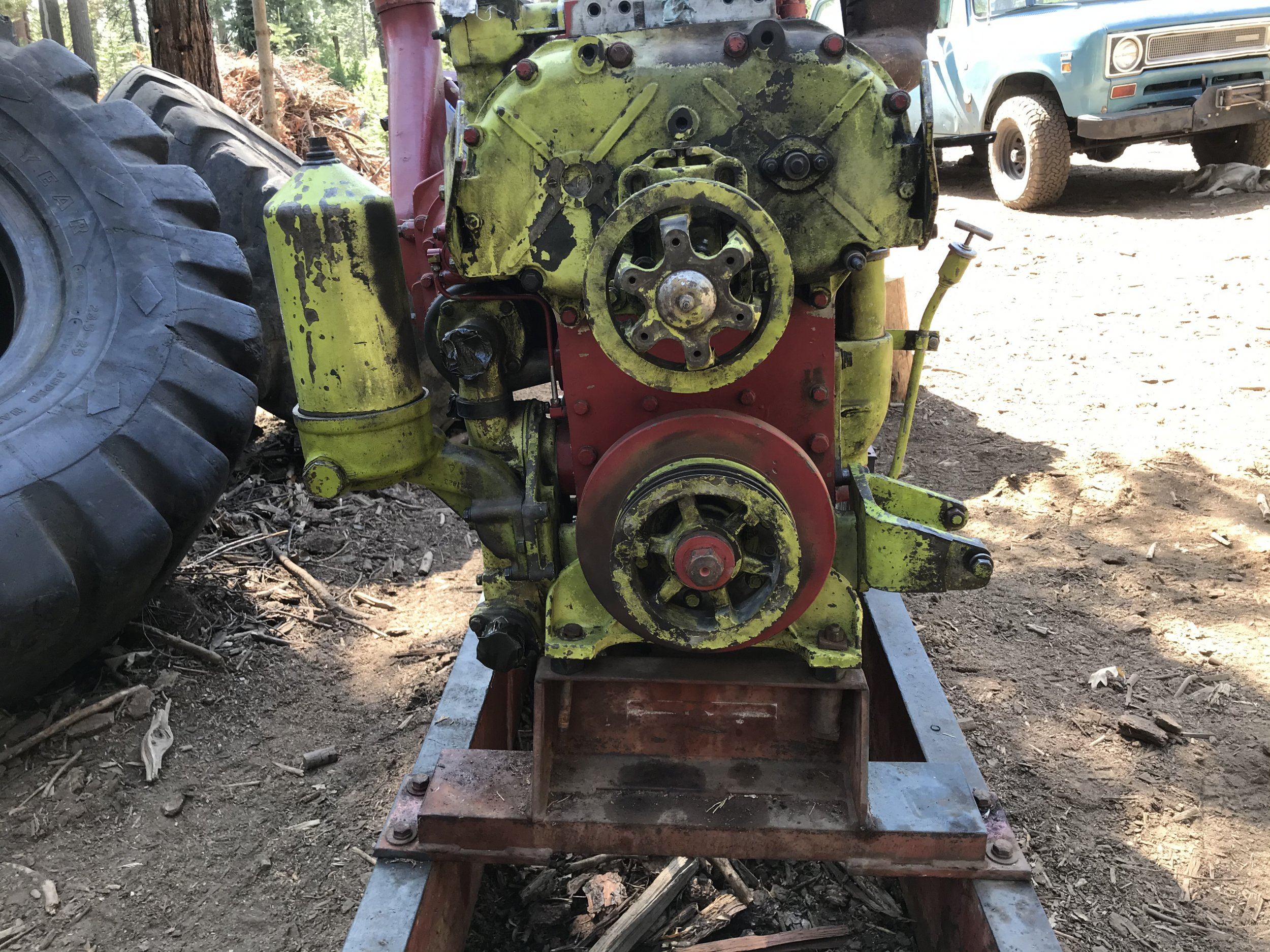

#509
He says it’s ready to go in.
We kept the original governor.
We have the one green part in the middle (blower drive gear) because the red one had an oil filler integrated into it. There was no room for it, plus it would be under the cab.
Block heater hidden up there.

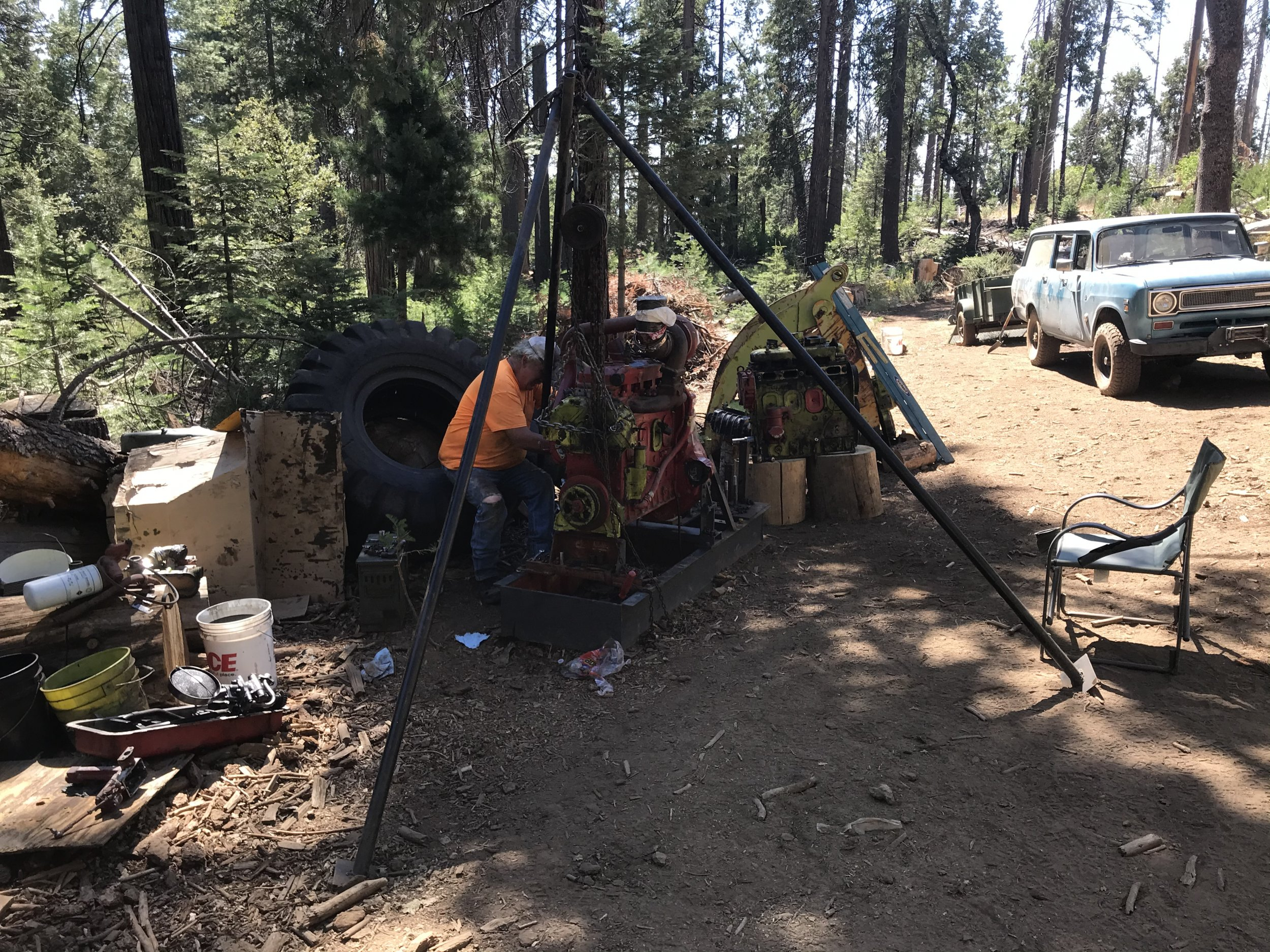

   / Ed's 77 Terex 72-41 Wheel Loader
#510
Got the dipstick tube mounted to the bracket coming off of the oil filler housing.
I taped off anything that was open after he left. Also cleaned up the mess, he left quite a mess. Emery Cloth and greasy shop towels mostly, and scraped off gaskets.
