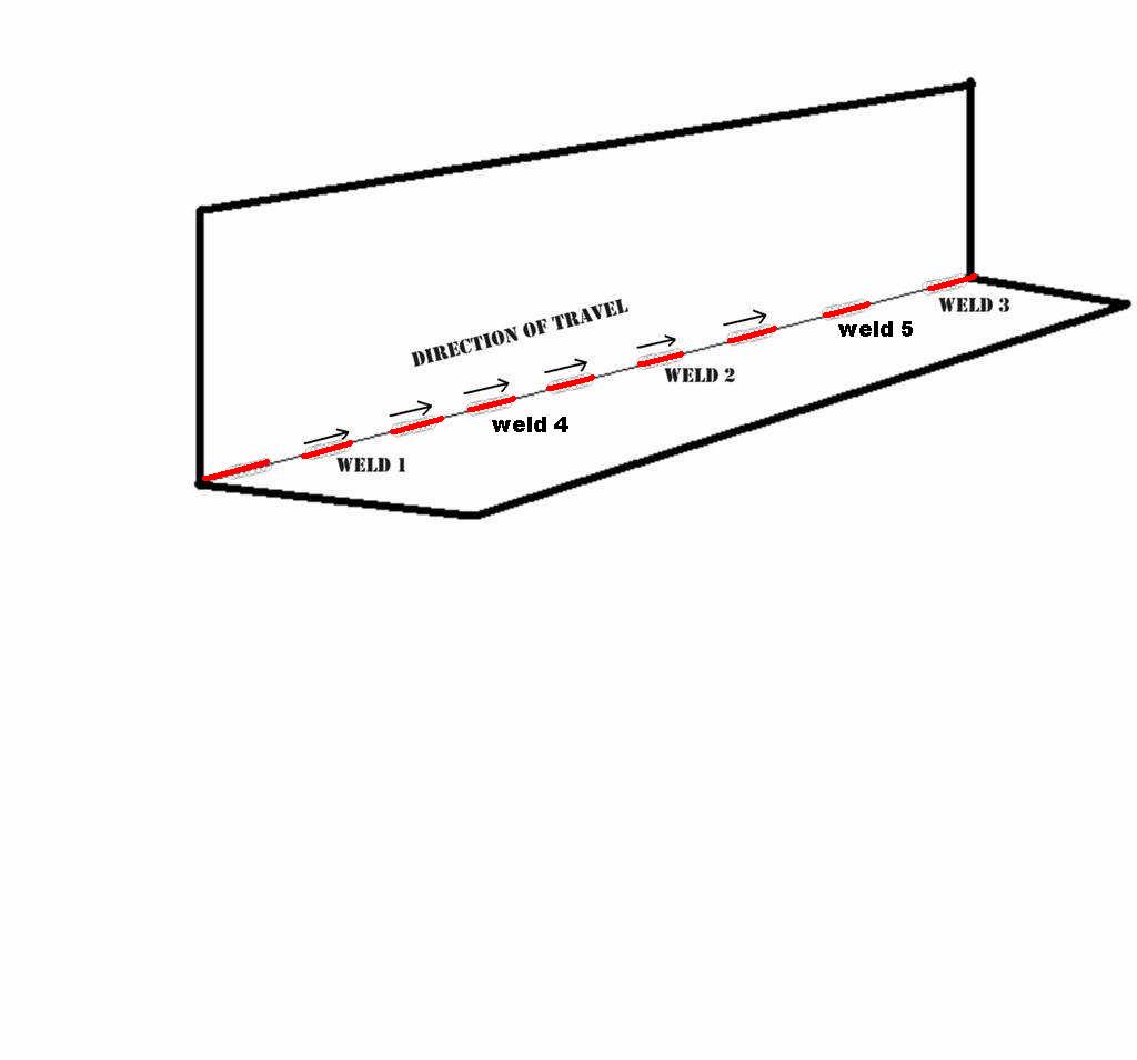

I want to stitch/skip weld the angle to the bucket so I don't warp anything.
I'm not an expert, but I suspect that you don't absolutely need to do a full seam weld all the way around the angle. That being said, if you did want to fully weld it up, backstepping would be one approach to use. When you backstep, you skip ahead 6" or so, then weld backwards toward your previous bead. This gives the beginning of your current bead extra time to cool down while you finish the bead and then set up the next bead. Backstepping is probably more effective with stick welding, where you have to chip slag and brush the weld before tying in another bead. With MIG, you could finish the bead and immediately go on to the next 6" section. Still, it'd probably make some difference.

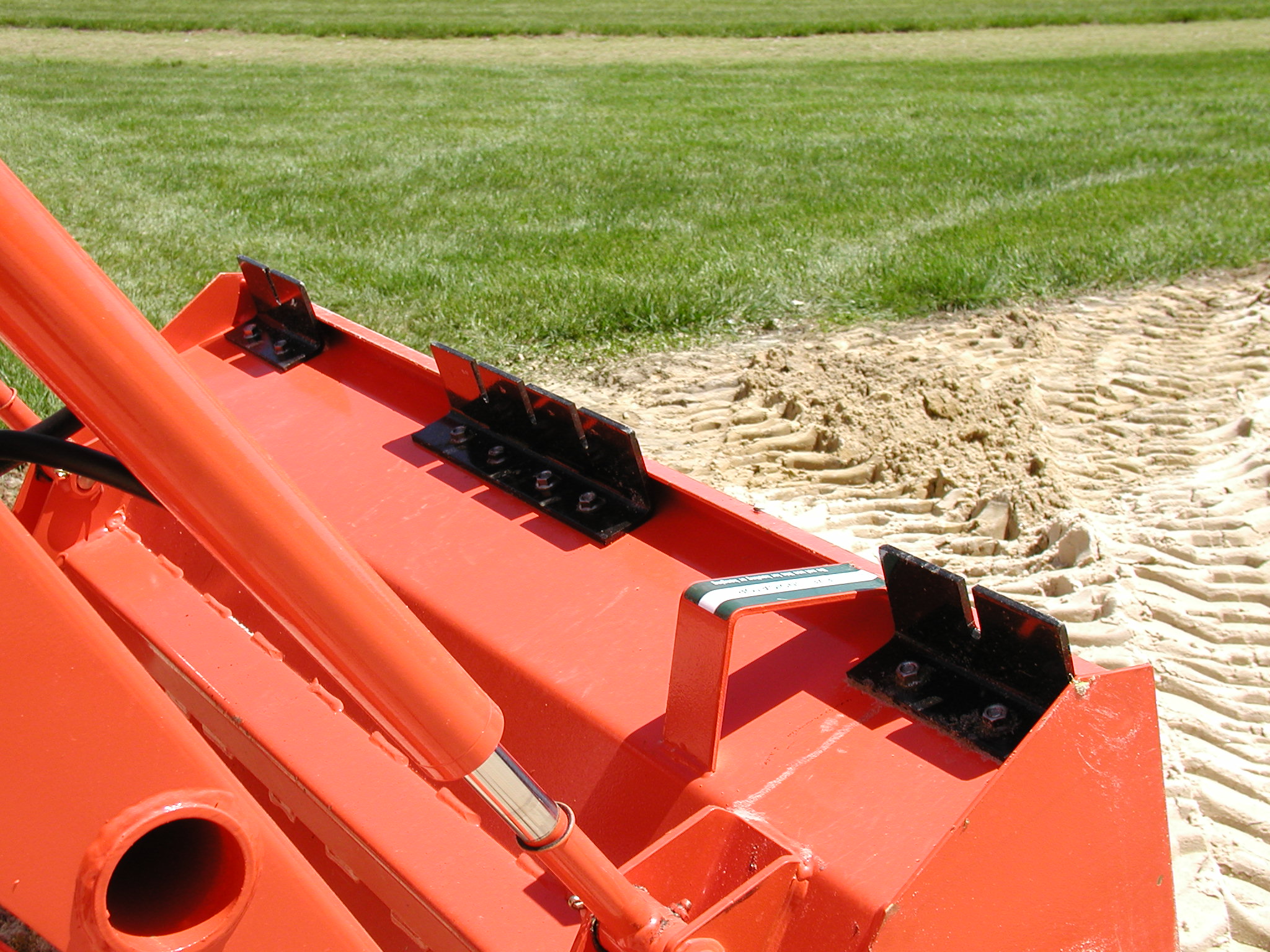

Here's a pic of the "hooks" I've used on two tractors. This is the bucket of the B7500 I had. The L3200 sports very similar angles. They work nice because all you need to do is drape the chain into the slots and they hold it at any link. If using a longer than needed chain, it's simple to drop the excess into the slots to keep ut out of the way
Great Idea. Wish I had thought about that before I welded hooks on.

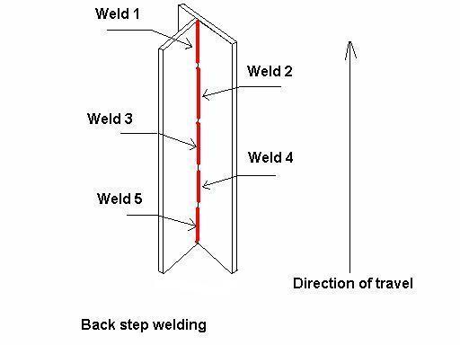

I'm not an expert either. But I've run a few beads in my life. I'm a big believer in back stepping, and skipping around. I'm not to bad with heat shrinking material around after it has warped, but back stepping and skipping around a lot can eliminate some warpage.

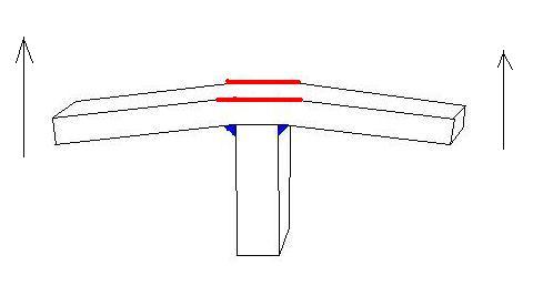

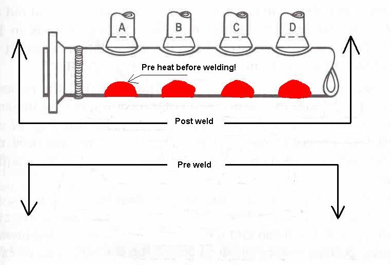

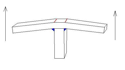

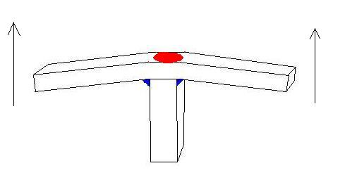

I've always found square & round tube, and pipe to be very reactive to heat. Here are some different techniques to correct warpage after welding. Sometimes you're better off to preheat before welding.;)

Thanks Carl! I found a good video on Youtube last night where preheating was discussed and demonstrated. Definitely something I'm going to keep in mind when I weld.
