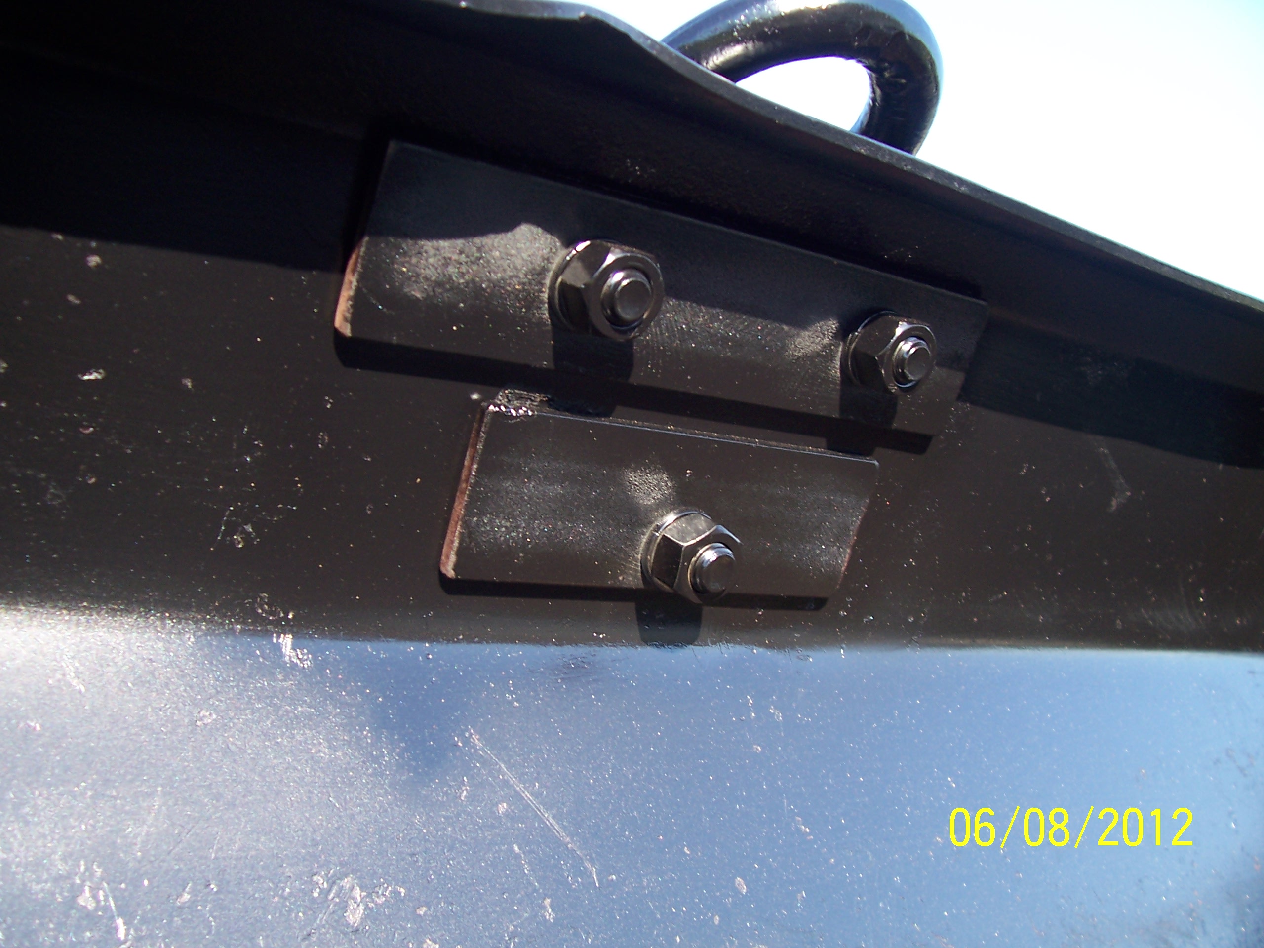

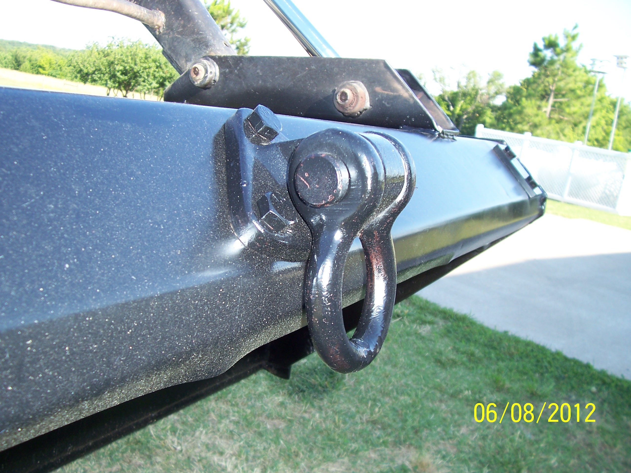

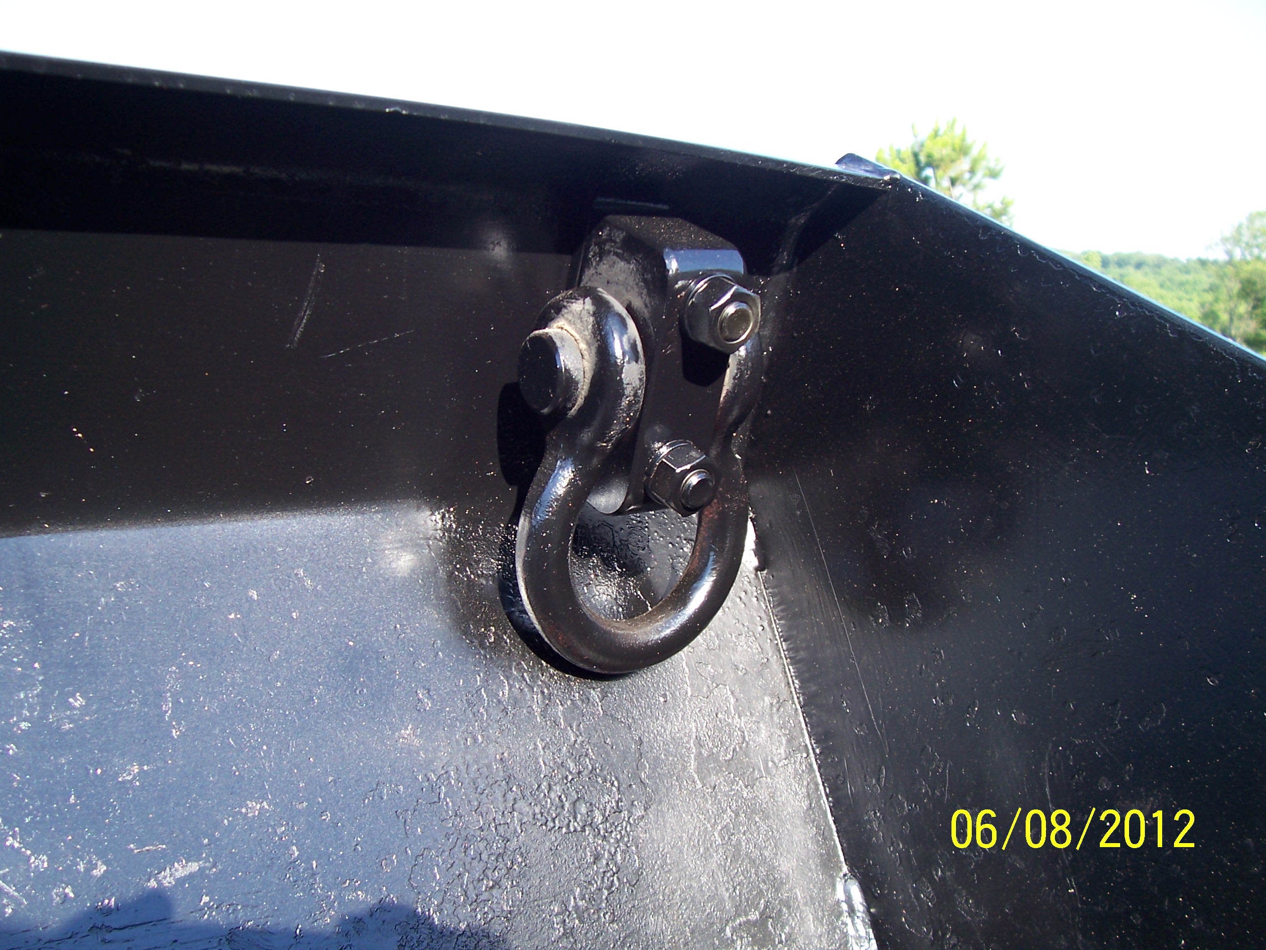

I lift with steel cables/chain and straps depending on whats needed. Thats why I like the bolted on 11k lb - 15k lb D rings On my bucket. If I trade tractors these lifting rings stay with me. They were free as the company I worked for was excessing several heavy 30' bond jigs. We were allowed to take all the lifting rings we wanted. Mine are bolted on with 5/8 grade #5 bolts and nuts and 1/4" backing plates to keep from bending the bucket behind the D ring.
