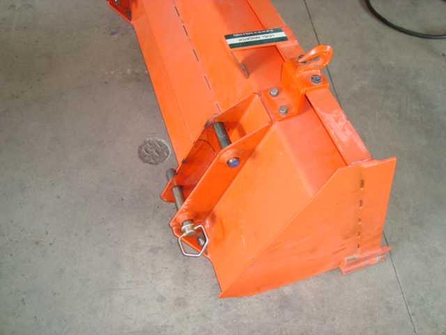

I really didnt want to weld on my new bucket so I made mine bolt on. Just another idea to play around with.
Steve
This looks to be one of the better bolt on hooks I have seen, lots of strength in that double angle and double point bolting.
As for plug welds, you don't need them for the angle iron attachment, Skip welding each edge is sufficient. I attached my chain hooks using just a 4" x 6"x 1/4" plate that was purposefully built for attaching the leaf springs to a trailer axle and it had some holes about 1/2" in diameter that I plug welded prior to attaching my hooks. I did this partially for strength but mainly so the plate hole wouldn't get water under it and freeze or just rust the bucket. I filled the holes flush then welded the hooks over it. If I had had some flat plate, I wouldn't have made holes for any plug welds but since I had to use what I could find, those leaf spring plates were just the right size to fit the top of my LS FEL bucket.

I've got the same bucket on my B3300SU. Have you thought about using a piece of 2.5" x 2.5" square to reinforce? It will fit perfectly inside the original lip, stitch weld it on add your hooks and be done. It will be easy to add, easy to remove if you ever wanted to (don't know why you would but was a good comment on the plug welds). It's clean and neat and does the whole bucket. Adding the whole length right away will allow future addition of other hooks etc if you want. It will also eliminate hooking anywhere other than the proper hooks.
Sometimes bending will come from things other than lifting a load. I was moving my empty 6x12 landscape trailer by hooking the safety chains on the lip, bound up against the hitch on a turn and bent the top edge. Lift was no more than a couple hundred pounds.

Thanks all....I'll deep six the plug weld idea. It was just something I started thinking about as I only want to do this once so I want to do it right.
CDN Farm Boy, thanks...I didn't think of a 2.5X2.5 for inside the lip. I may have to take a run back to my steel guy and see what he's got in stock.

I did not read all 57 posts so this might have been already mentioned. If so, sorry. But just to be on the safe side, I would suggest you remove the bucket from the tractor before you weld on it. With all the electronics used today, you run the risk of burning out some componet. That could cost you big $'s. I welded a piece of 3" chanel iron on top of my bucket and welded hooks to that. So far no problems.

Thanks, nobody else mentioned it but it was something I was concerned about. I've got the Kubota Quick Attach on the bucket so I had planned on dropping the bucket and doing all the welding on it while it's unattached.

Good idea to deep six the plug welds. Not needed.
Bad idea to use the 2.5x2.5. It will just add a lot of weight you don't need. Stick to the original idea. I would also run the angle full length/width.
