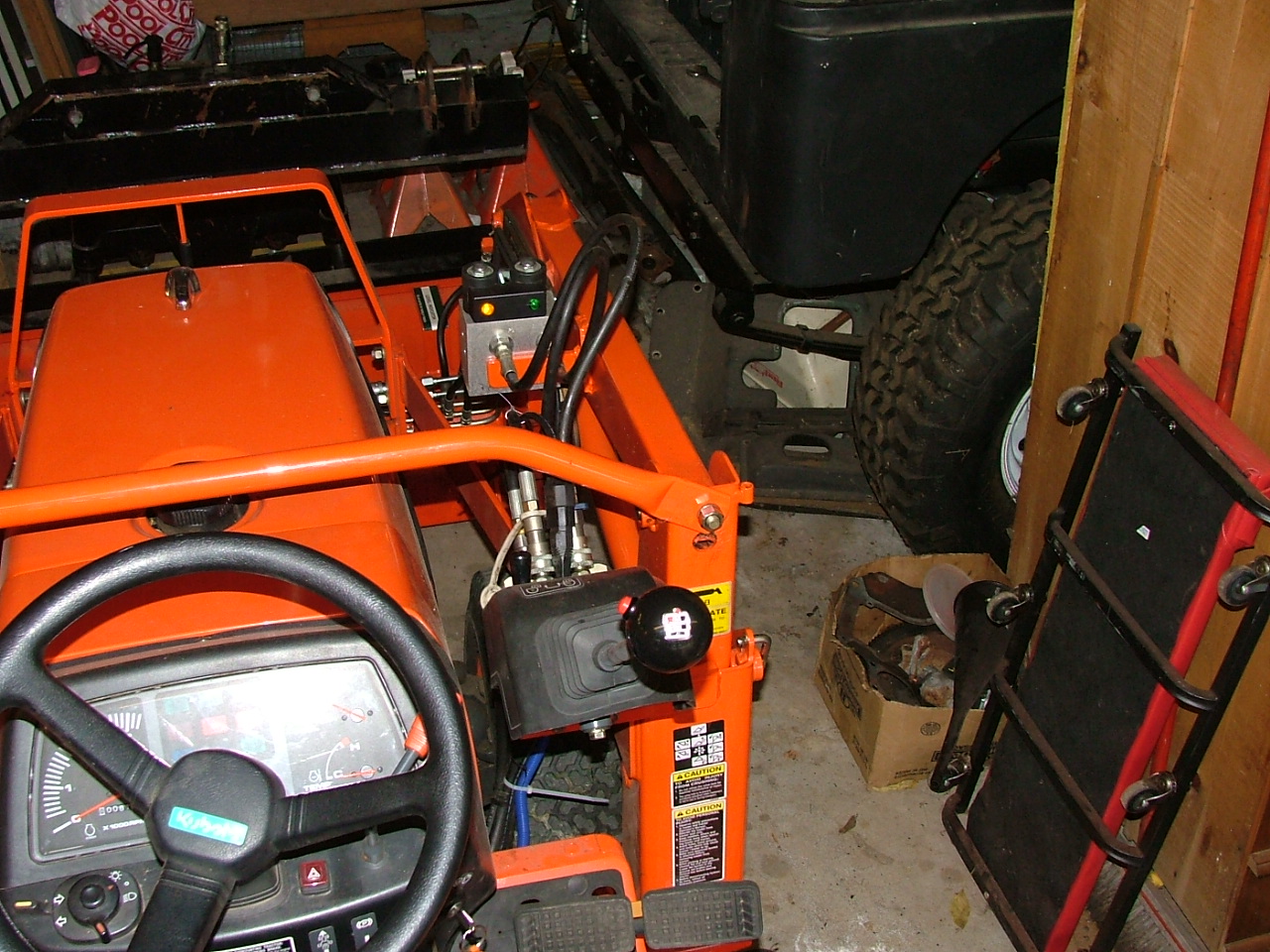

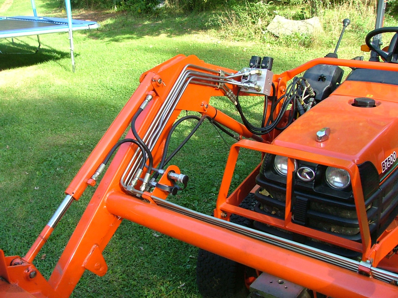

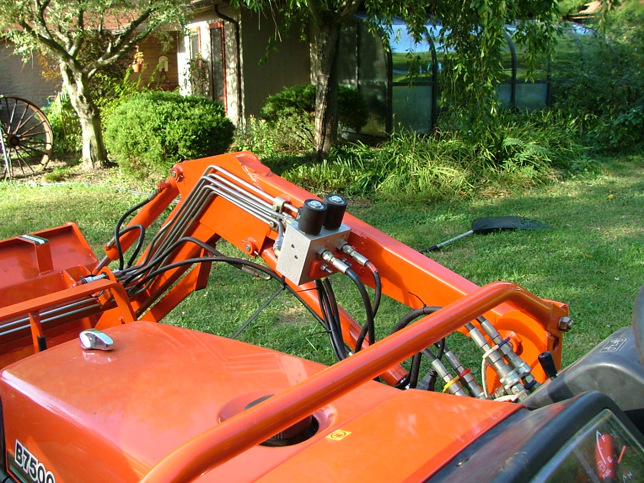

Some pictures of the diverter mounted and plumbed..
