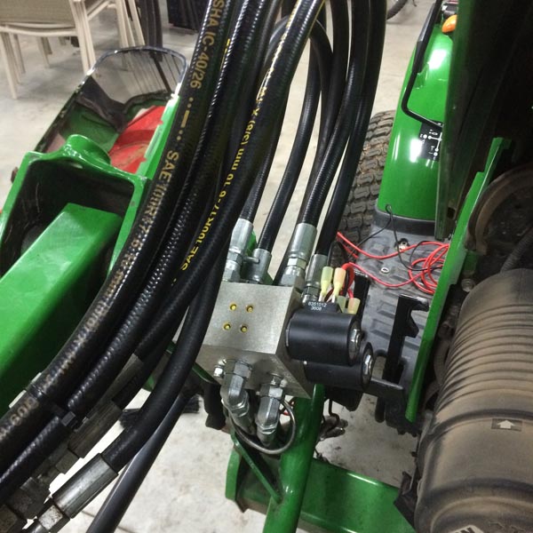

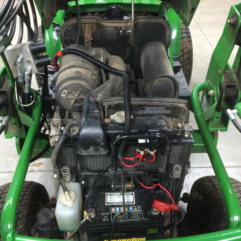

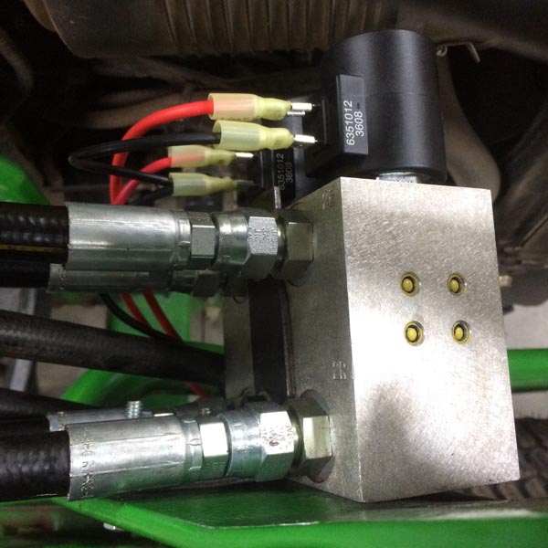

Some pictures of the diverter mounted and plumbed..

I have the non - A diverter which requires power all the time, if I wired it like that it would be drawing power. We put in another relay that triggers the diverter relay, temporally we wired in a switch on the joystick. Everything was working great when we finished up late last night, all I left to do is button up some of the wiring paths and add some more hydraulic fluid.
